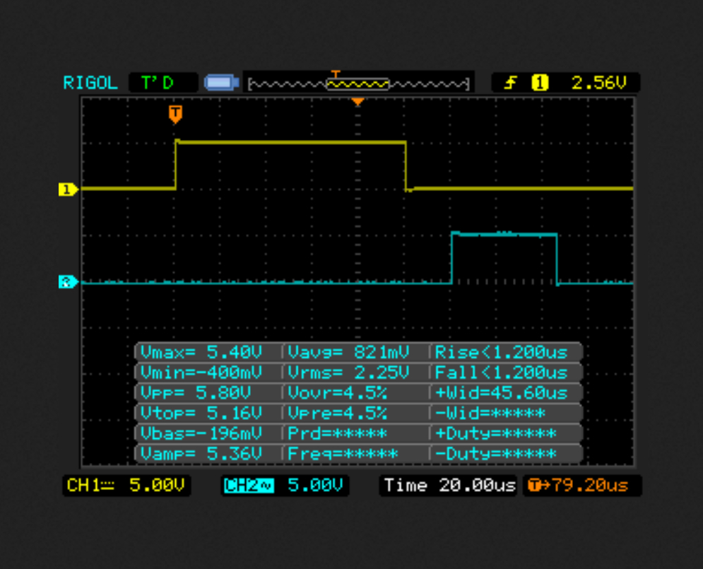

      Here's the code with the delayMicroseconds()
      Code:
      void do_isr()
        unsigned long now = 0;
        unsigned long then = 0;
        if (in_long_isr)
          return;
        in_long_isr = true;
        PINC = 0x01;
        for(int i = 0; i < TX_PULSE; i++)
          __asm__("nop\n\tnop\n\tnop\n\tnop\n\tnop\n\t");
          __asm__("nop\n\tnop\n\tnop\n\t");
        PINC = 0x01;
        for(int i = 0; i < PULSE_1_DELAY; i++)
        PINC = 0x02;
        for(int i = 0; i < PULSE_1; i++)
          __asm__("nop\n\tnop\n\t");
        PINC = 0x02;
        PINC = 0x04;
        for(int i = 0; i < PULSE_2; i++)
        PINC = 0x04;
        in_long_isr = false;
      Works just like before....
      TX pulse = 100.0uS
      Sample Pulse 1 = 45.60us
      Sample Pulse 2 = 45.60uS
      Frequency = 641.0 Hz
