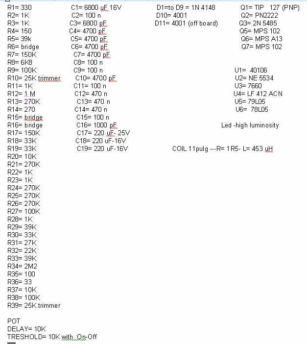

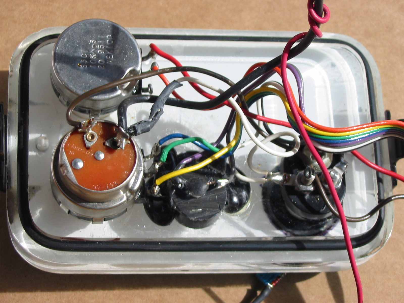

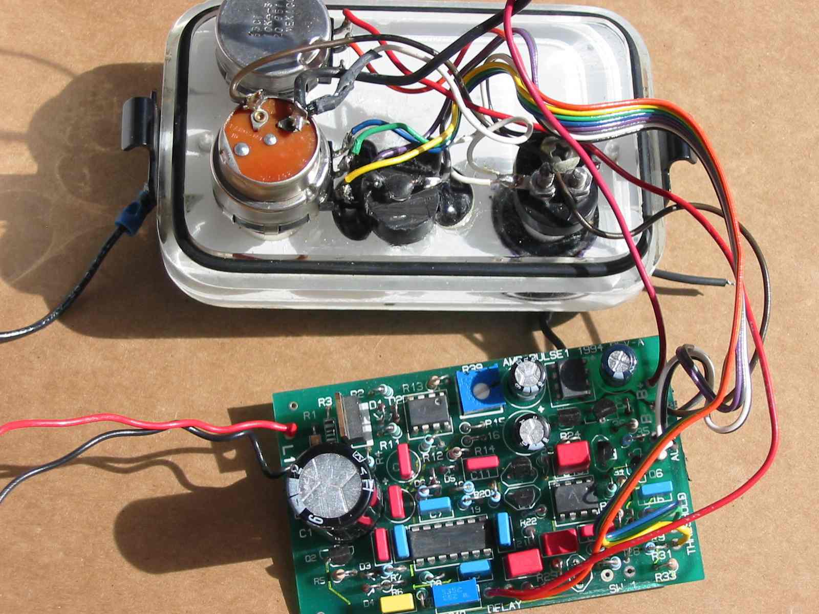

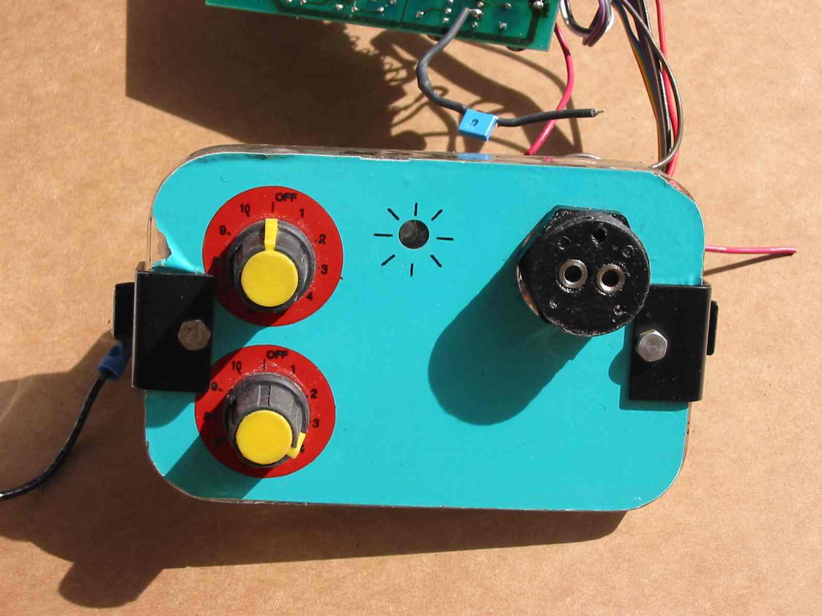

Hello ,this is my aportation for this 2011 year for all my friends of the Geotech Forum...

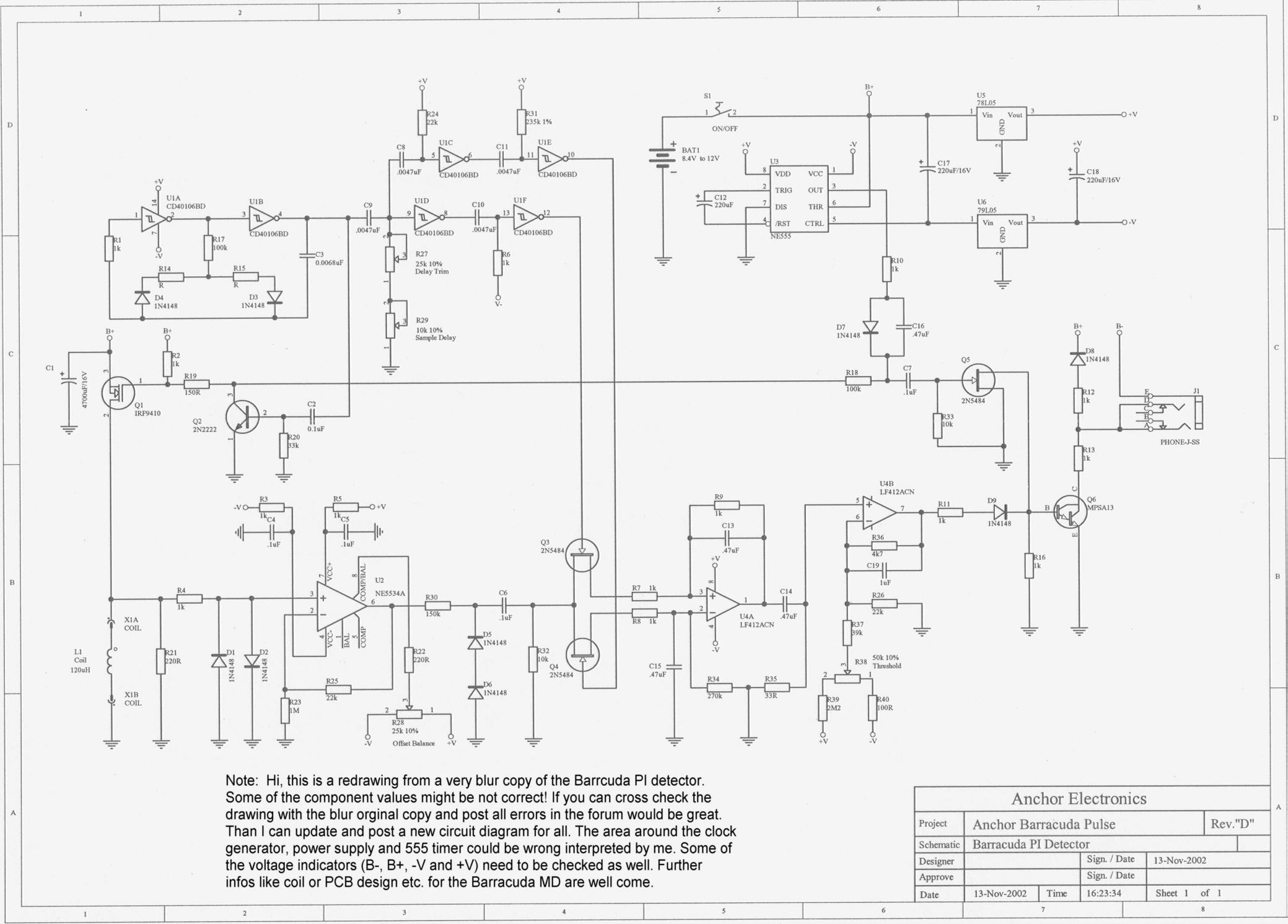

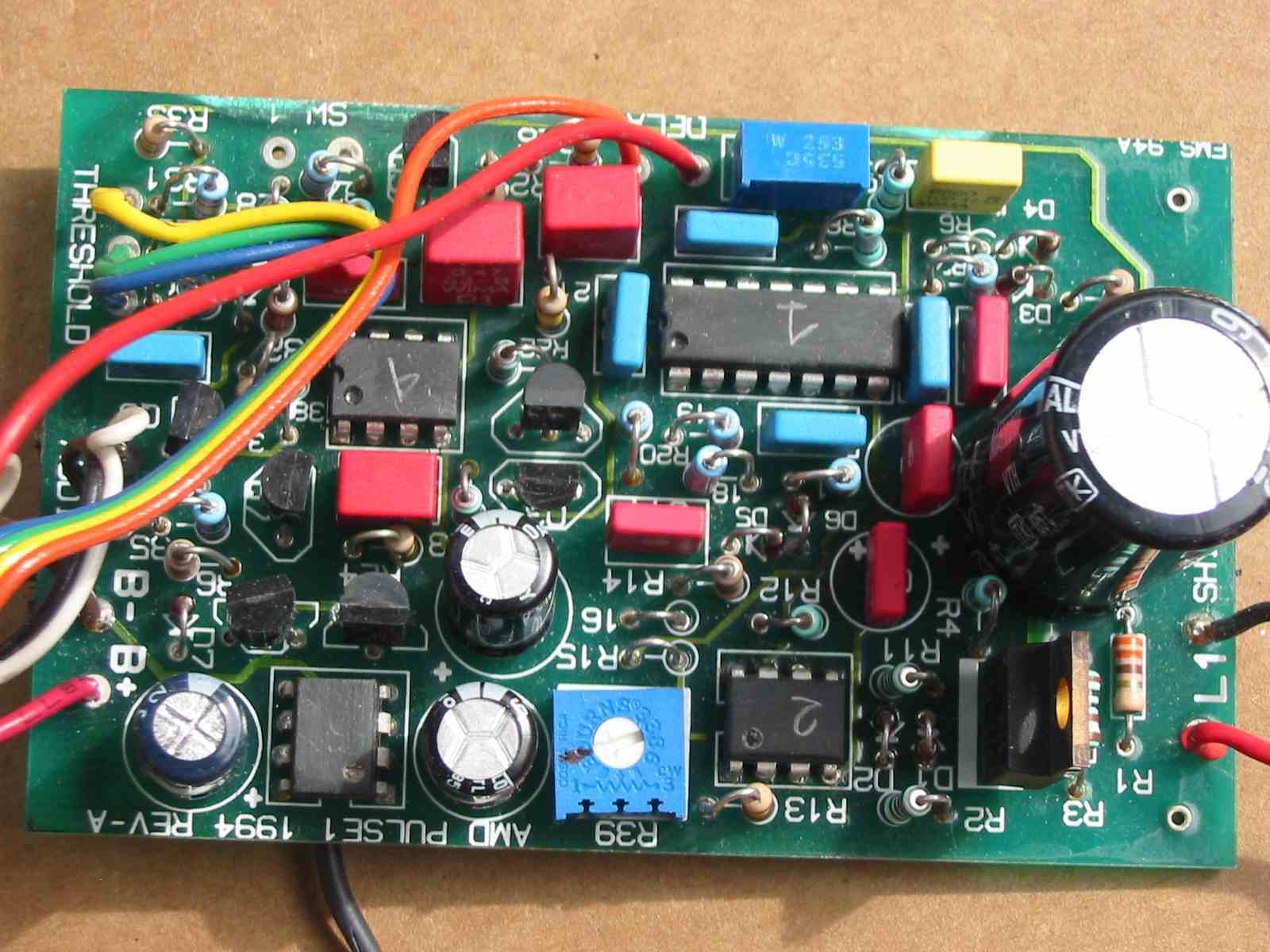

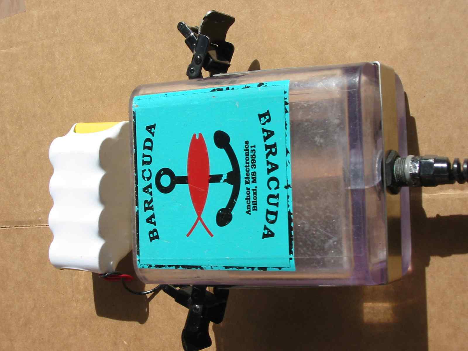

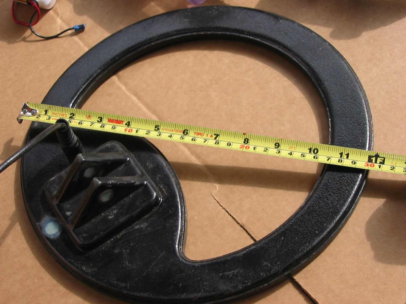

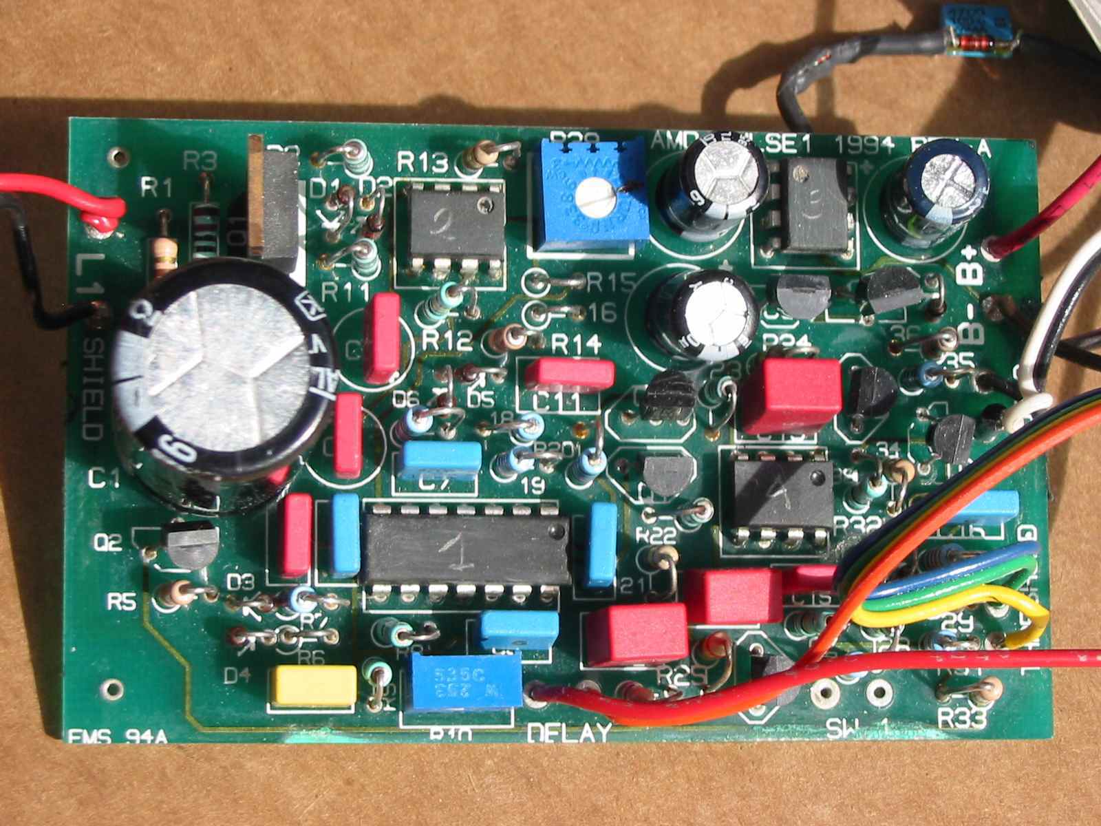

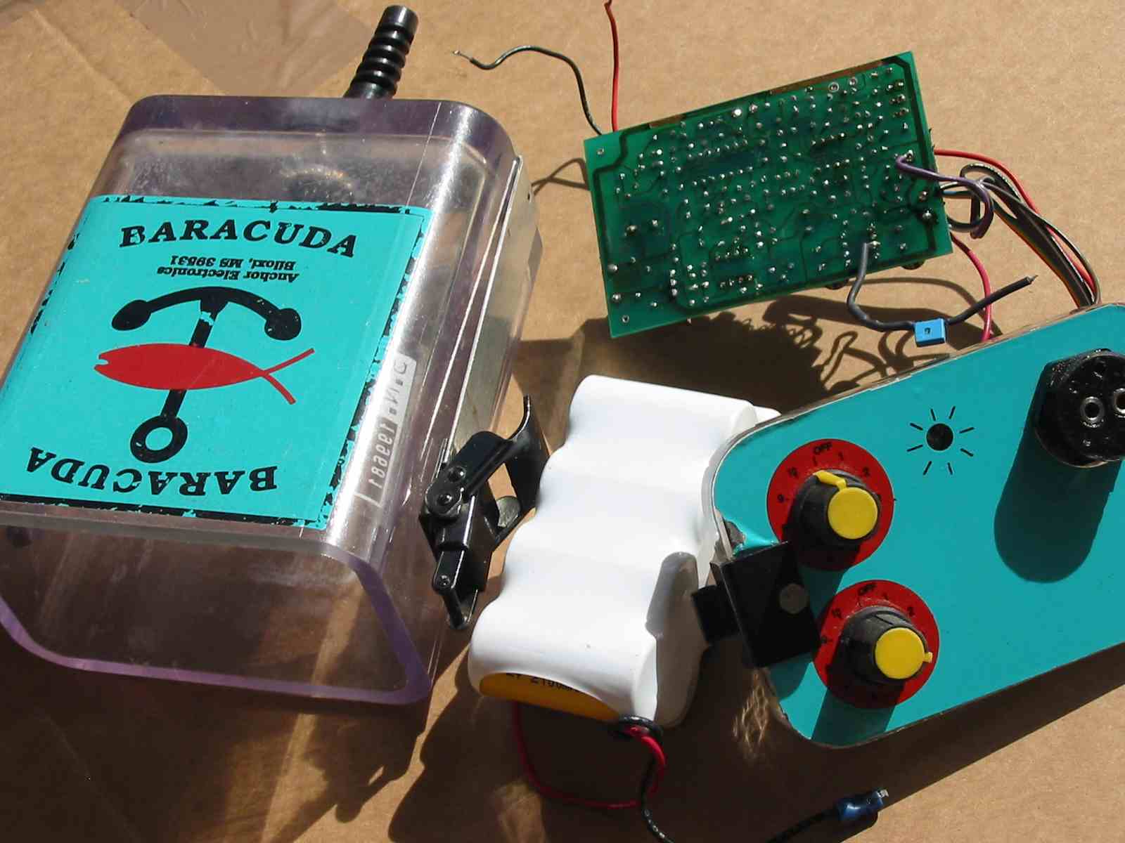

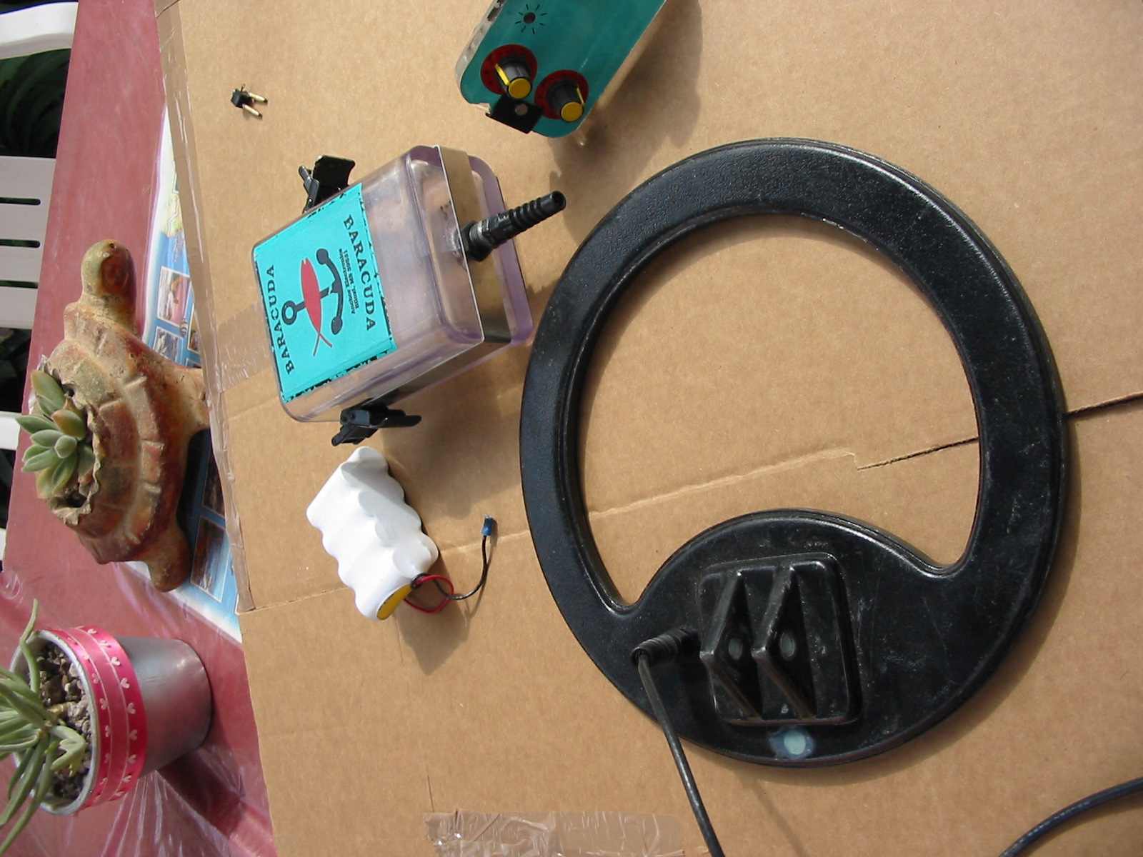

It is about the legendary BARACUDA...yes i have bought with a good LUCK a 2 hand old model from 1994 ...i test it very nice ...detect in air= alum.coca can at 65 cm very well and gold ring (20mm) at 26cm with 11pulg coil diameter.....NOT BAD !!!! ...nice Audio" also unique" in comparaision with another detector....

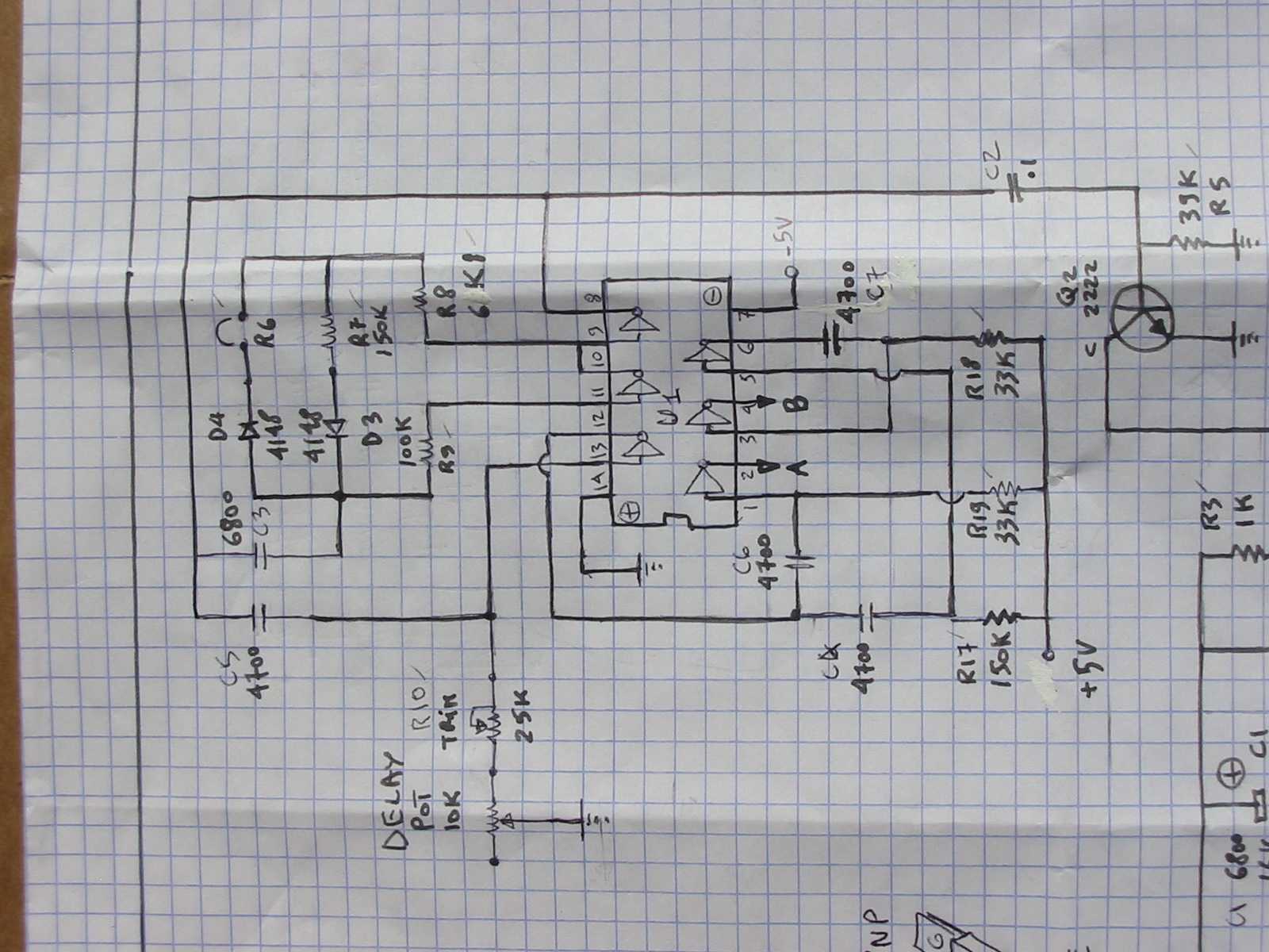

General spec mesured by me

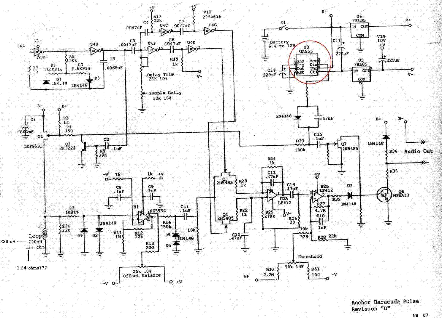

-transmiter pulse Fcy= 640 PPS
-Transmitter pulse width= 100 uS (microseconds)
-pulse delay =begin at 22 uS to 60 uS .
-Position knob Delay 1= 22 uS, position 4 =40 uS, Position 9 = 60uS
-sample pulse window 45 uS
Current consumption - 100Ma at 10,5V

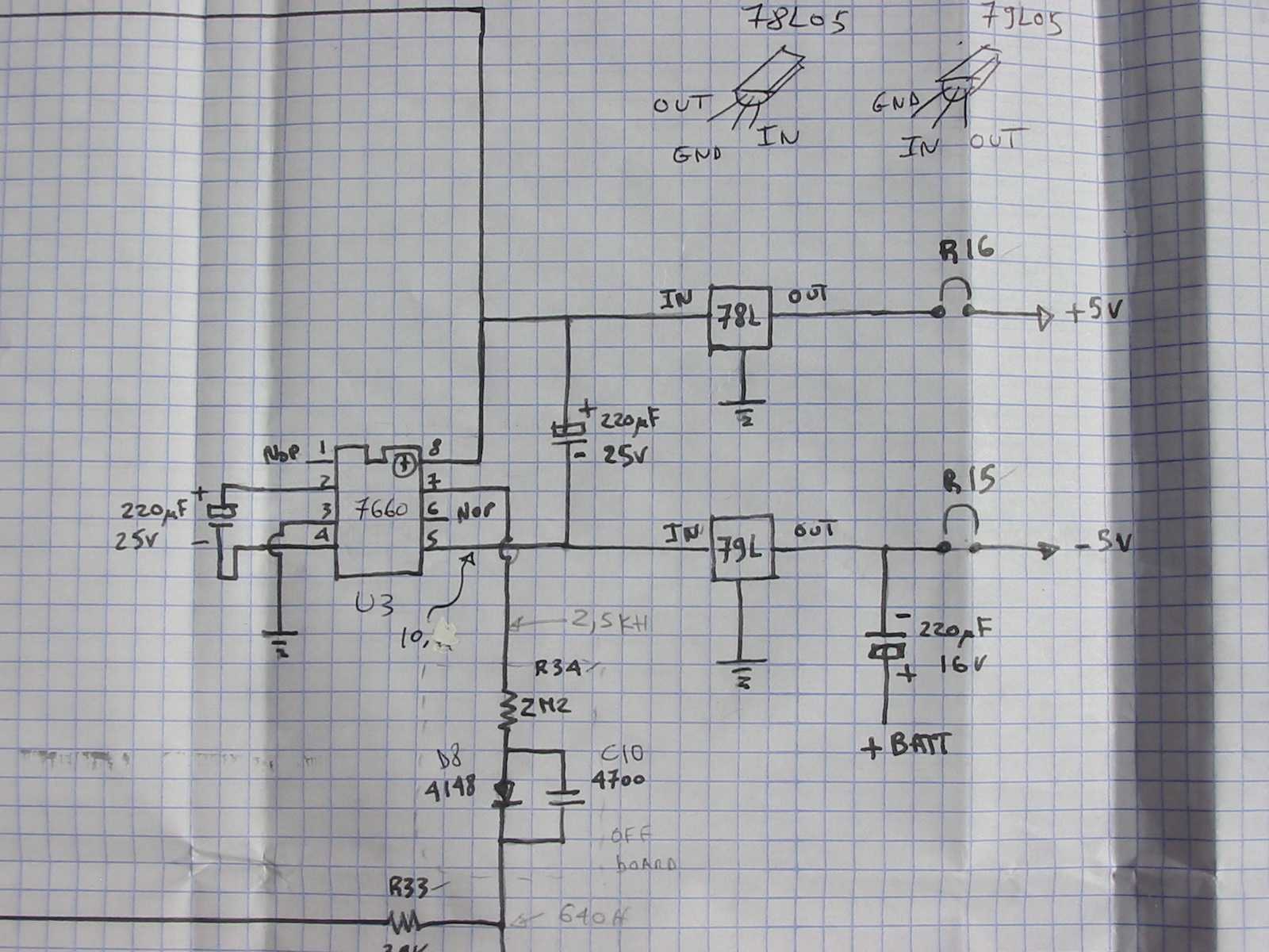

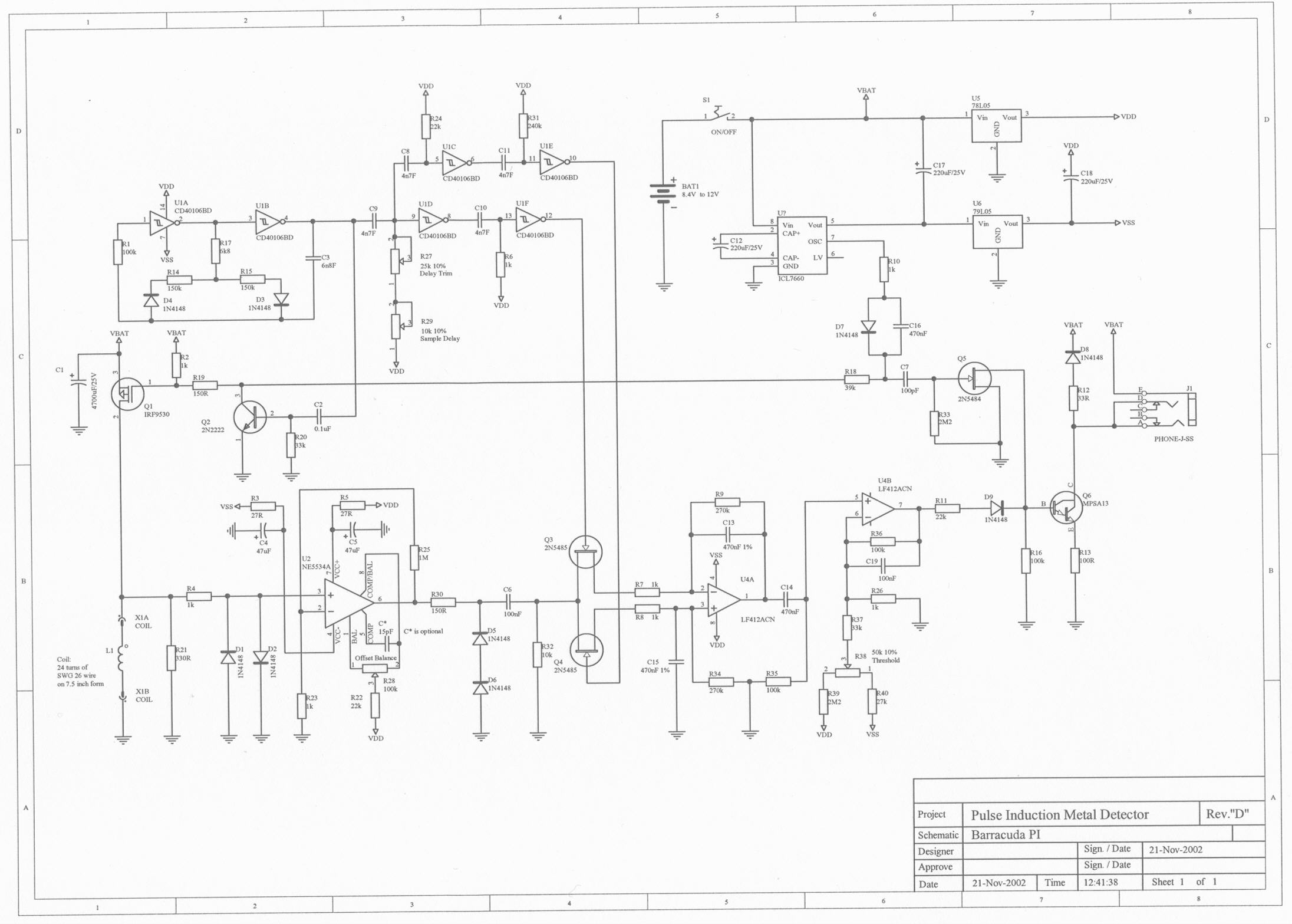

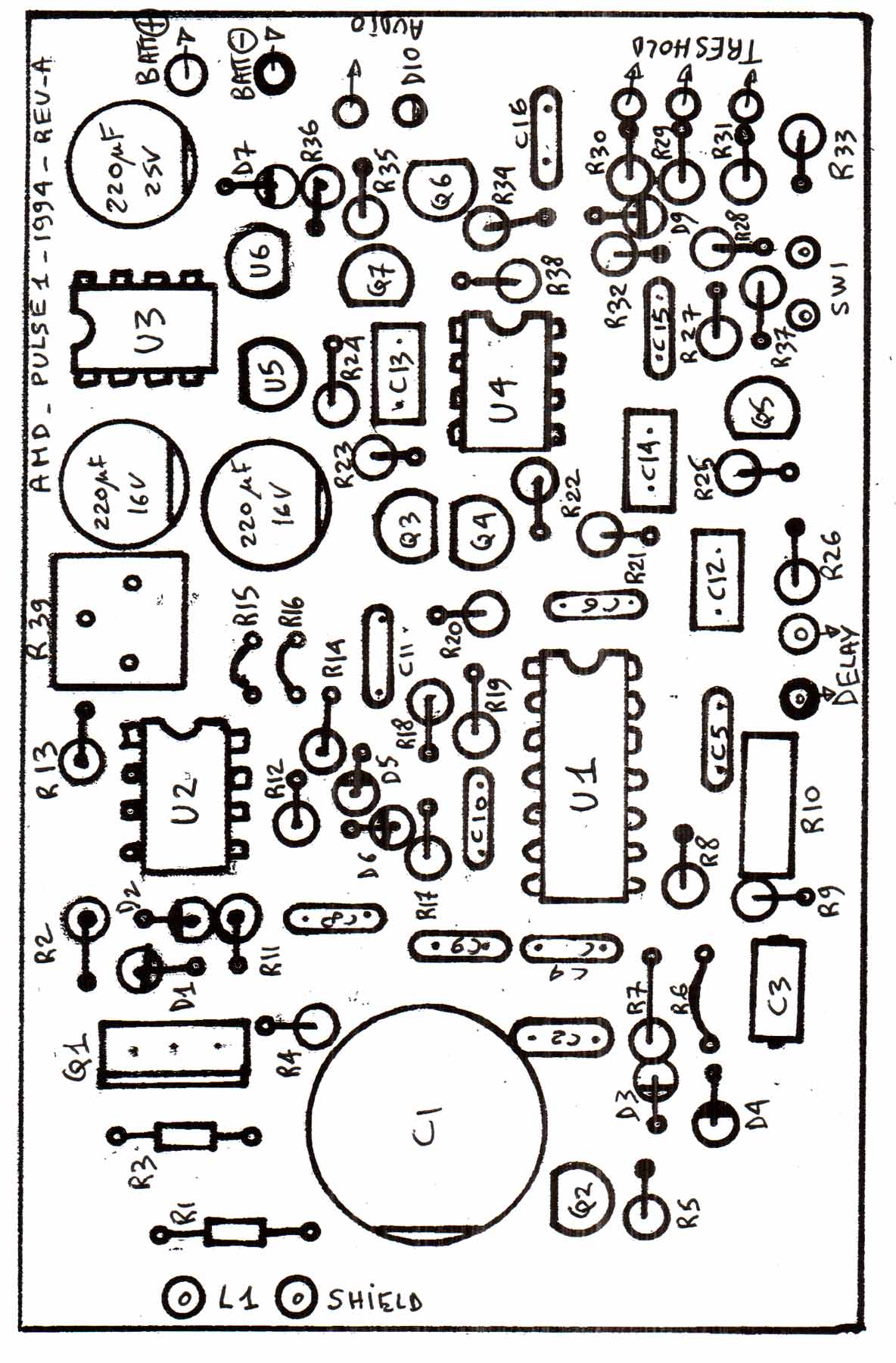

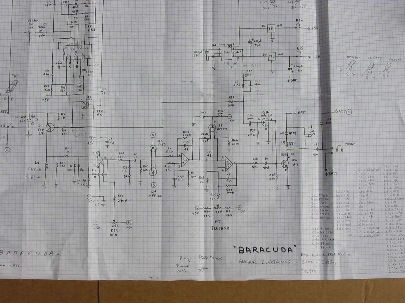

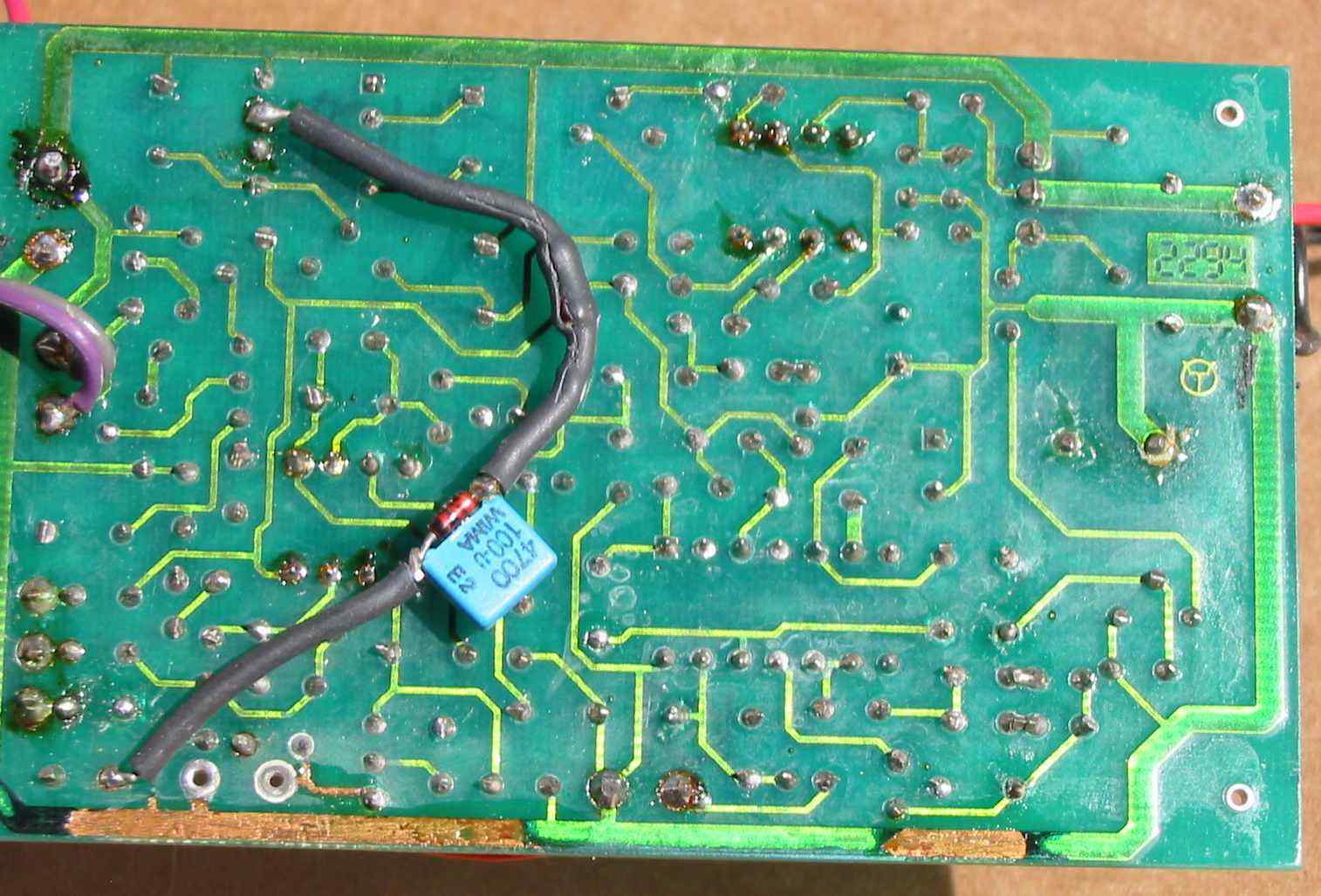

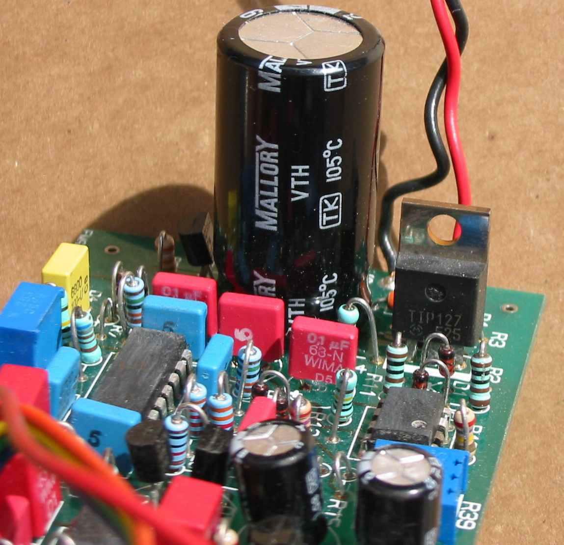

I have reverse eng the schematic ...VERY EFICIENT and a beauty design for this particular pulse detector.... bravo Baracuda !!!!

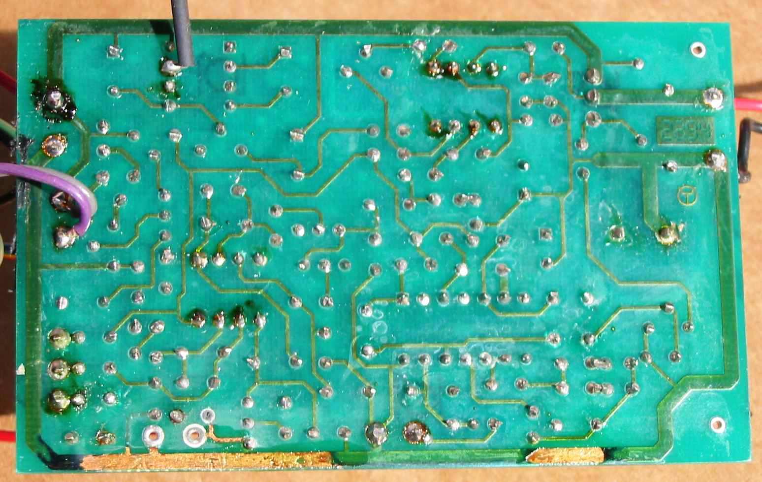

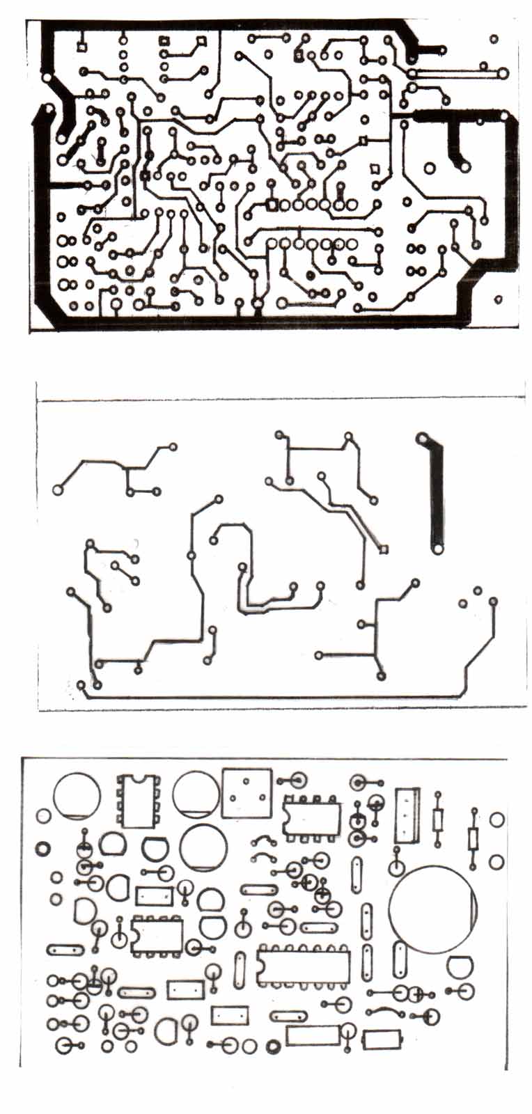

at continuacion i will put some photos i do not remenber to send a compressed archive but if friend like Quiozy can make it ...better
have fun,
Alexis
