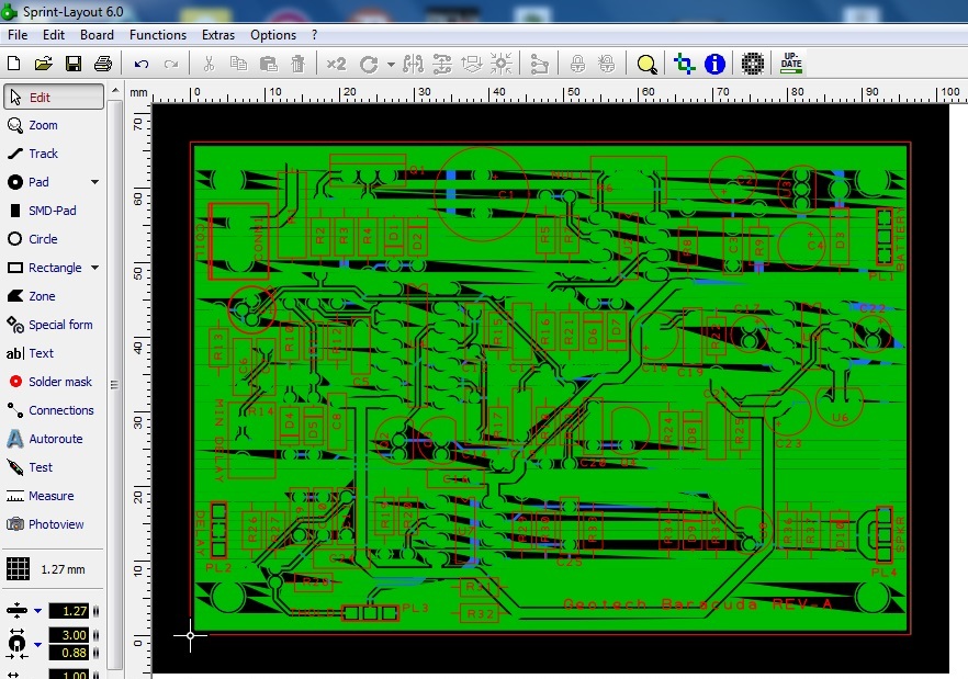

        • Hello. Does anyone have geotech barracuda pcb in pdf format ? I could not convert gerber file to pdf. I think there is a problem with the Gerber file

                    • When I enter the Gerber file into Sprint Layout, it shows this image

                        Thanks, I have Sprint Layout software. I use it, but when I enter the new Geotech Baracuda - REV-A Gerber file into the software, it gives me a blurry image like this one .do You have the sprint layout file of new Geotech Baracuda - REV-A., load it here?Click image for larger version

                              • Originally posted by arlim View Post
                                Thanks, I have Sprint Layout software. I use it, but when I enter the new Geotech Baracuda - REV-A Gerber file into the software, it gives me a blurry image like this one .do You have the sprint layout file of new Geotech Baracuda - REV-A., load it here?[ATTACH]57877[/ATTACH]
                                There is nothing wrong with the Gerber files for the Geotech Baracuda. You must have some setting wrong in Sprint Layout when you loaded the files.
                                Kicad is also able to import the Gerber files and create a PCB. From there you can plot the files as PDF.
                                If you're planning to make the PCB yourself using nasty chemicals, then please aware that the design is double-sided with plated-through holes.
