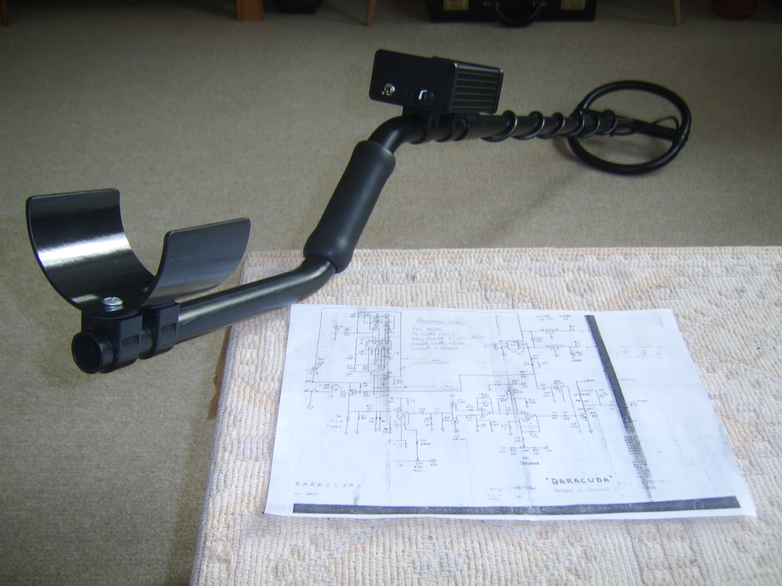

    • modified to be very cheap and and easy to rebuild
      hello new coil fits good to stem
      works great very lightweight
      • That looks awesome bernte_one!!!
        Better than a bought one
        Where did you get the fittings to allow it to be telescopic?
        Could you please describe the parts you used for the upper and lower shafts and the handle.

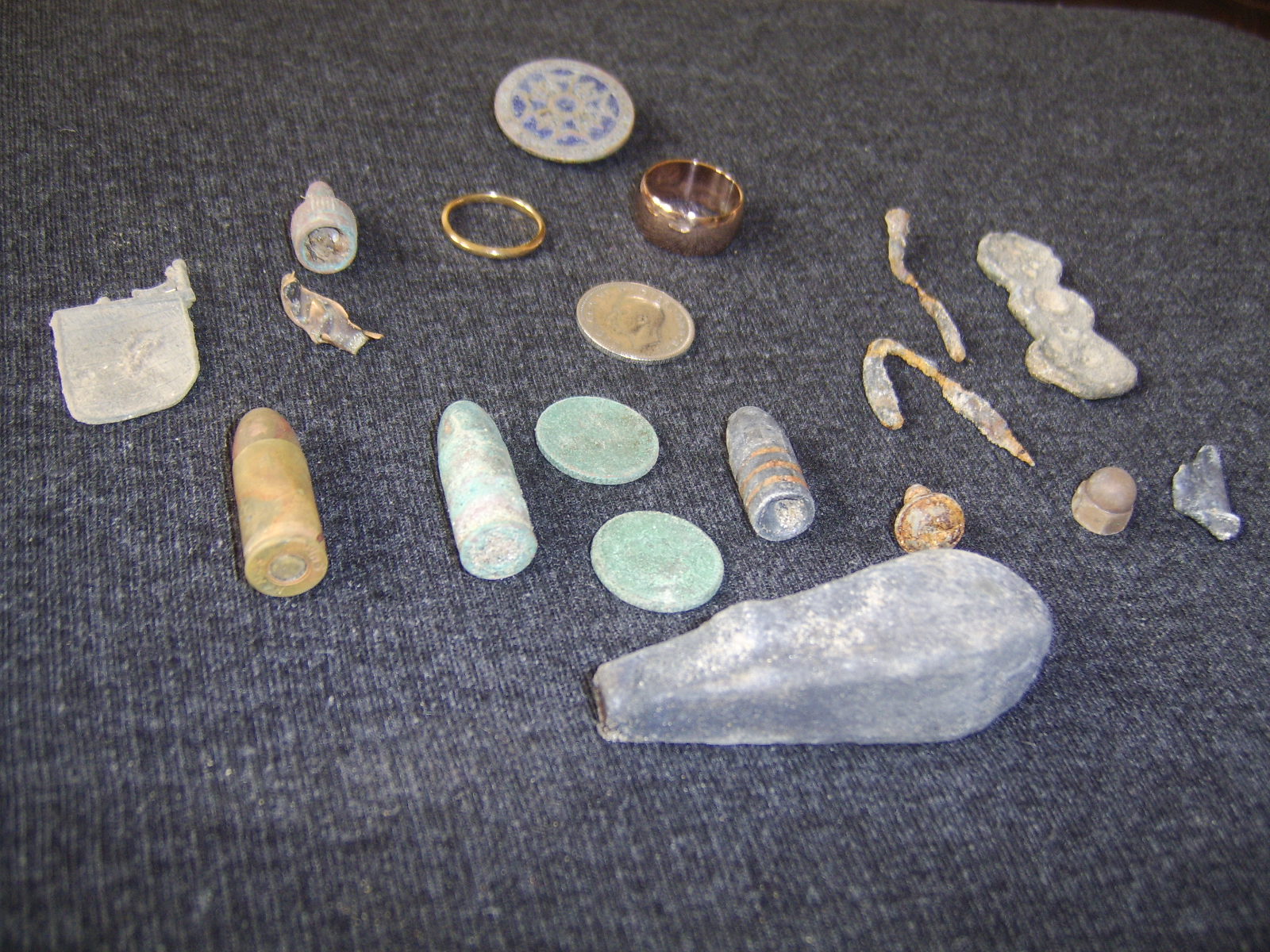

              • Hi folks,
                I've finally finished my Barracuda - at last!
                Took her for a little test at the beach a couple of days ago and had the best of luck (seriously jammy some might say!). Switched her on and within one or two sweeps I got a nice loud clear signal, dug it up and it turned out to be a lovely old rose gold ring weighing 6 gramms. It has a date letter 'g' which indicates it was made in 1906. After walking back up the beach to show my mate the ring I went back to the same spot and the same thing happend again - two or three sweeps and out pops another gold ring! The second was smaller though and is not marked. Carried on detecting for about another hour and also bagged a 1943 sixpence, a badge and some ammo. All of which can be seen in the photo below.
                The Barracuda is a sweet little machine, I really like it, but the 2 gold rings coming out immediately was obviously a fluke. I was just lucky to hit the part of the beach that had been eroded.
                Regards, Jim.

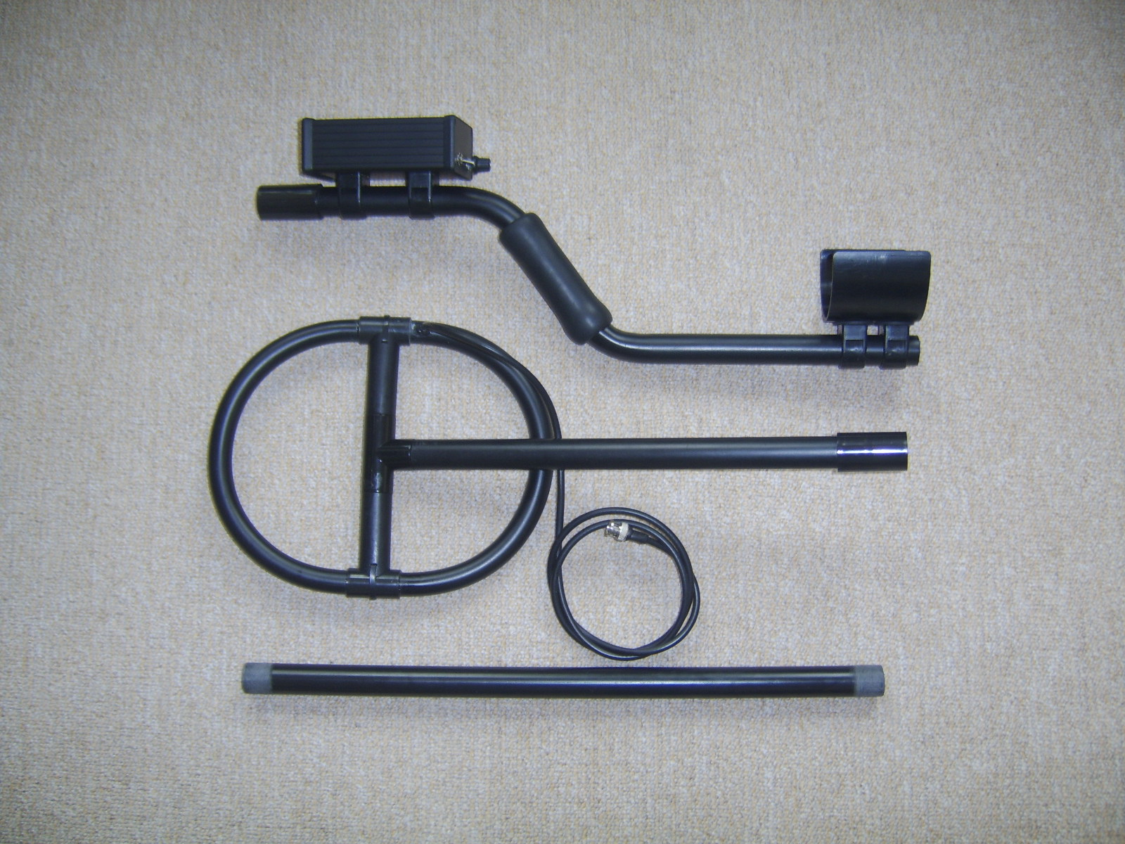

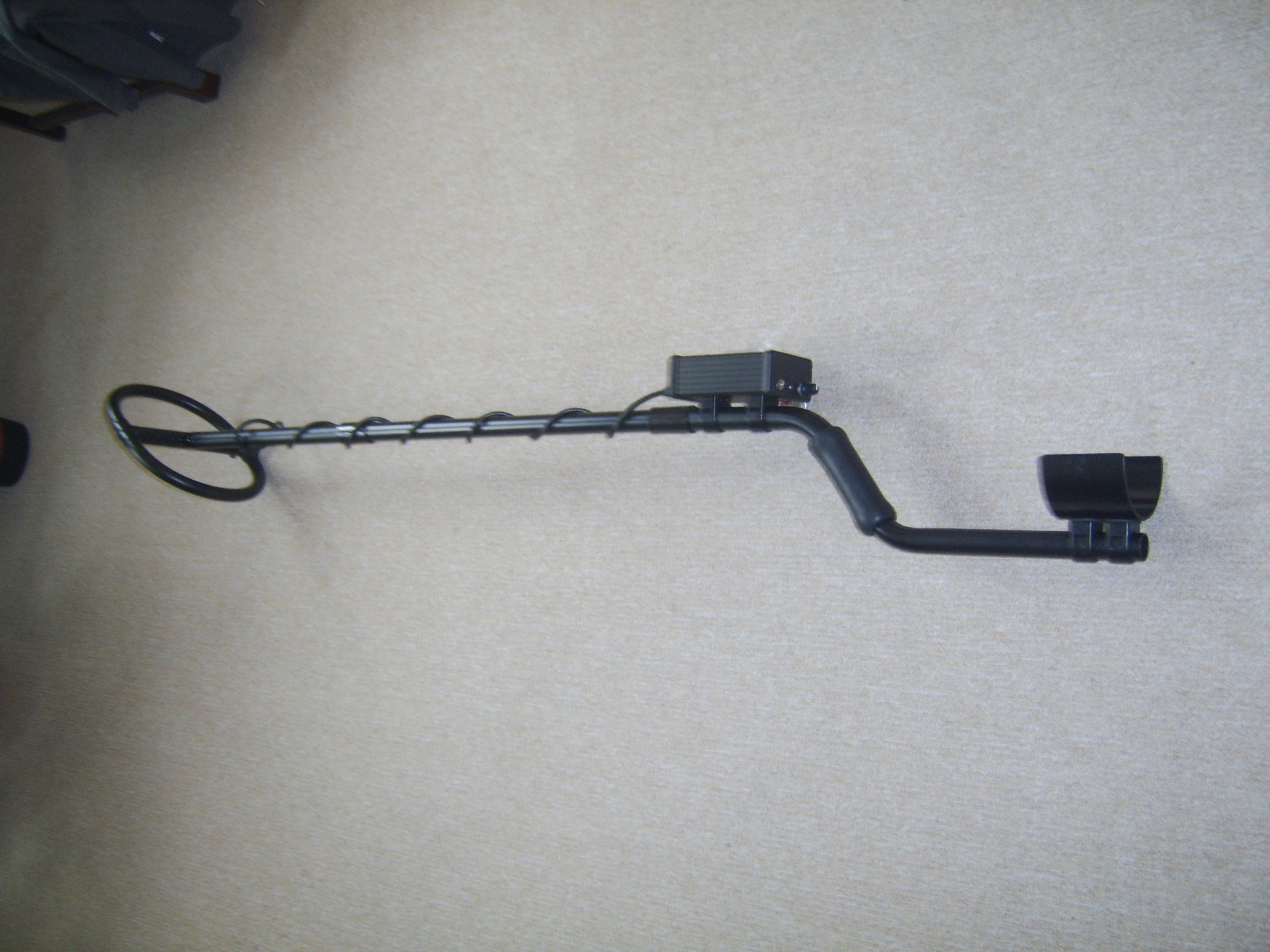

                • Barracuda disassemble for transport.
                  • Put together.
                    • Lengthwise.
                      • Finds.

                          • Originally posted by gcause View Post
                            hello gcause
                            thanks
                            all is made from high pressure water pipe(16bar) from hardware store
                            these connectors are made for them t-connector is 20/20/20mm
                            the other connector is for 20 to 25mm (lower shaft to upper)
                            bending the tubes is made with a spring in the pipe then heaten up and bended around a thick metal pipe or anything other round form
                            if you have no spring you could use ordinary sand ore birds sand from petstore
                            armrest is made also from bigger waste water pipe with soft rubber
                            grip for hand is from bicycle (use some lubricant like aquaglide to fit it on)
