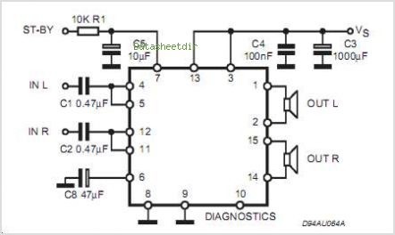

                    I'm doing an audio amplifier 2x30 watts rather good I was thinking, consuming 3 amps at full power, with tda 7377 if anyone wants to upload the schema.
                    but I see that many people do not know what does.
                    sepuede 2canales to stereo or 4 channels

                      • if I have the key to upload files[
                        Amplificador Con TDA7377 2.0.0.zip

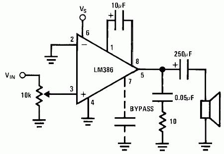

                          Finders explains all about his amp in post #495, it plugs into the audio out socket
                          a 386 should work ok , next week I will be trying a 386.
                          I have just completed a simple audio amplifier using a tda2003 and now obtain approx. 20% increase in depth. It's connected to an external 8ohm/5watt speaker and powered with 9volt/200mah ni-mh batt. The unit is enclosed in its own box and attached to the control box of my bara. It makes those very soft subtle tones more audiable and now get a ring at 36cm and a 5 cent aust. coin at 30cm with a minelab 11 inch monocoil.
                          • David135 also likes to log in under several different user names - maybe he is schizophrenic?
                            • good, this man is that I wanted thim sell a barracuda over 150 euros, and now can not sell, I make my own detectors with many problems but I,, I ask to buy are for friends who are very heavy this thim is very smart, is a Nobel Prize, jjajjaja,
                              I leave here a sketch of the LM386 with 72dB gain and you shall have it all but,,,, (if you want my opinion you should put 10 to unite in pyramid at the end for a gain of 700 db).

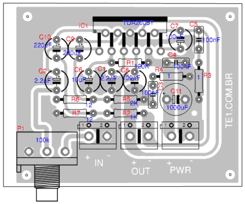

                              I thought I have to do other things, also will put a 20w tda 2005, for which it nesecite.
                              I can also upload boosters or source 0 to 50V Feed Through, or 0 to 30V. greetings to all especially to ezquisofrenico ..

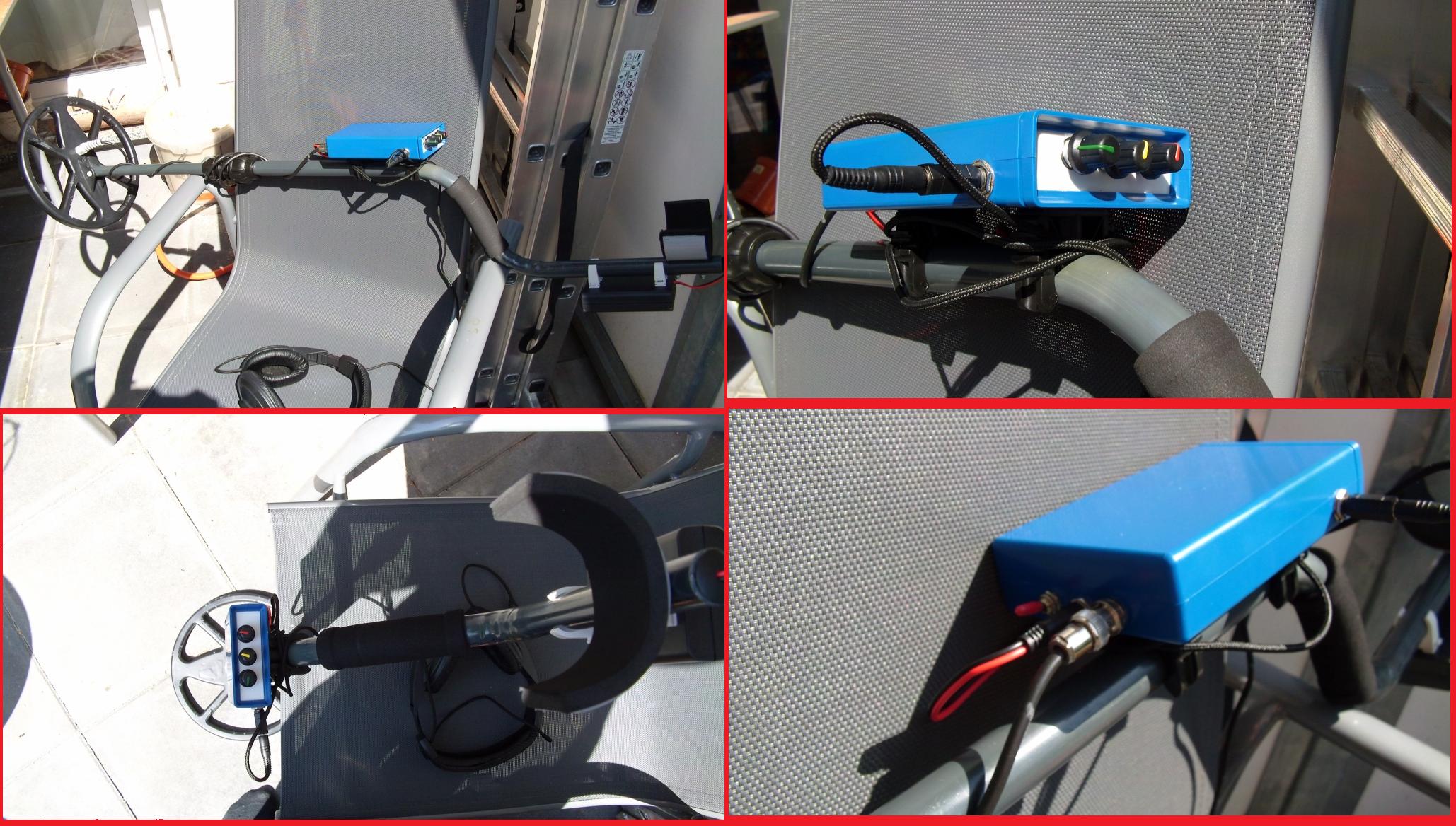

                              • hello
                                here is the new baracuda
                                was made for somebody from malaga
                                was ill some weeks and had problems in my garden (broken water pipe)
                                but now its finished
                                weight within headphone and liion akku pack 1.598g
