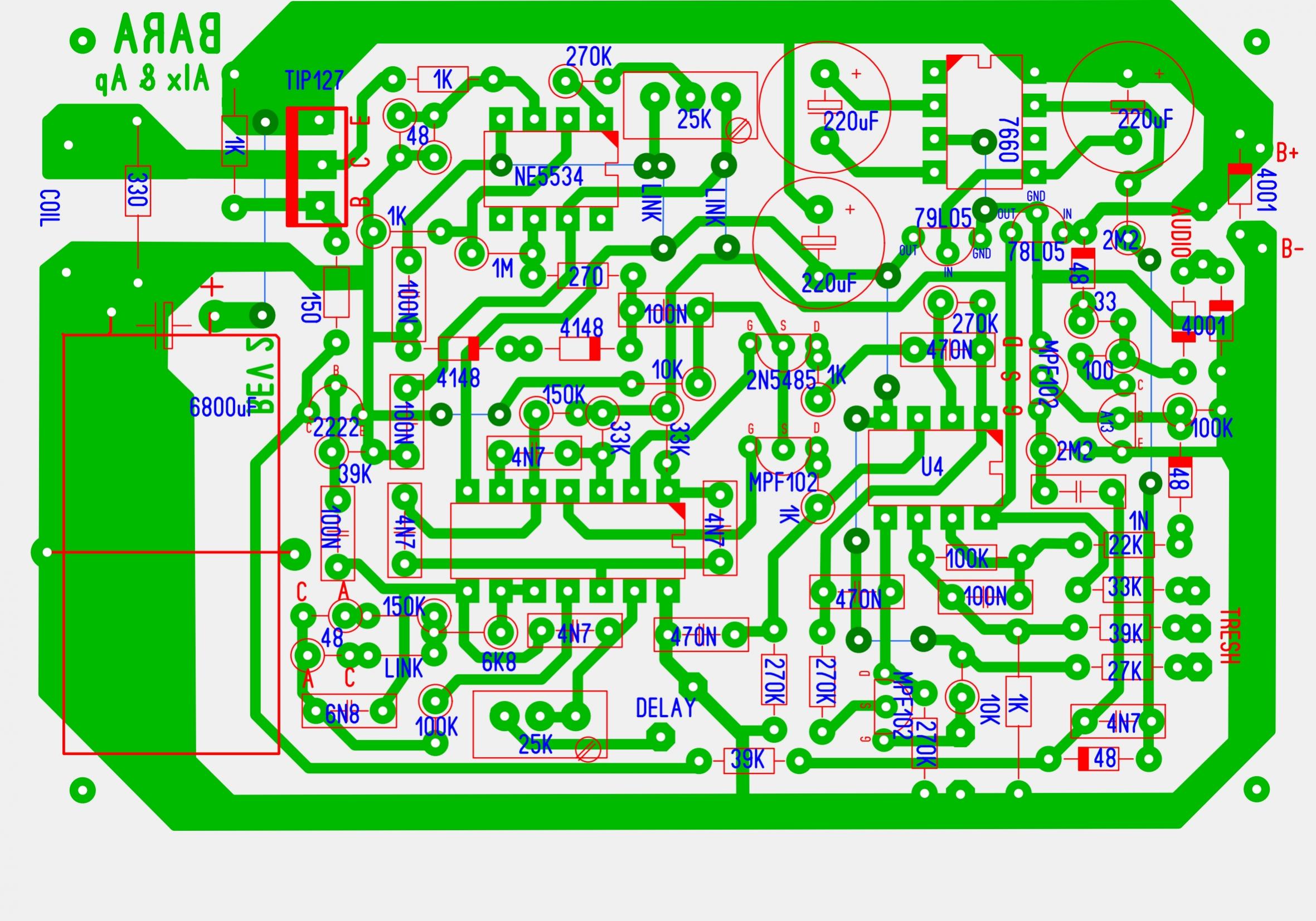

    As requested top plus bottom thrown in for good measure
    If Qiaozhi could also kindly upload these files to the project page then everyone should be happy
    • Note for up and coming engineers
      When building this project like all projects on here use all data side by side.
      Firstly print off the circuit diagram together placement files and parts list and work between all of them.
      By doing it this way which is the correct way your not only learning how the circuit ticks but closing doors on mistakes you could have easily avoided.
      All the best

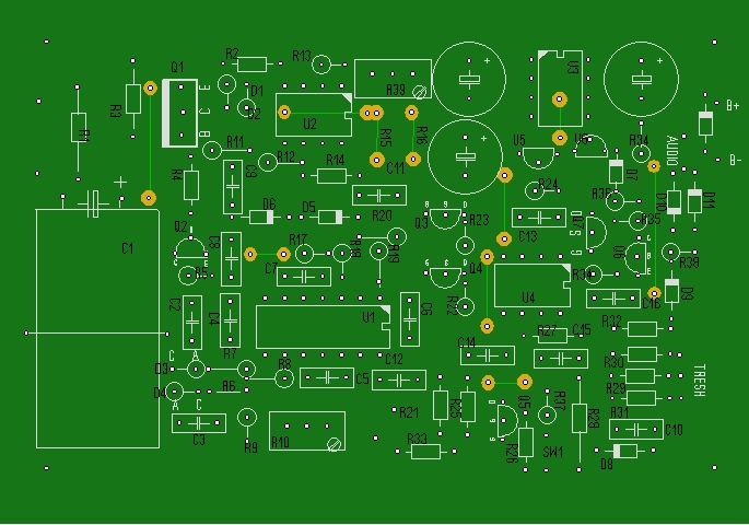

      • i read above that dave added the led where on the board does it connect?
        when i built mine i could not find where to place it
        though it works really well depth is not as good as some have reported
        • Hi Sinclair
          The LED is directly wired between + supply line and the junction between R35/R36
          It mimics the audio responses perfectly providing your speaker load is 32 ohms as Barracuda manufacture specification , typical of most headphones in use today, or if no load is connected.
          If you deviate with output load then it greatly effects LED response and renders it near useless.
            Hi Sinclair
            hi dave thanks for that i know about replacing audio with an led but i was sure the original had both?
            as for speaker single head phone 32ohms(deaf in left ear!)
            did you ever work out the q5 thing i omitted it and it does indeed work fine.
            my idea is that the extra components and switch one are used for setting up in the factory
            if you add those parts with a simple on off switch or even a short across sw1 setup is way easier first setup i mean after that you can adjust in with the remote delay but i have removed q5 and remote delay and the detector is more stable and easier to use
            in my case anyway so i left it at that as i say my bara is better without the extra delay pot and q5 etc without them the detector does not drift and need to be adjusted
            aly
            • Originally posted by sinclairuser View Post
              hi dave thanks for that i know about replacing audio with an led but i was sure the original had both? as for speaker single head phone 32ohms(deaf in left ear!) did you ever work out the q5 thing i omitted it and it does indeed work fine. my idea is that the extra components and switch one are used for setting up in the factory if you add those parts with a simple on off switch or even a short across sw1 setup is way easier first setup i mean after that you can adjust in with the remote delay but i have removed q5 and remote delay and the detector is more stable and easier to use in my case anyway so i left it at that as i say my bara is better without the extra delay pot and q5 etc without them the detector does not drift and need to be adjusted aly
              Hi The original did have both and if you wire the LED as I have stated and as the circuit diagram shows (don't omit anything) then you also will have both, but as I said your speaker/headphones need to be 32ohms. By doing this you can then run the machine both with LED and headphones or just LED on it own. Far as Q5 allot on here have done as you have and omitted it and there very happy so if your happy leave as it is. The SW1 far as I can gather was never ever used on this devise, whether it was for set up before leaving the factory is my guess and others on here, but thats all it is a guess, no one is certain I have asked Jim who originally designed the Barracuda and to date have had no reply.
                thanks dave repaced q5 and resistors, though left off remote delay pot and added the led
                now perfect may try tweaking it later but it works and seems quite deaf to radio mush which in my shack is a bonus
                i guess only one man knows the truth about q5(as you eluded to!) but mine now has it (again) and still stable its as complete as can be done for now
                big thanks to all here for this thread
                i am now proud to recommend geotech projects to fellow tinkerers
                aly

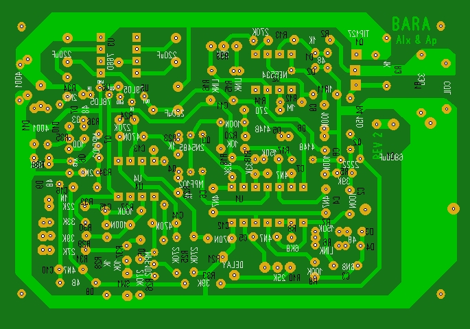

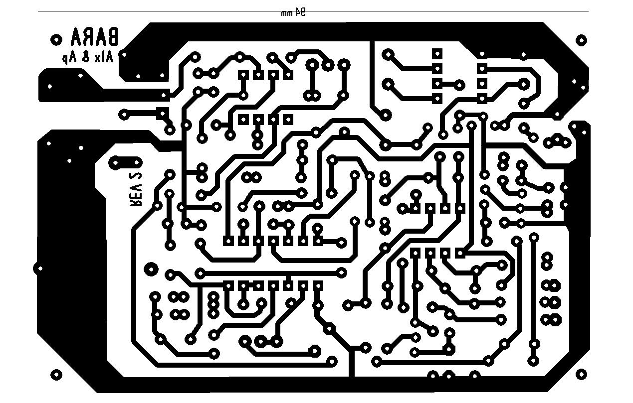

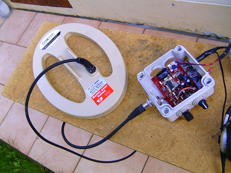

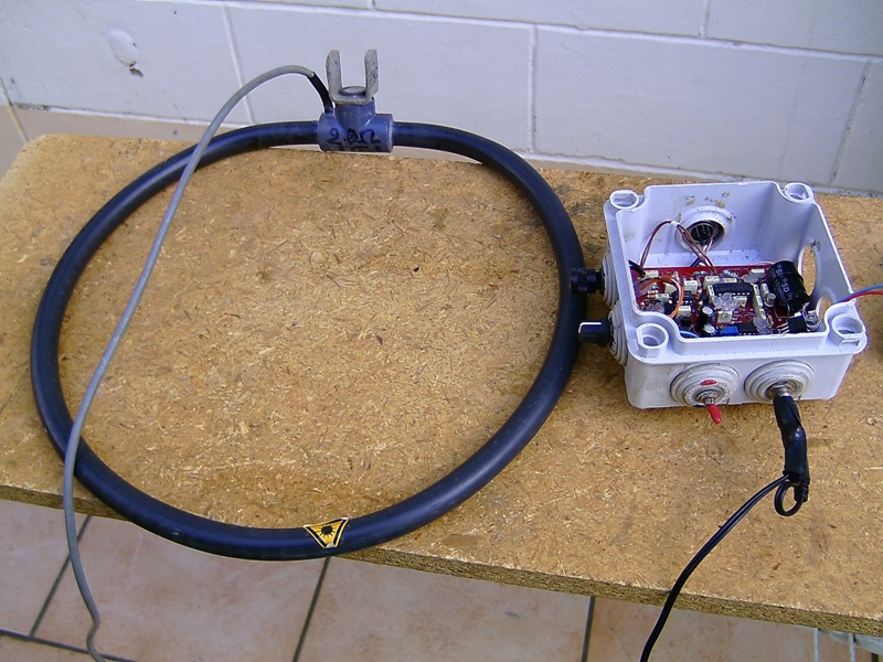

                        • Here is a pdf of a baracuda layout for my friend Mohandes
                          • hello apberg, baracuda is very good, I use coil coiltek goldstalker mono coil tdi I repair and coil I make, thank you for your kit! my problem was interference from wire coil reverse ...: Rolleyes:
                              HI my best friend Davor
                              just my question is very simple your pdf is original and exactly value for the size if i print it?
                              because this i want Print pcb and make it
                              and please check #598,are the parts good Equivalent for original parts or i can use combinatorial parts of this number and original parts because maybe some parts dont exist and i have to use the equvalent parts.
                              thanks
                              • Hello Mohandes,
                                . Click image for larger version
ID:	336002Click image for larger version
                                think this are the JPG's that are for the baracuda as in the forum, the pcb is copper outsides 94 mm (..I made to many different layouts) so check things before you start ! The circuit diagrams are at the start from this baracuda topic, made by Alex . Before you start look at them to see what parts you have in Iran or what replacement you can get and collect the needed data sheets from WWW to see the pin-connections.
                                Succes
