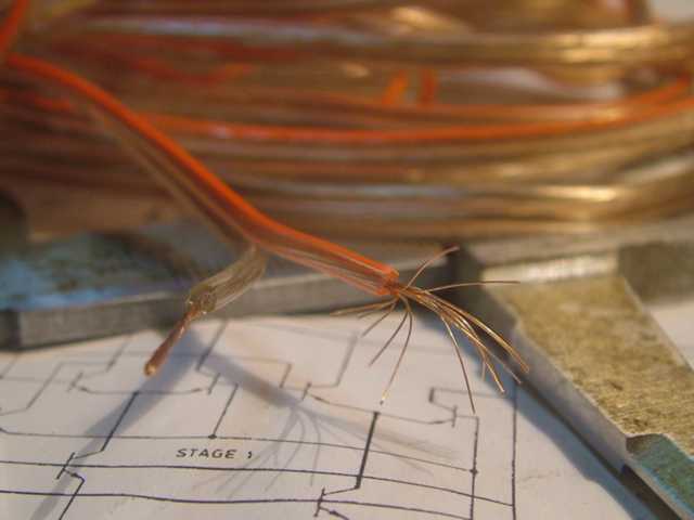

            Try to find smaller possible diameter (larger gauge ) speaker wire, awg18 is unnecessarily large. Cheapest possible type, actually not good for speakers at all (high resistance) but very nice for coils, usually 2x AWG20-23 and some 2mm plastic insulation two wire cable, both wires in parallel. So, less cooper and more plastic is better for this (to avoid unnecessary metal inside coil and reduce parasitic capacitance), resistance will be still OK, target around 30 turns, or around 300uH (250-350) if you vary geometry. Your coil calc. is probably wrong, measured inductance will be somewhat lower. For really fast coil, avoid cable and connection, just leave some 1.2m speaker wire from both ends of the coil and twist every 2-3cm. After proper damping resistor selection and minimal delay adjustment you will be very pleasantly surprised with results.

                  This type, cheapest possible thing from nearest flea-market. For detectors like barracuda avoid too high inductance, some 300uH is good target point, resistance is not too critical, 1.5-2R is typical value, don't add anything in series. Coil capacitance can be determined by measuring SRF- self resonant frequency for known inductance, already described on this forum.

                    • Also worth keeping in mind don't make the common mistake of winding to tightly because otherwise you will not only increase your inductance but also the coil capacitance, made alot of duff coils in the past due to that simple mistake.
                      Just firm and even pressure while winding.
                        so lan cable better ?
                        an you put here image of coil winding to teach me .
                        • Using cat5e cable is fine but make sure its a good quality solid copper type which is around .4mm with good thickness insulation round each core , allot of cat5e cable been sold around is cc type which is crap , cc copper clad which is normally alloy coated with thin layer of copper.
                          I made a good coil out of .5mm LTC wh1003 cable which is stranded pure copper instrument cable.
