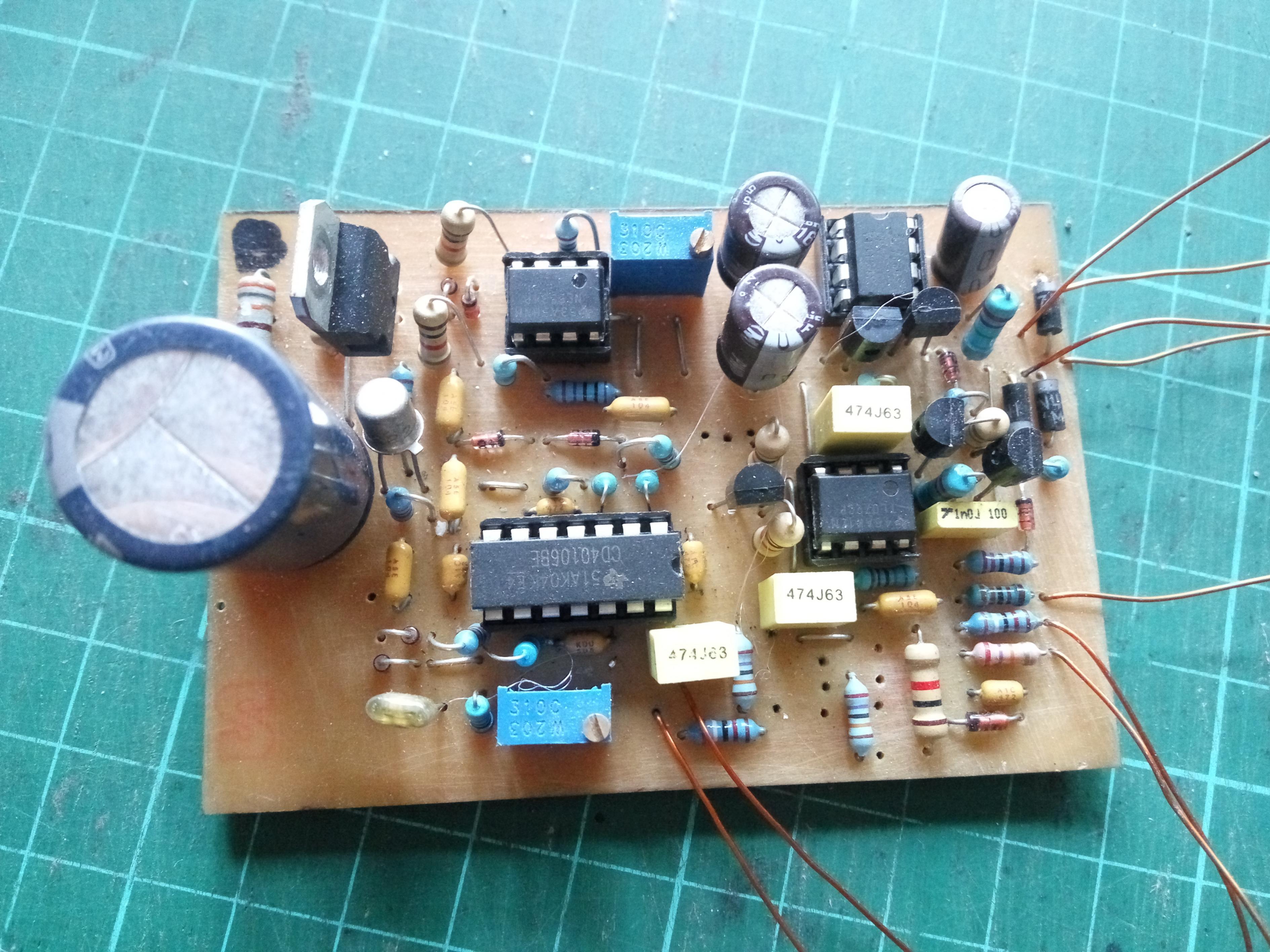

    Change R18=12K, R18=15K right?
    Reduce tilt beep, already test outside....Nice, hope new 40106 will arrive tomorrow.
    I using HCF40106, CD40106 is too sensitive.
    Is this MD use ground earth efect as signal gain, its detect small nail on the ground, not in the air.
    Dig site [ATTACH]36369[/ATTACH]
    Result [ATTACH]36370[/ATTACH]
    Your R 18 should be 12K
    YOUR R19 should be 15K
    Your R17 should be 150K and should not require changing
    Idealy you could use an oscilloscope to adjust R18 or R19 slightly to optimize earth magnetic field rejection but since you do not have one this will have to do.
    Replacing the 40106 MAY help with with this proble.

                  3 40106 have arrive, put it on.... nothing change
                  I use schematic from sticky thread, not the one with 22uf capacitor extra (kt13 version).
                  What is it preciuos.....

                    Sorry to hear this. If you want to work on it some more you will need a scope and maybe a digital multimeter. For now about all you can do is examine all the solder joints carefully and make sure they look clean and shiny. Have you cleaned the board yet with alcohol and an old toothbrush until it looks clean? Have you adjusted the voltage on the output pin of the 5534 to 0 volts? What do the -/+ 5 volt supplies read? All voltages should be measured relative to the battery - terminal.
                    • Yes, 5534 pin 5 is 0, +5 and -5 is normal, already clean the flux with copper brush (very effective). Let me check again...
                      Will change the battery, for now is 7.5+volt

                        Yes 7.5 volt is too low. What kind of battery are you using? Copper brush is not the best for such use. Make sure no metal remains on the board with a magnifier.
                        You need to measure pin 6 of the 5534 for offset voltage.
                        This is the most current schematic, but it is stil not final. Check the caps around the power supply they have been changed.
                        http://www.geotech1.com/forums/attac...8&d=1460301639
                        If it is still beeping near the ends of the swing it sounds like an earth field problem. This is hard to adjust without the scope. You can test with a small ferrite magnet or a plastic refrigerator magnet.

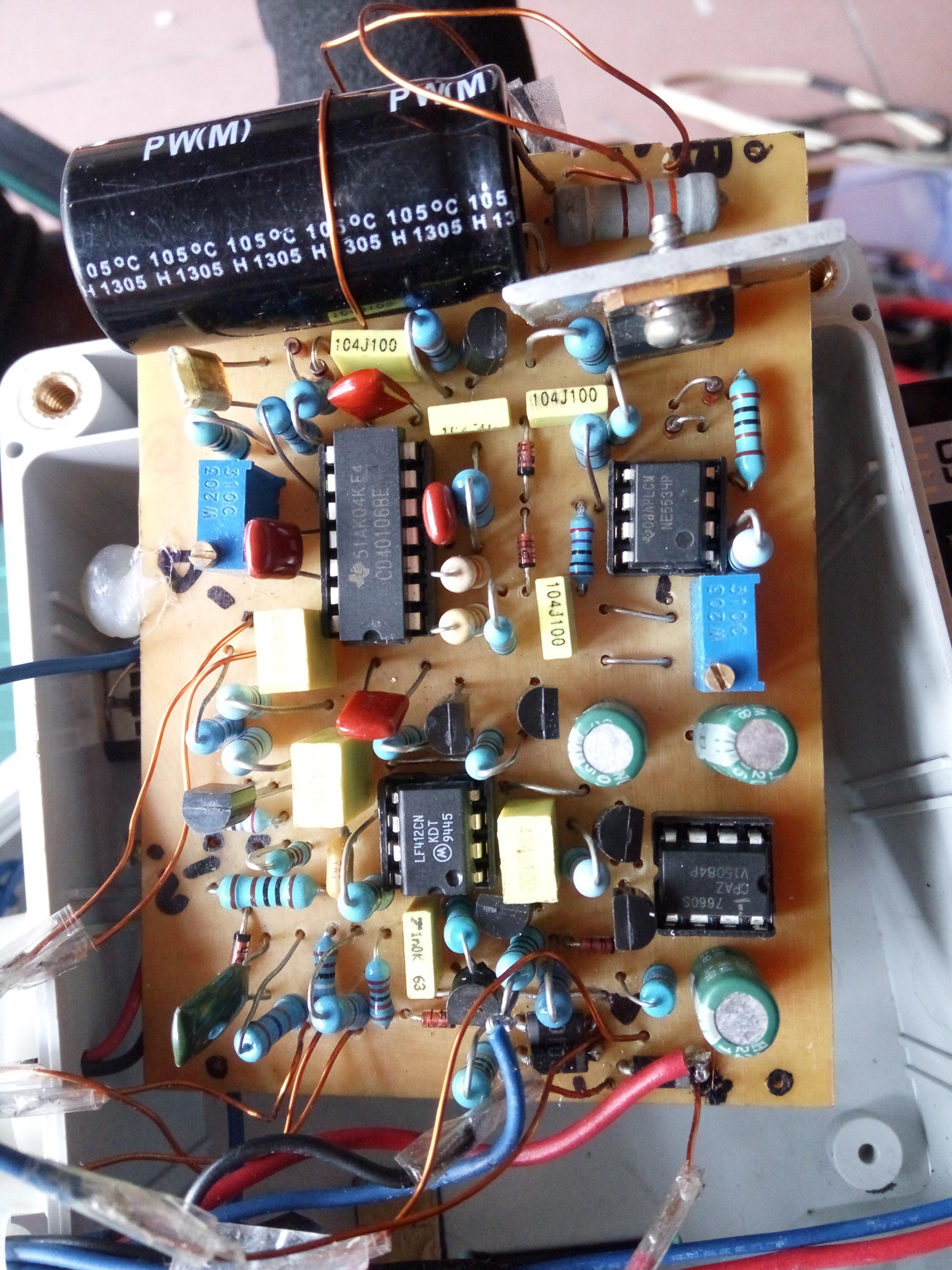

                        Very clear pictures taken in good light of the whole setup, a close up of the top of the board and the bottom may help too.
                        • I use 2x 9v battery in pararel, now im using 8x AA 1.5v to get 12v.
                          My board doesnt have 47uf and 10uf polarity caps, the big one is 6800uf, in that scheme is 4700uf, its very different with ver.2
                          • Originally posted by ripsdevala View Post
                            does it work any better with the 8 AA BATTERIES? The 9 v batteries in parallel while clever, are not a good source of power.
                            Look at the scheme I sent you. You will notice caps from - to + 5 volts. In general that is not the best way to do it. Try to make yours more like the scheme shown. Note that if you change it too any times if may break so be very careful.
                            The 4700uF should be fine. Focus on getting C7,8,9 and 10 connected correctly. This may require you to solder the caps to the back of the board.
                            The cap connected between the + and- inputs before the regulators should be removed.

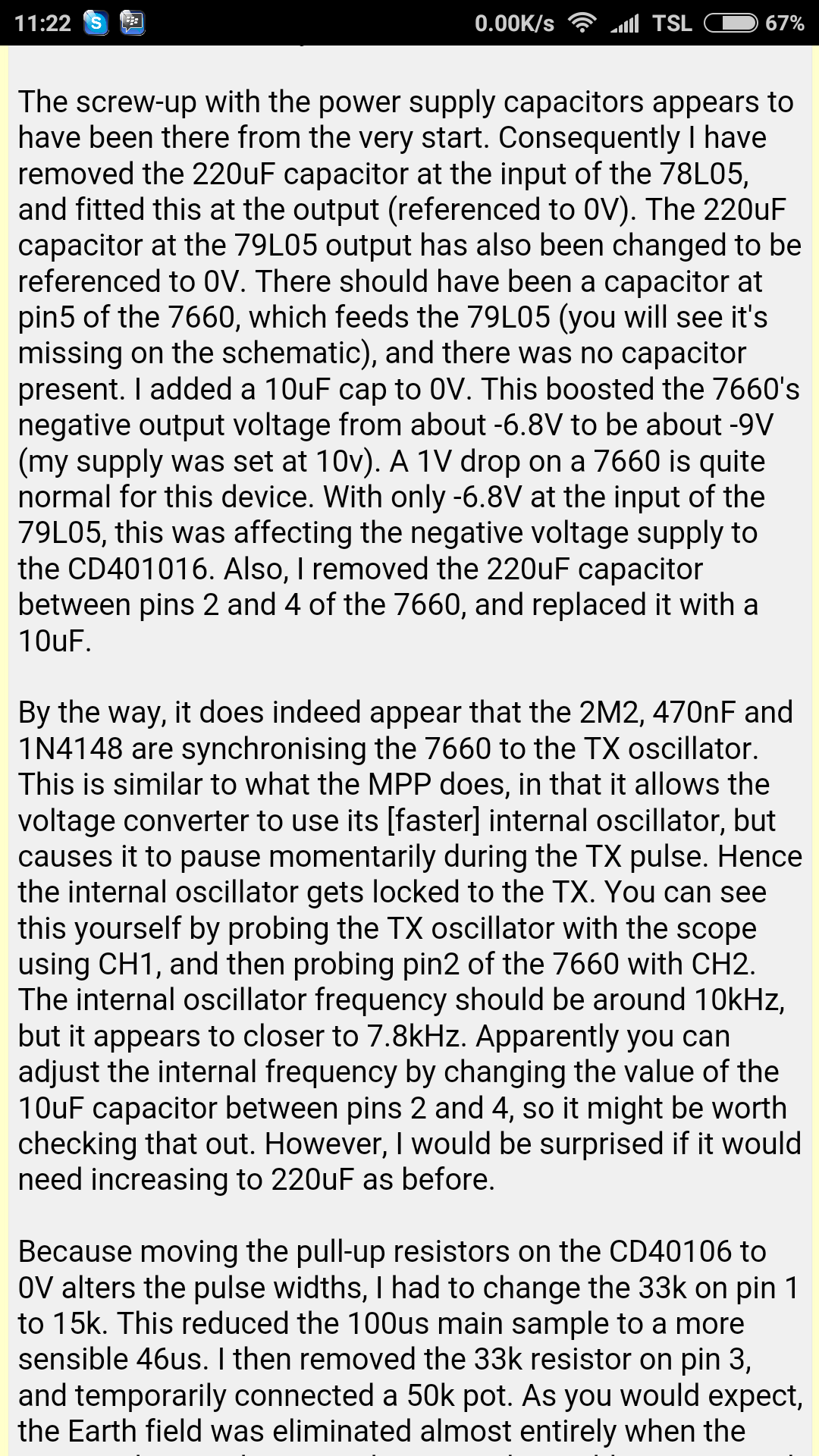

                              For more details on what is likely going wrong read this thread.
                              http://www.geotech1.com/forums/showt...it-Rev2)/page3
                              focus on post 102 but read the whole thread and make notes.
                              you may simply have the power supply wrong and this could be blowing out the (new) 40106.
                              • I see... Change two 220uf and add 10uf to 0v, btw where is 0v track according to Queozi mod?
                                Qiaozi mod

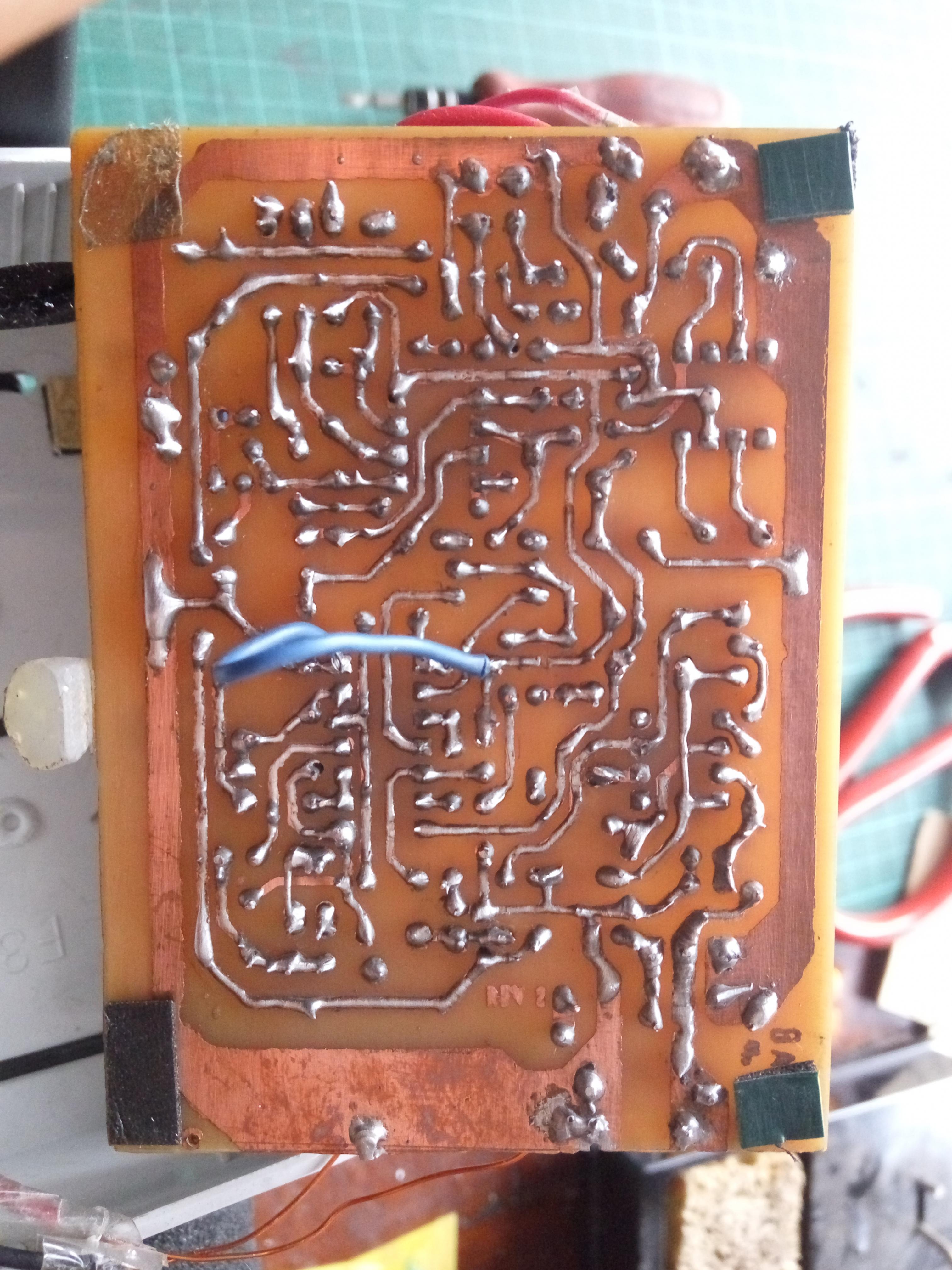

                                My current board, please dont scold me tin every where
                                Top
                                Bottom

                                7.5v battery is working, same as full 12v battery, 12v make 7660 warm.
                                Thanks for supporting me old_chart.
