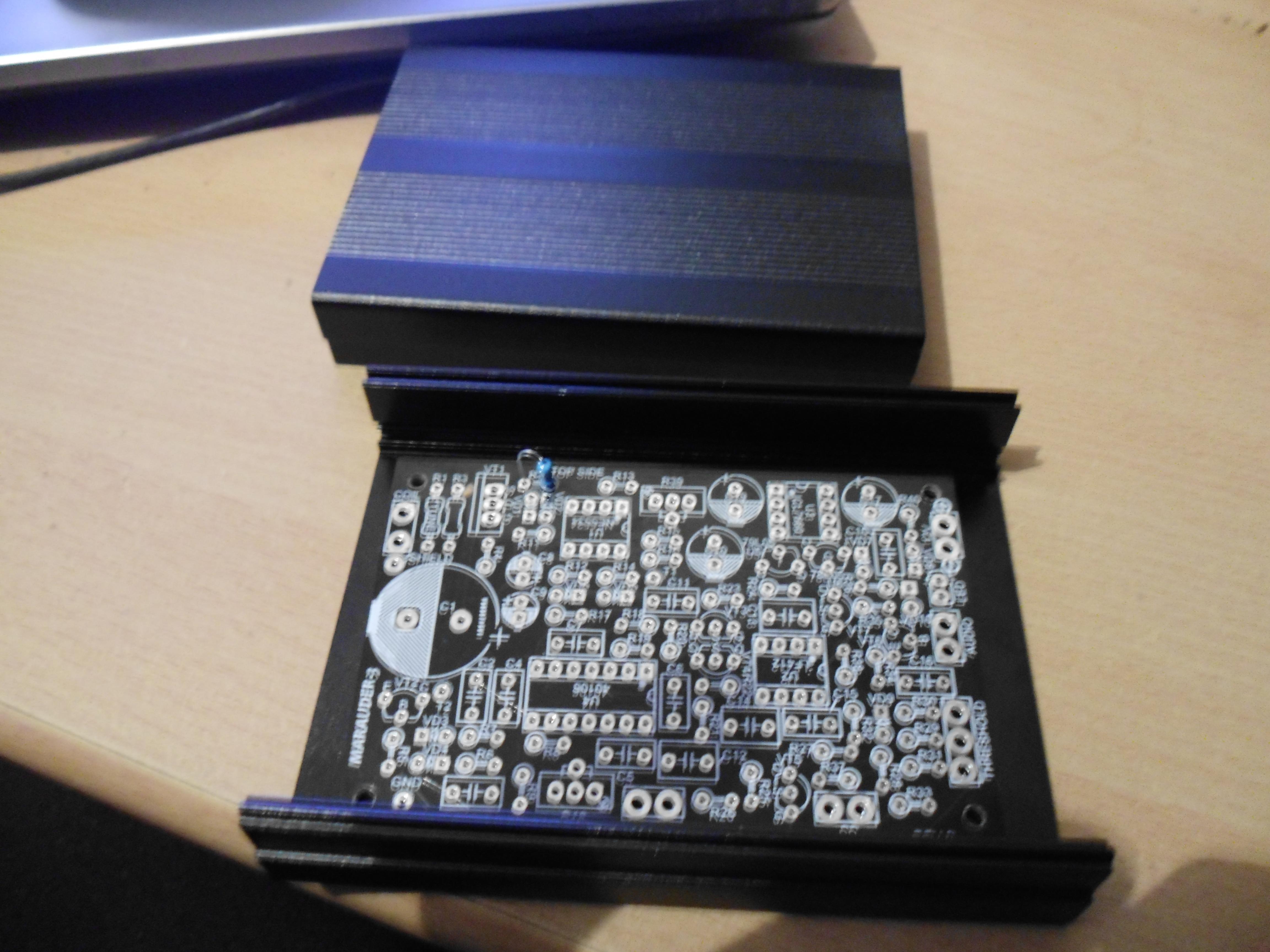

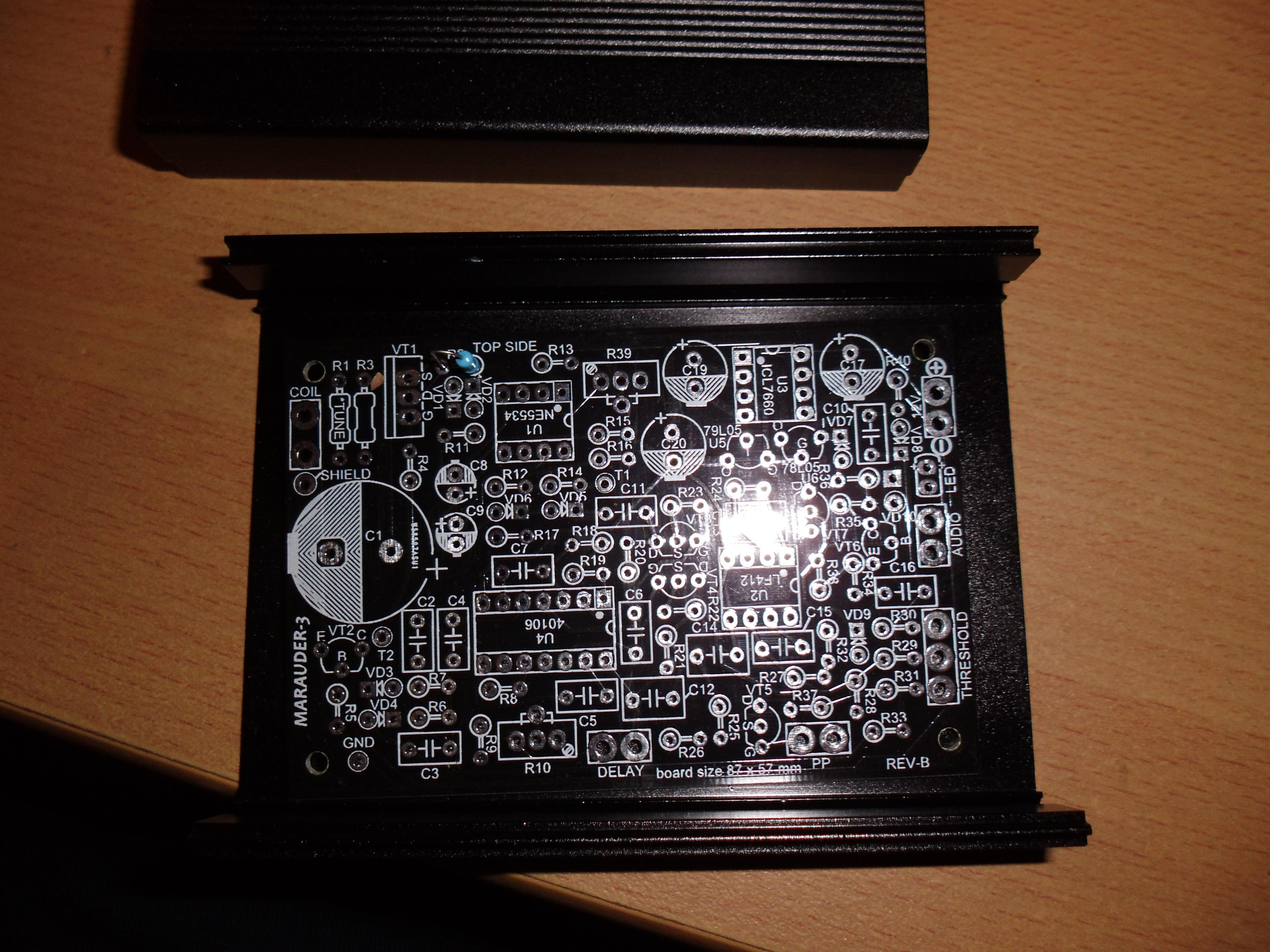

      • I found a perfect fitting enclosure for your small Barracuda Legend boards.
        https://www.ebay.de/itm/Alu-Geh%C3%A...53.m2749.l2649
        • Nice if you don't mind out board battery.
          • I would need to change the Cap on my board. It would stand too tall I think.
            • I have bought the small one for 3x 18650 batteries and its perfect for them.
              I mean the small one with the round edges.
              Unfortunately my enclosure for the TGSL is very heavy. But the board fits in it like its made for it.
