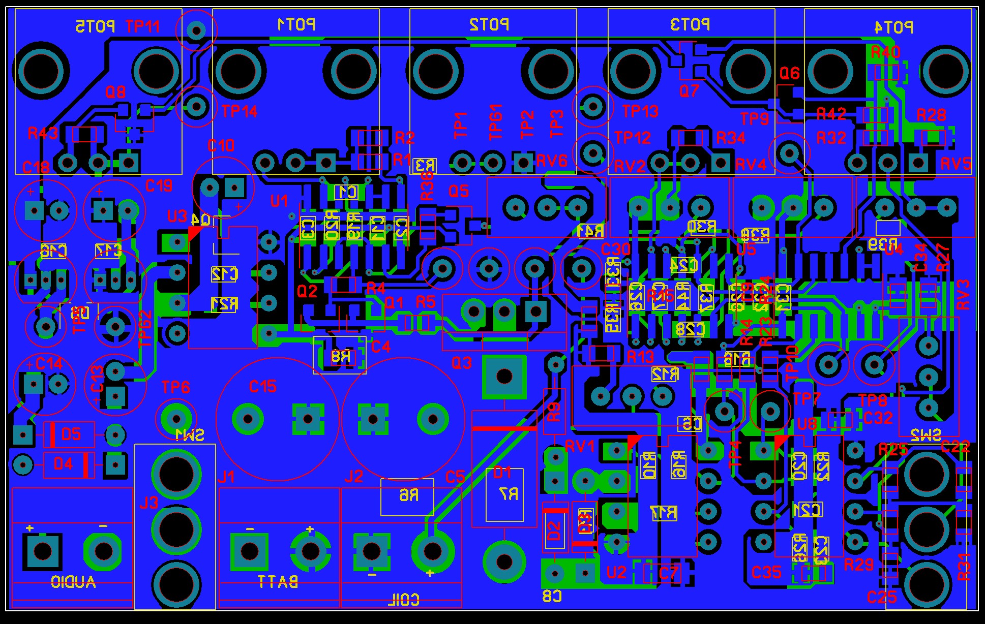

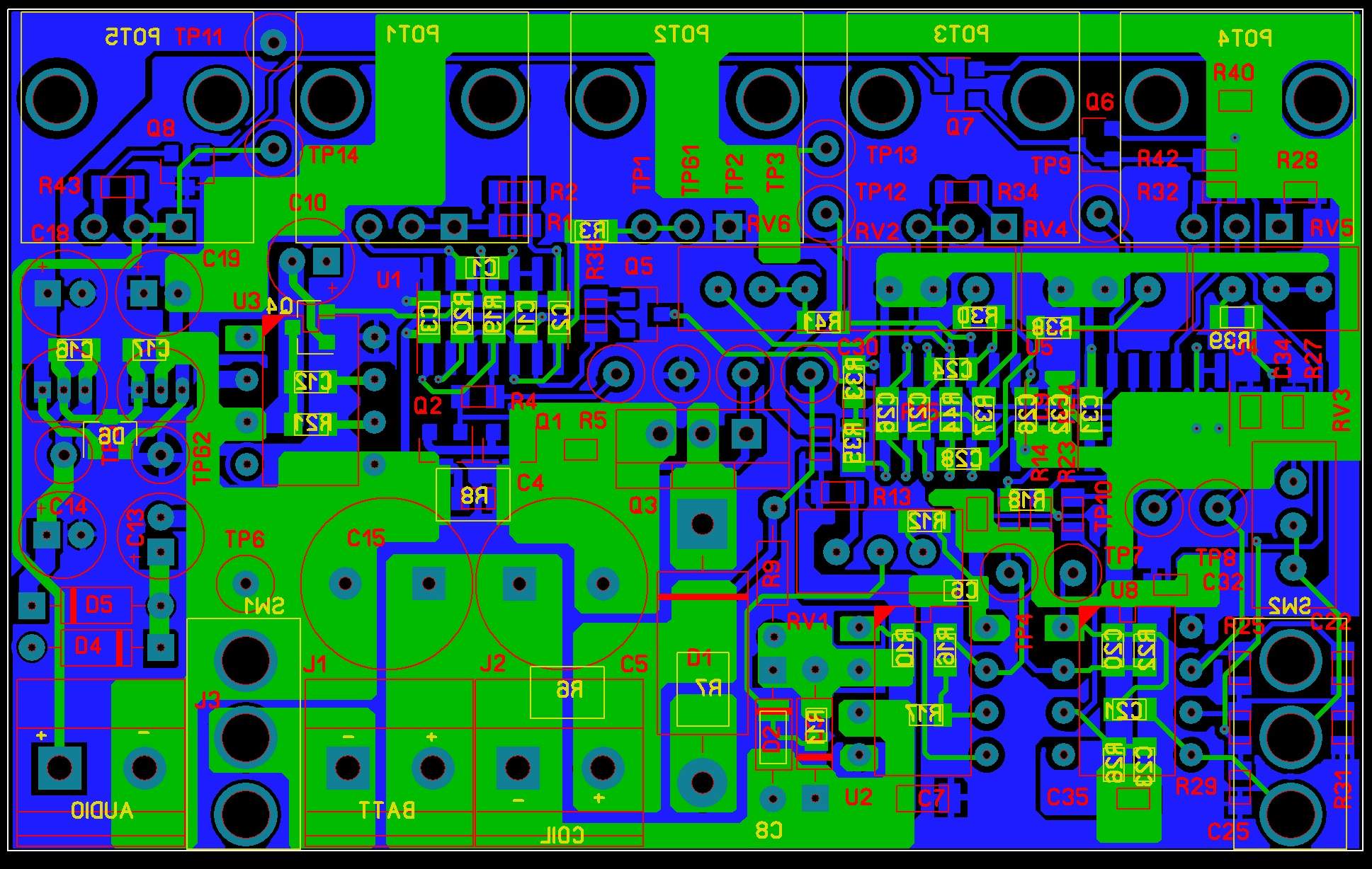

        An execrise...
          Nice edit, I do like the way you've added thermal reliefs to the plane connections.
          I did consider these but figured the slightly better noise characteristics would be worth the increase in soldering difficulty.
            I did on top but forgot to do on bottom layer, some of them!
            Do you really think that so little copper missing will affect pcb S/N ratio?
            Your work is certainly more meticulous and tidy and better.
            My "scratch" is incomparable. I did it almost all manually, over the bitmaps.
            I could import gerbers into Sprint Layout 6 though.
            But this time I wanted to spend more time, so I made few bitmaps and used them to draw over.
            Sprint Layout can automatically generate ground planes. Yet I did all manually by drawing.
            So later I can remove some parts if needed and edit if needed.
            But I do it purely as a hobby, to kill time in these boring winter days.
              But there is another particularly absurd reason!
              We have a colleague on the forum who is quite weak-minded and not quite on his own.
              It is his habit that every now and then, for no apparent reason; convinces others not to use Sprint Layout in any way,
              at any cost. It will be clear to you who he is, when he spots this post. Like a monkey when sees a banana through a fence;
              such will be his reaction to what I have written here!
              Joke aside, redrawing is my favorite hobby on winter afternoons.
              And I was interested in your work, so I decided to do it.
              BTW I forgot to say: GREAT WORK indeed!
              Cheers!
              Thanks for the positive feedback - much appreciated.
              Sprint Layout looks very nice indeed, but I'm a Mac user I'm afraid so it won't run on my system. I use KiCad for all my hobby work and so far I'm quite happy with it as it seems to do everything I need and the price is right .
              I suspect that as you suggest, the thermal reliefs won't really add any discernable noise, depending on the thickness and length of each relief trace they'll probably only add around 0.25 milliOhm to each connection point so I'm probably being a bit paranoid when it comes to the noise. I was mainly concerned about the grounding scheme for the front end and its 1000x gain where even a few microvolts of noise become millivolts after amplification.
              If you'd like the KiCad PCB file to play with let me know and I can post it on the forum as well.
                I assume there are lot of members on forum to welcome that too.
                Cheers!
