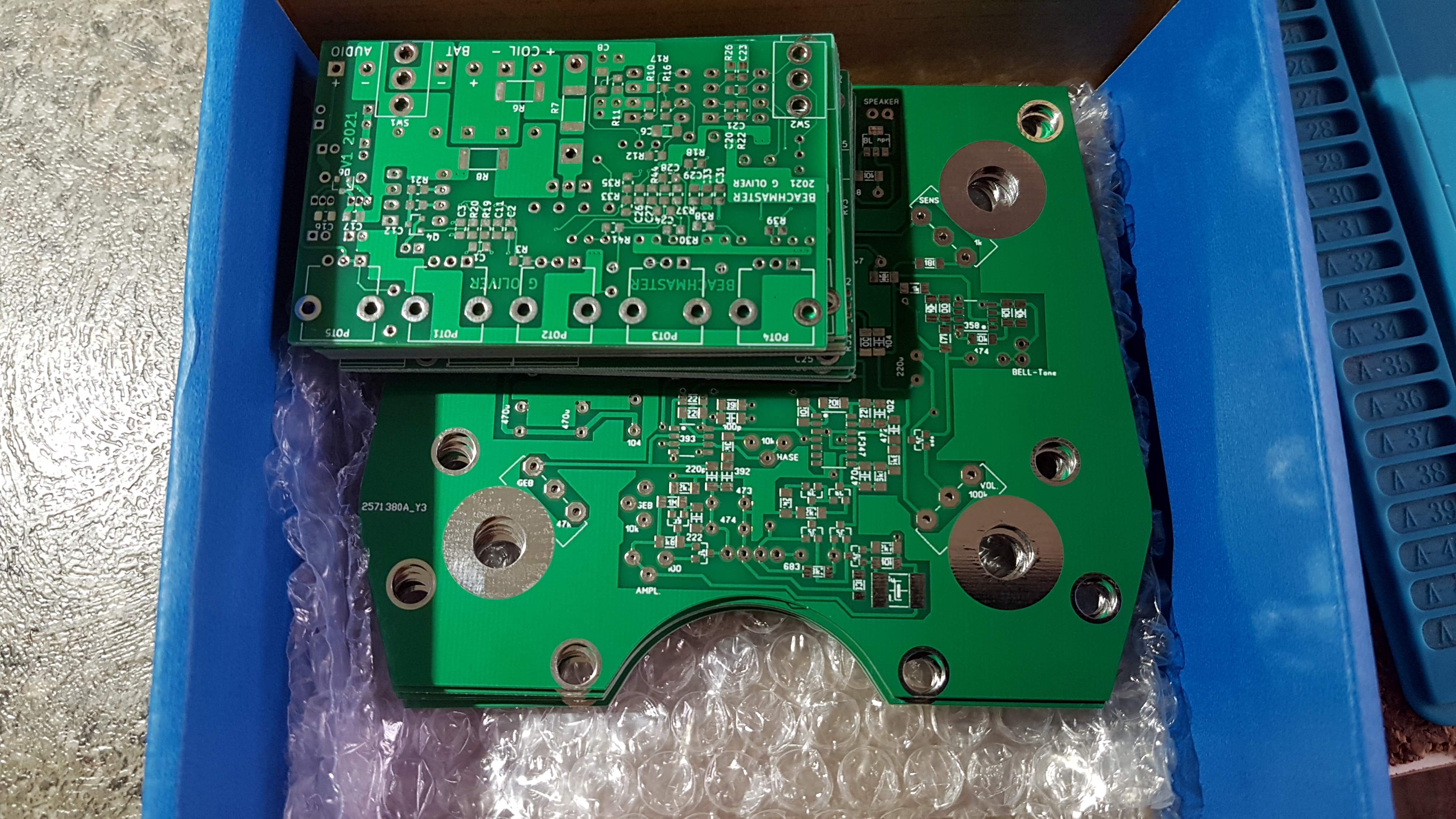

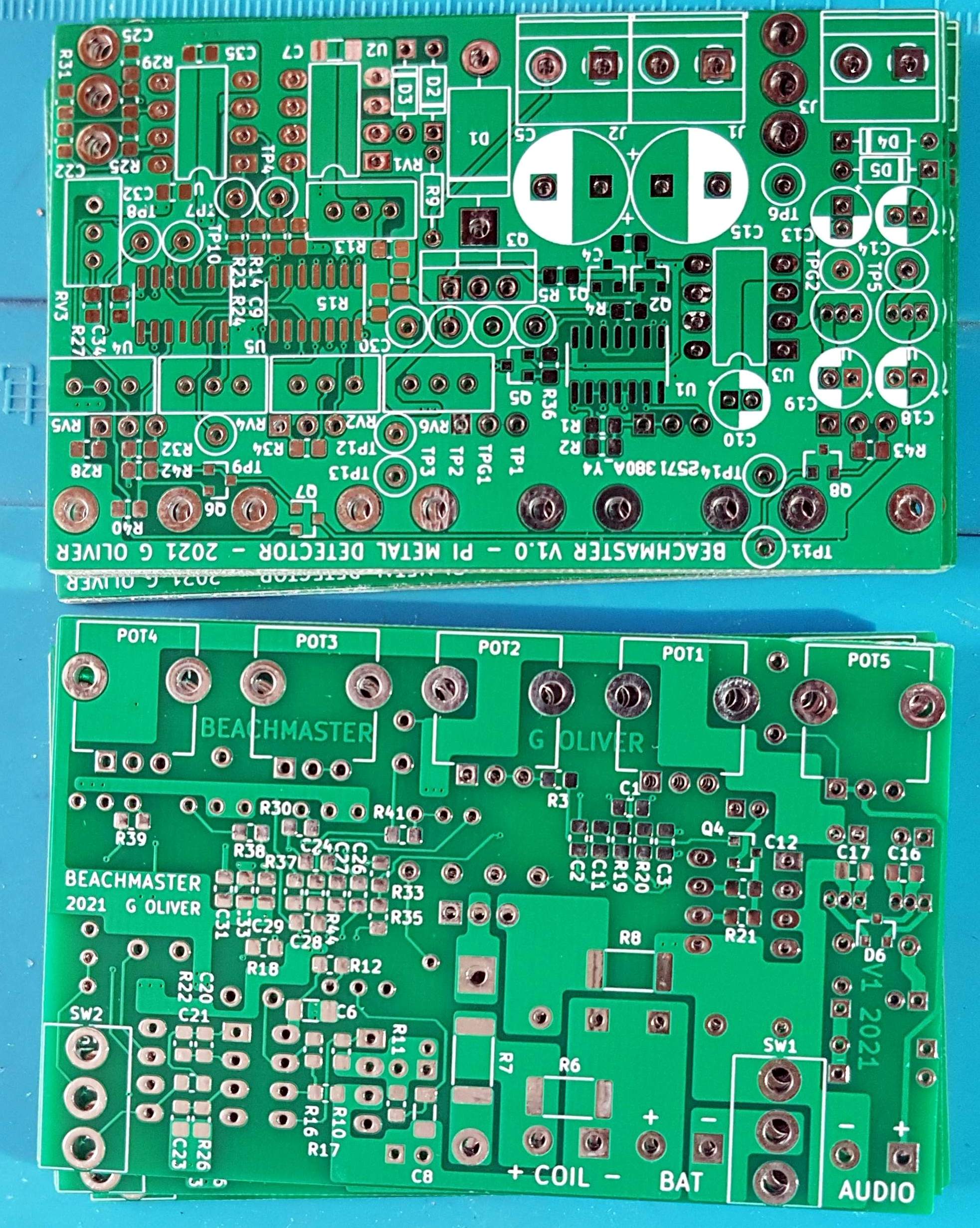

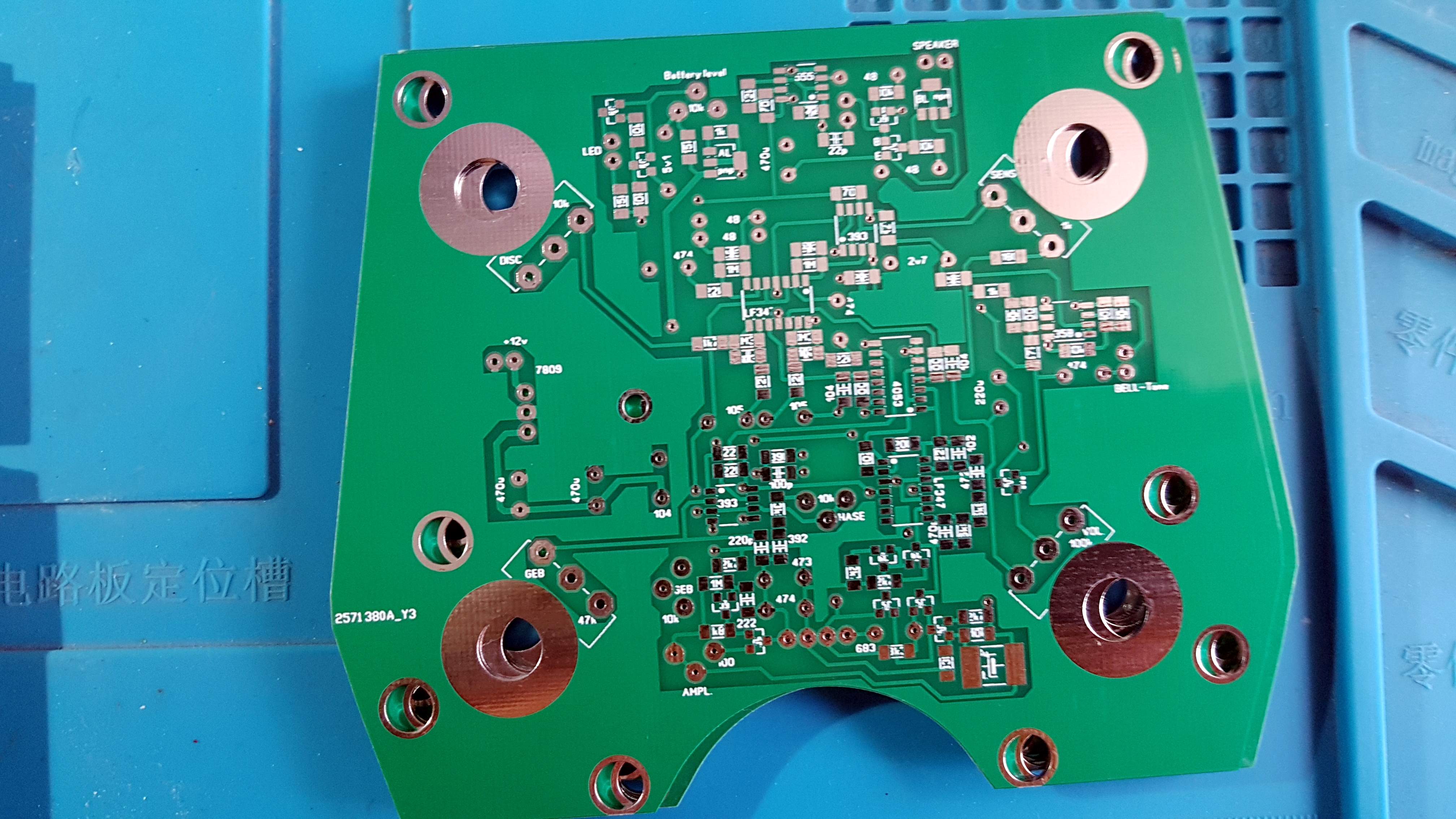

    Pcb's arrived:

      Hı master ivica,
      Looks nice
        Nice looking boards, what are the other larger boards with the rounded cutouts?
        When assembling the Beachmaster boards, remember to use the Fab files for component location as the silkscreen ID locations get a bit cramped in places.
        Post #24 above has the latest doc pack which includes all files including the 'Fab' files and updated 'Build' document.
        Good luck with the build and let me know how you get on.
                            SMW, an old project. I made numerous of those in through hole fashion so far.
                            Now I just want to try SMD.
                            Thanks!
                            I ordered flux the other day, waiting to arrive. Same with some components.
                            I suppose it will go slower, now with SMD, than usually, because I am novice in this now.
                            But certainly I will report my impresion and results when all is done.

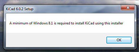

                              Ok I am intrigued enough to try Kicad...
                              DANG!
                              I am back to Win7 for several months.
                              I used Win10 for quite some time.
                              But some old software isn't working well under Win10.
                              So I was annoyed with that and returned to Win7.
                              Now seems I will have to return back to Win10 to be able to try Kicad.
                              Older version will work under Win7, but I want to see new one.
                              Damn!
                              Crazy enough; I am having Win10 in Vbox, working just nice.
                              But installing such huge (1Gb) package in virtual machine will eat completely the virtual space i designated for virtual drive.
                              Probably also slow down the system.
                              I might return back to Win10 one of these days, will see.
