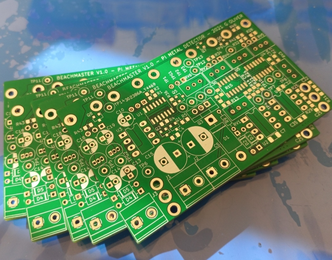

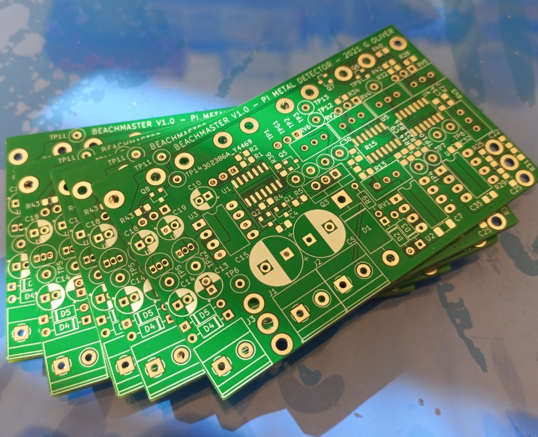

                                Hello, good time, my pcb order arrived from China
                                please design this circuit to be able to increase the pulse width up to 300 microseconds, because as far as I know, using a large coil requires more pulse width. How do you think pcbs quality?
