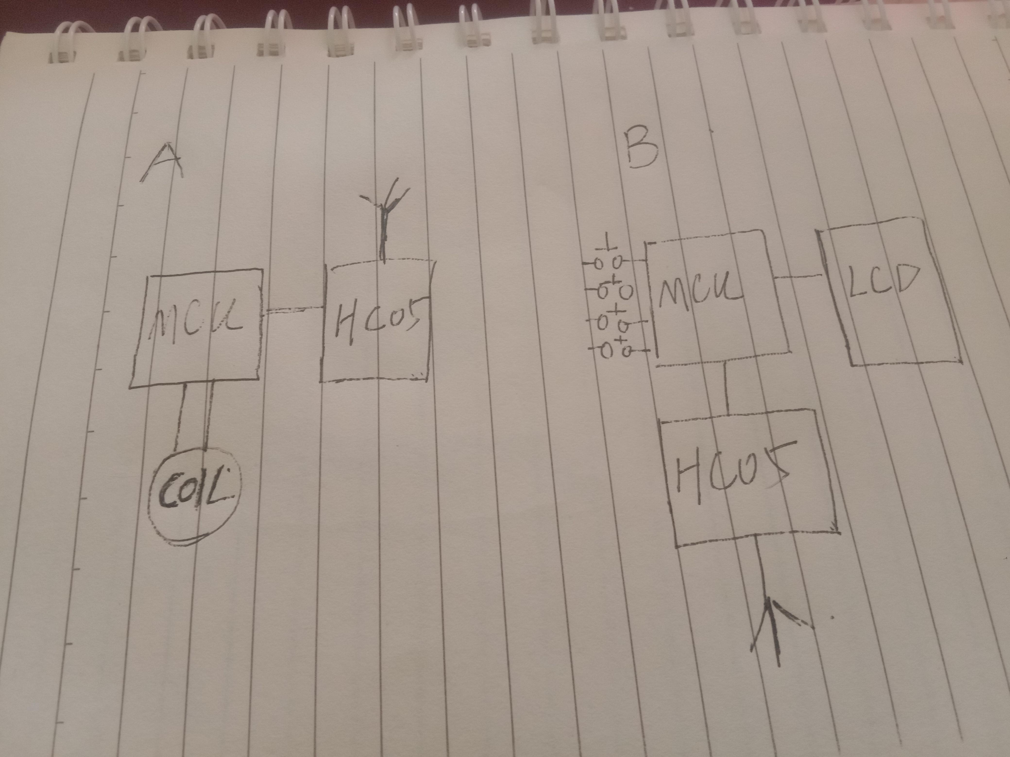

                            I want to divide the detector into the AB section, through the Bluetooth Control A section of the function, so convenient operation, can reduce the volume of the A portion, but I don't know how to design hardware, how to design reasonably, have a love person to help me, thank you very much
                              What I face is that the MCU, HCO5, and the ADC chip use 3.3V power supply, and the op amp is ? 5V power supply, so how to reasonably arrange these levels, how to generate ? 5V
