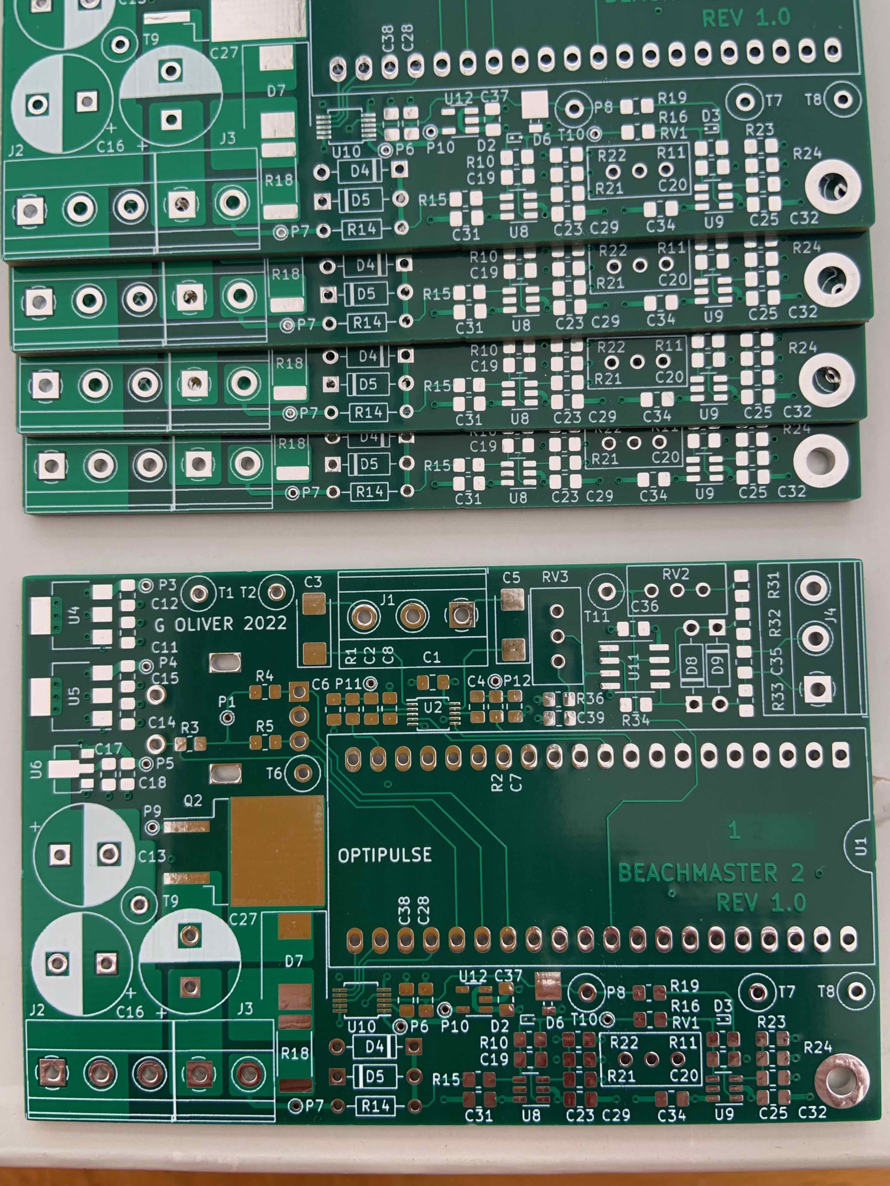

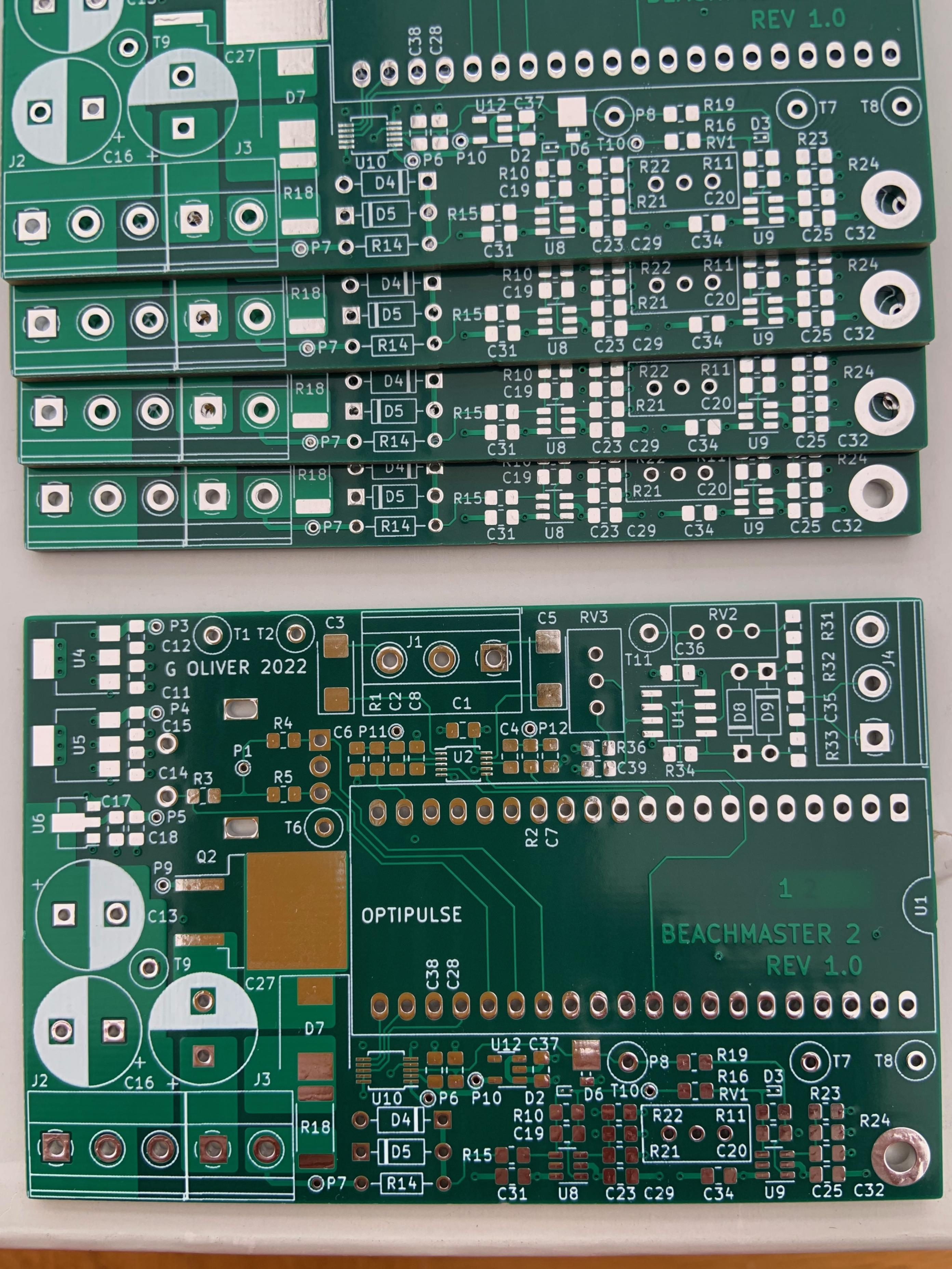

              PCBs arrived, initial checks look good - on to assembly and test - PSU first.

                Are resistors and capacitors packaged in 0805
                • #83
                  Yes, most of the resistors and caps are 0805, but there are a few which are larger e.g. the 47uF ceramic caps are 1206 and the power resistors are 2512.
                  The Tantalums are size A for the 10uF and size C for the 100uF.

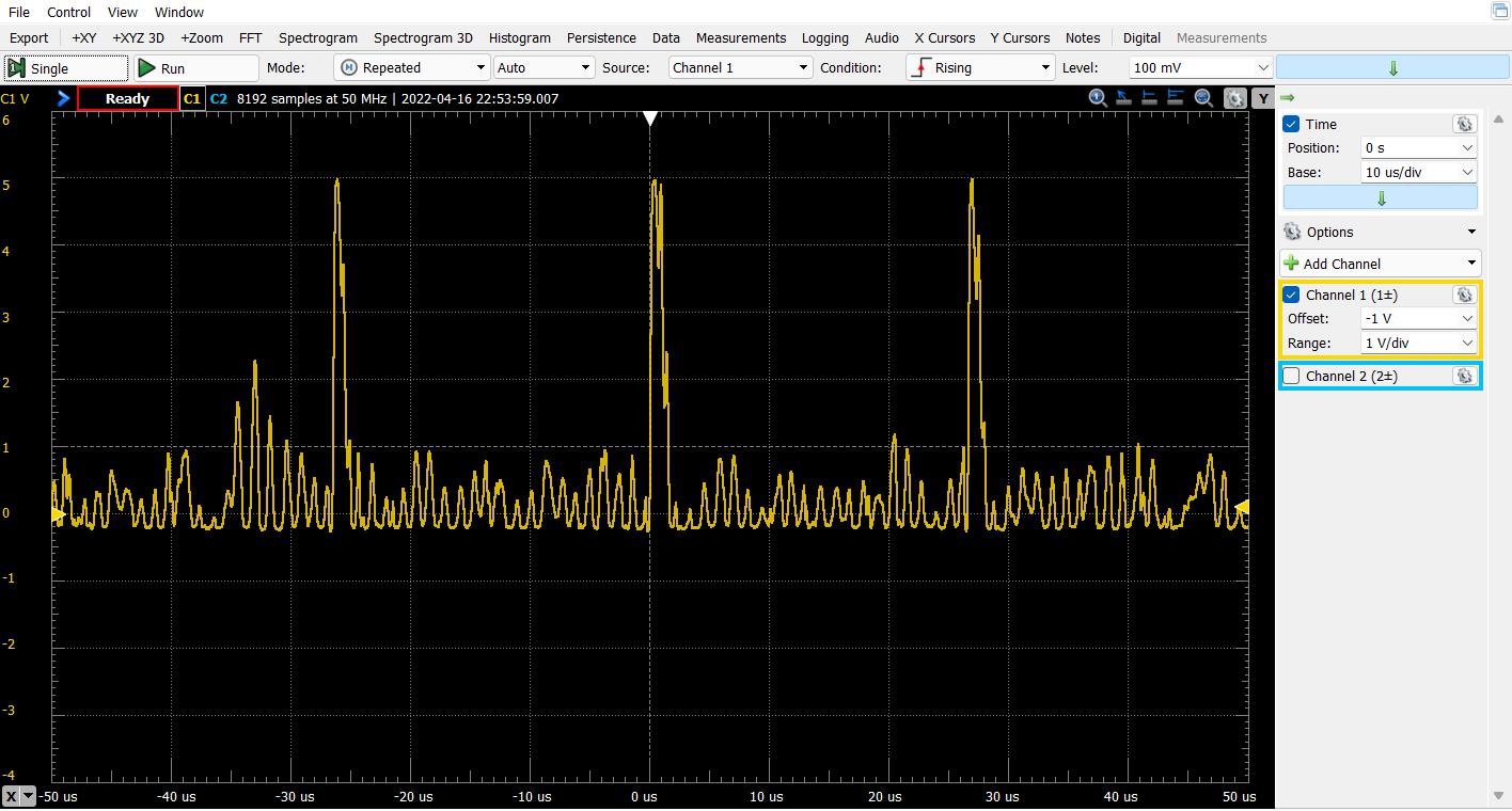

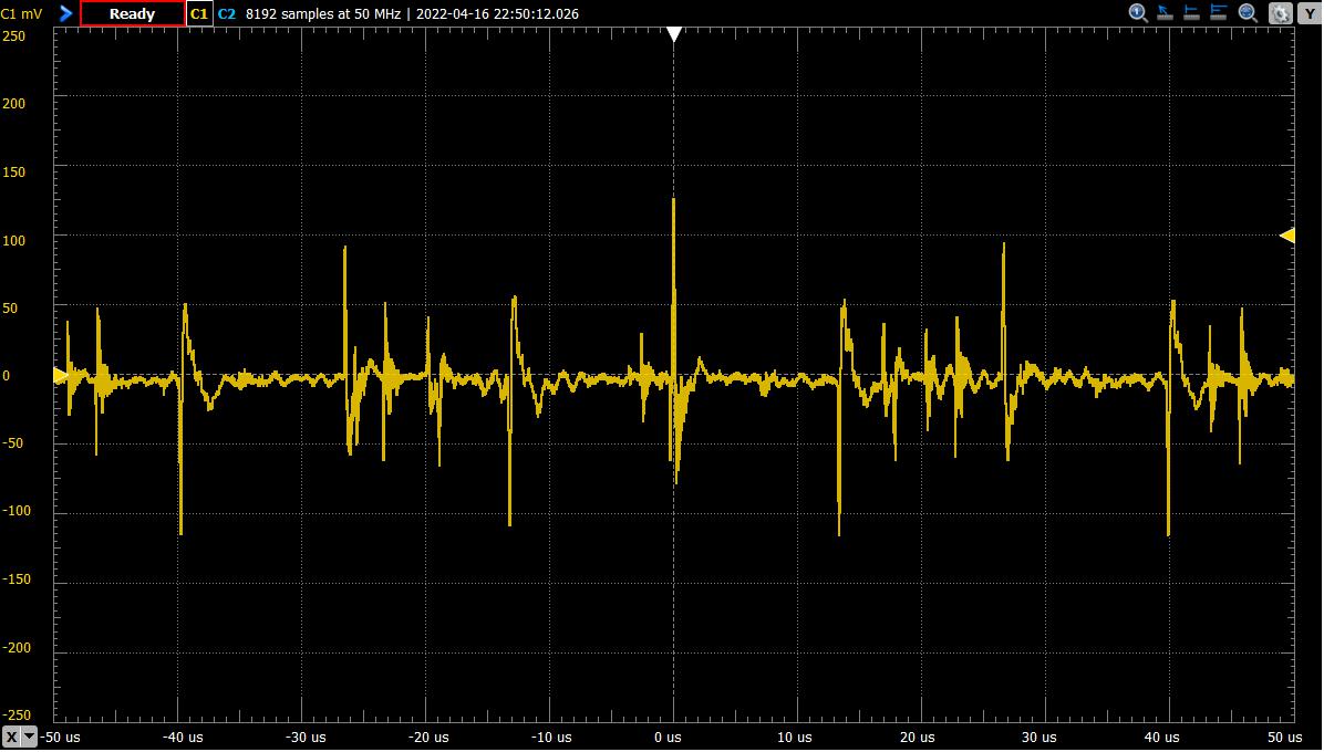

                                External noise source
                                Hit a bit of a testing snag I'm afraid.
                                I've tried to make the preamp as fast as possible but am now running into serious external noise pickup problems.
                                Unfortunately I have one of those radar 30MPH speed warning signs just outside my house and it seems to induce an awful lot of noise into my coil.
                                This is what I measure directly across the coil with nothing else connected other than the damping resistor.
                                And this is what it looks like amplified 1000 times by my preamp.
                                This has not really been too much of an issue before as previous preamps have had a low enough cutoff frequency to not be too bothered with the noise.
                                I don't want to slow the preamp down, so perhaps it may be time to experiment with a figure 8 coil to try to reduce the noise pickup.
