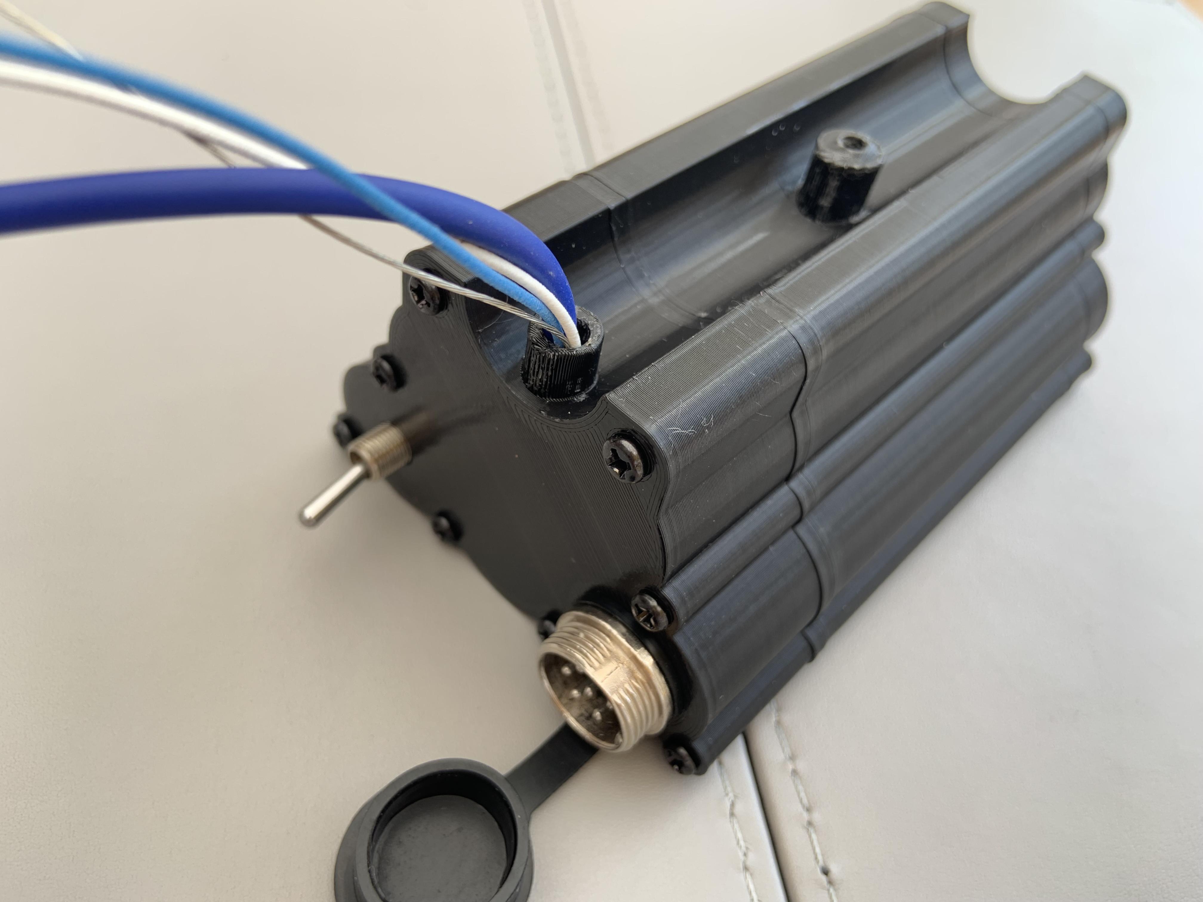

                                Well, I'm back from my nice long holiday but still have lots of mini-projects around the home to keep me busy. That being said I'm still hoping to get the opportunity to work on this project from time to time.
                                This detector needs a 5-cell power supply so thought I'd start out with printing a nice little LiIon battery pack which mounts under the cuff.
                                I've included a switch and connector for balance charging. The wires reach the control box by running through the stem pipe.
