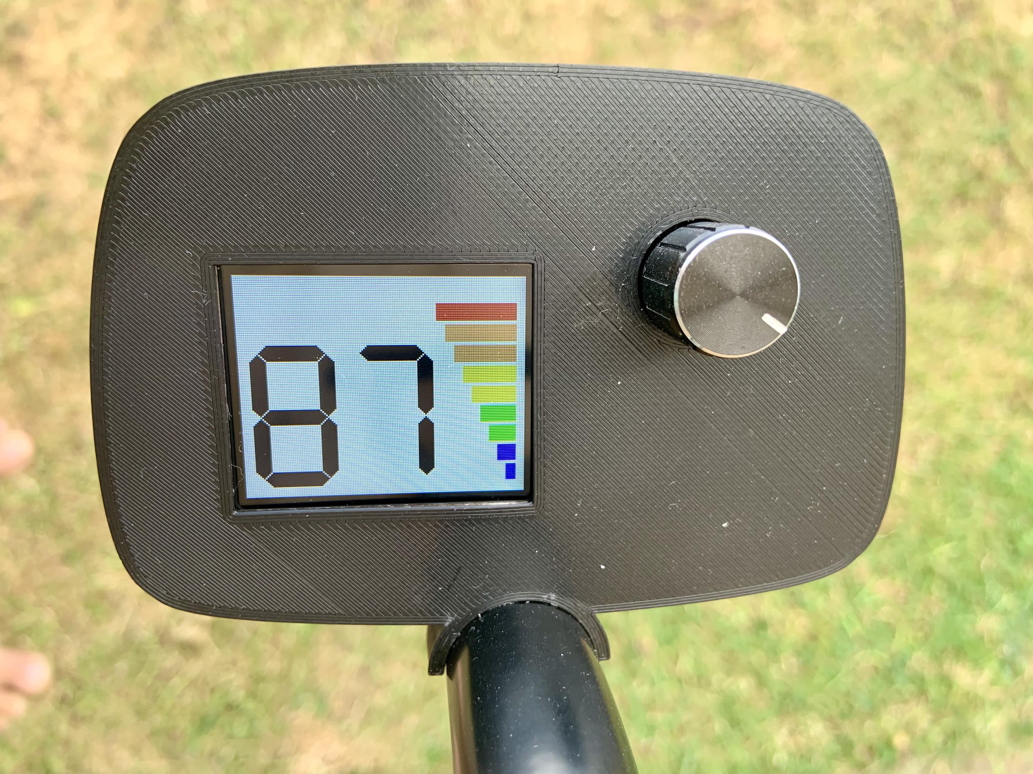

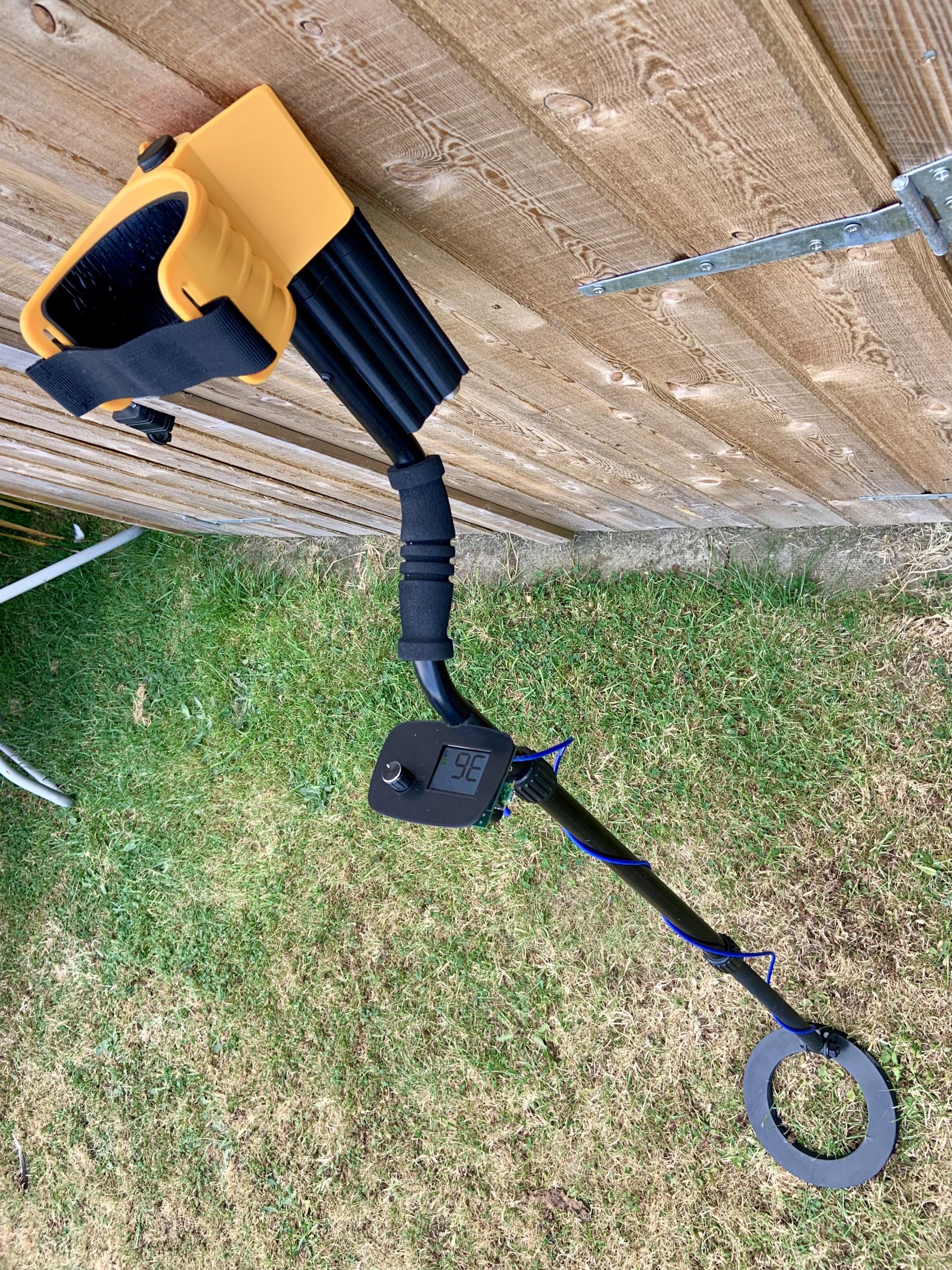

      • A little bit of progress
        I've put together a little experimental platform for testing and software development.
        It's using a 6" 3DSS coil to try and live with the large amounts of EMI/RFI in my area.
        So far I've got the basic Pulse Induction system working pretty well with automatic coil speed assessment and sample window placement. (with the 6" 3DSS coil my first sample is at just over 6uSec) and it can detect a 5mm x 5mm piece of coke can foil from about 1.5 inches. A 1 Euro coin can be detected from around 9 inches which is about as expected for such a small coil.
        I've also been playing with target signal level indication on the display with a coloured signal level indicator on the right and some large digits which will ultimately show the phase shift but for now also show target signal level.

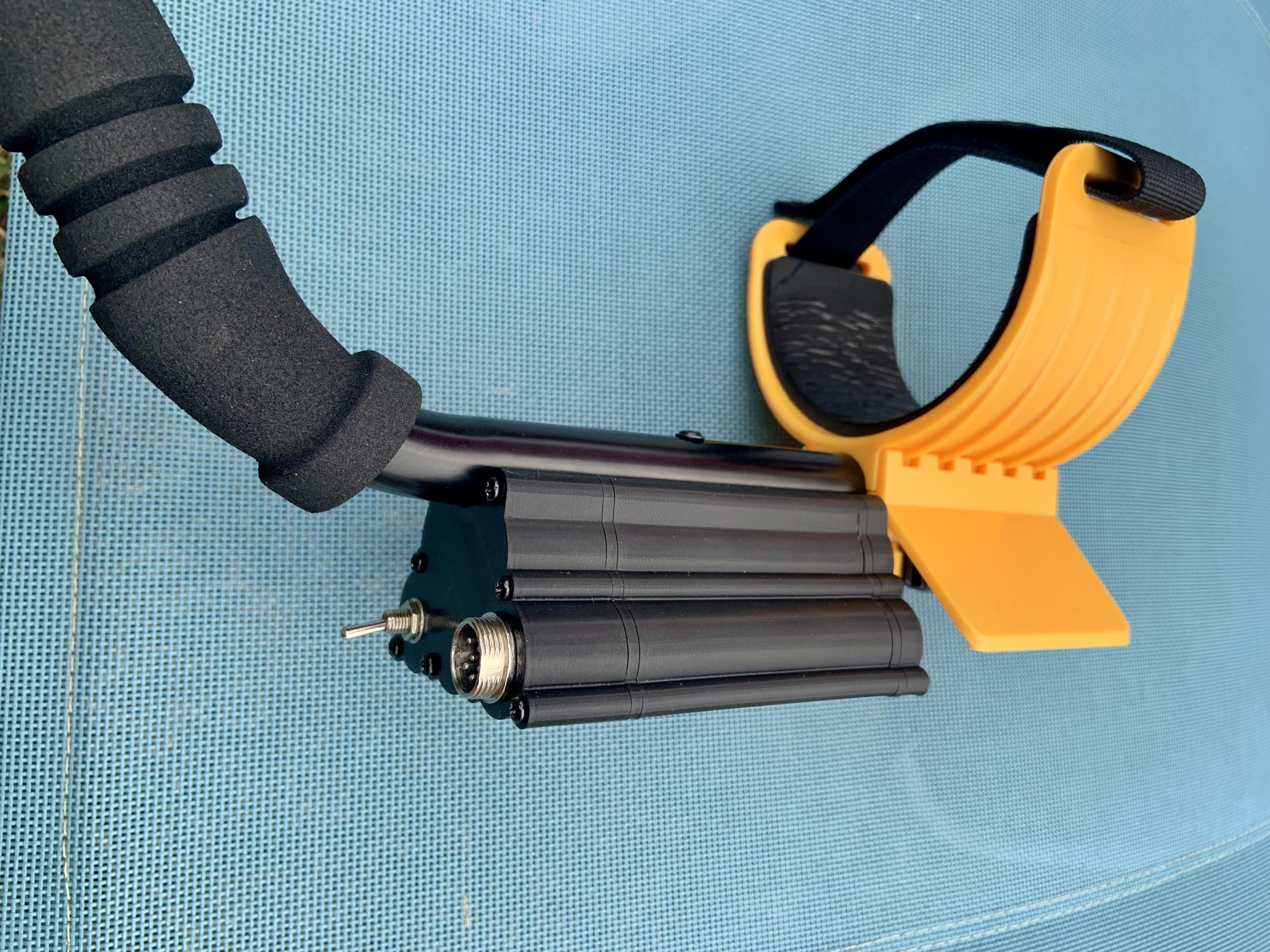

        Finally here is a close-up of the battery pack mounted under the cuff.
        Still lots to do, but results so far are promising
        • Originally posted by Olly View Post
          A very clean print filling the surface... What slicer do you use to prepare the model for printing?
          • Originally posted by Eddy71 View Post
            I use Ultimaker Cura with an Ender 3
