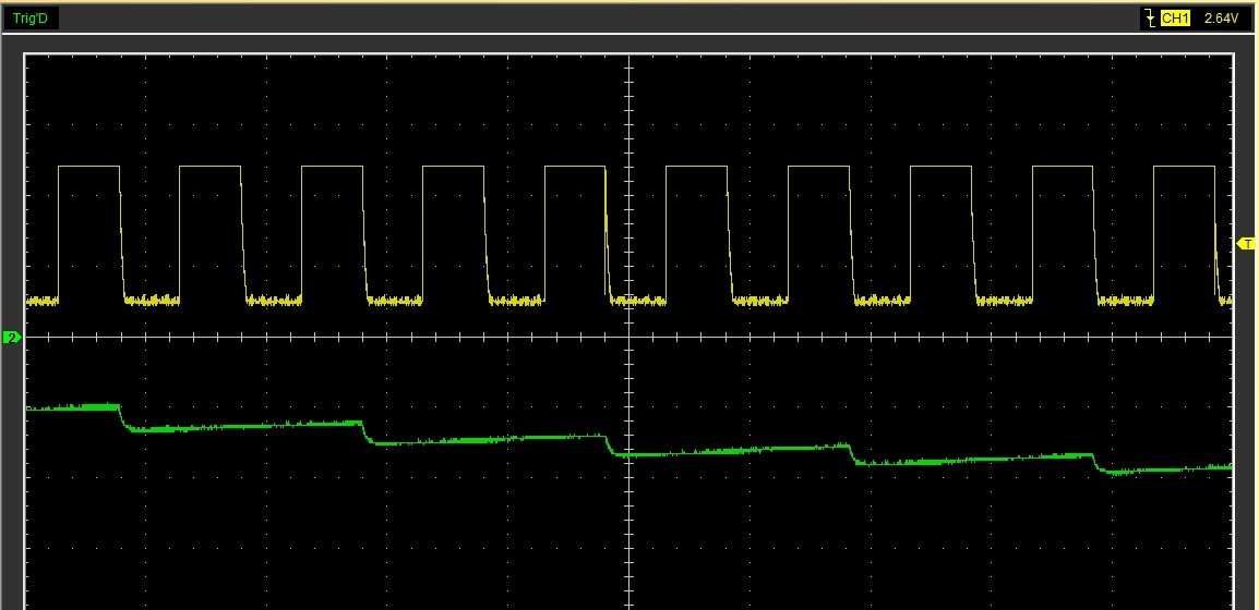

                • #53
                  if you lift pin 7 you get negative voltage just under supply voltage, i breadboarded them but didn't test the OSC all worked fine, i got 2 that worked out of 20 chips
                  • #54

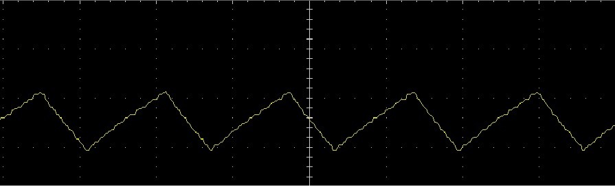

                    the descriptions didn't show the first one is the OSC next is Q1 base from the Arduino clock next is the output of the chip
                    • #55
                      so out of 10 chips i only got 2 working the OSC and Vref are broken or shorted i did further tests they are not fake chips just substandard when i tested them and used a external clock they work as you can see from the diagram, the working ones have saw tooth on the OSC and the Vref a steady half voltage on both them so there internal clock is working
                      • #56
ID:	434376 this is a working internal OSC

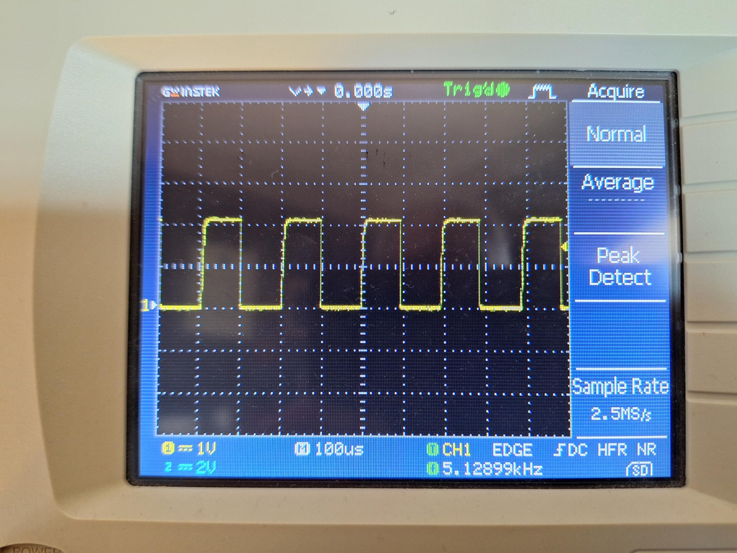

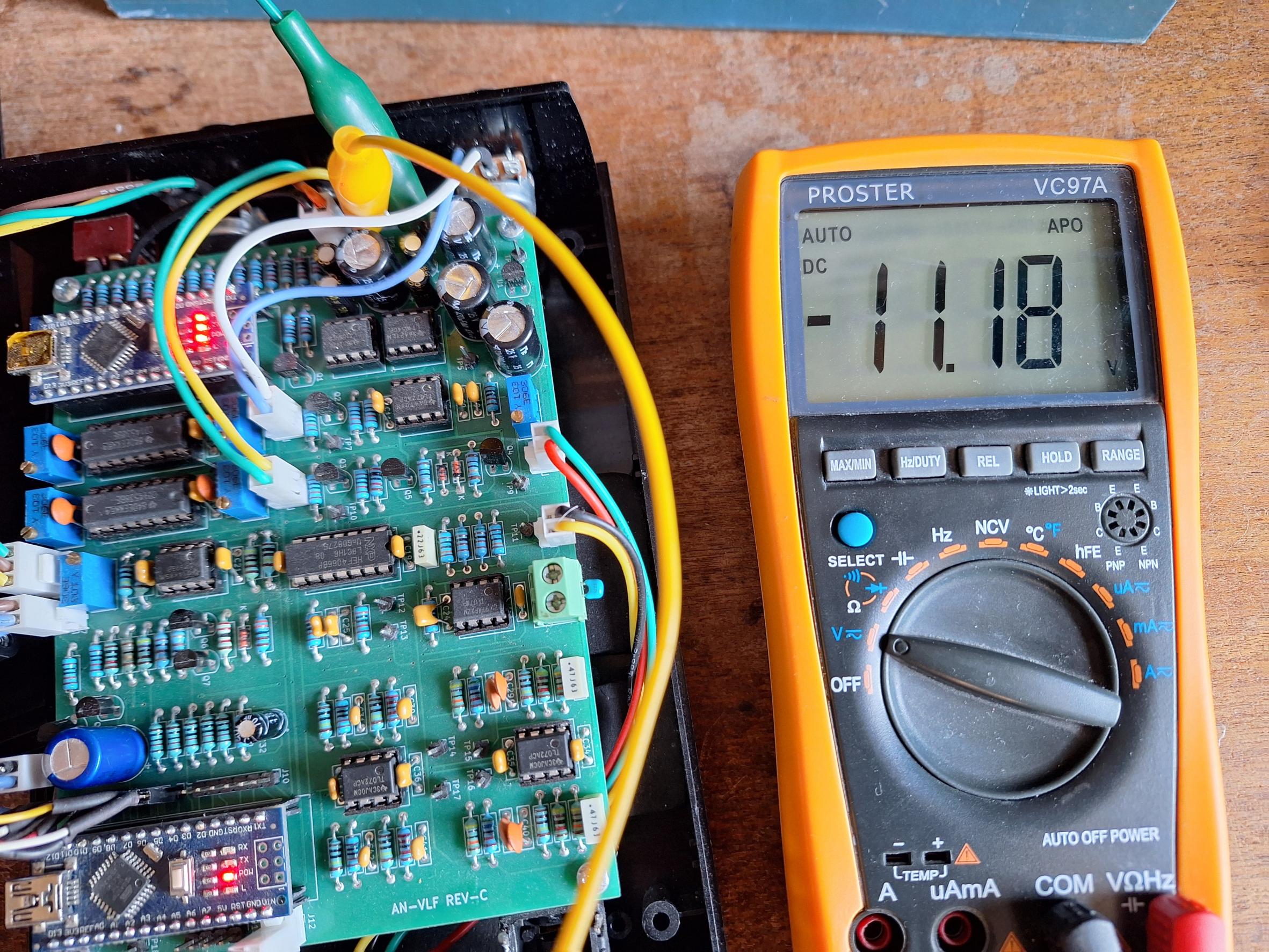

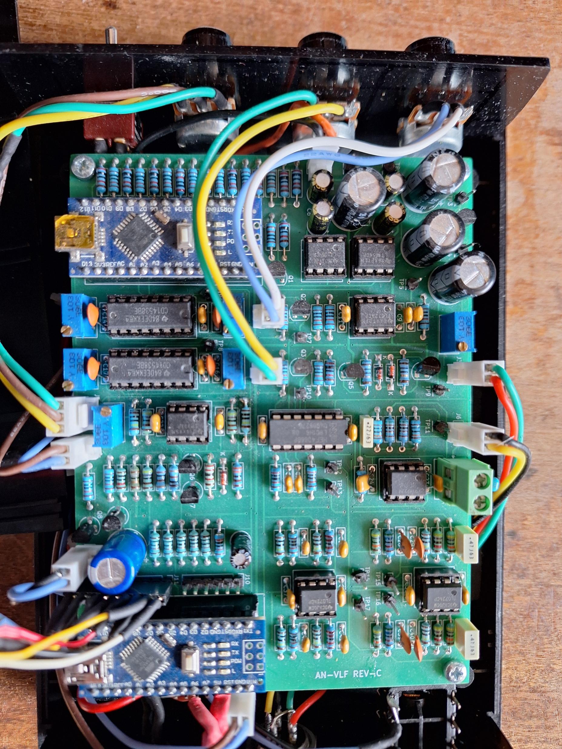

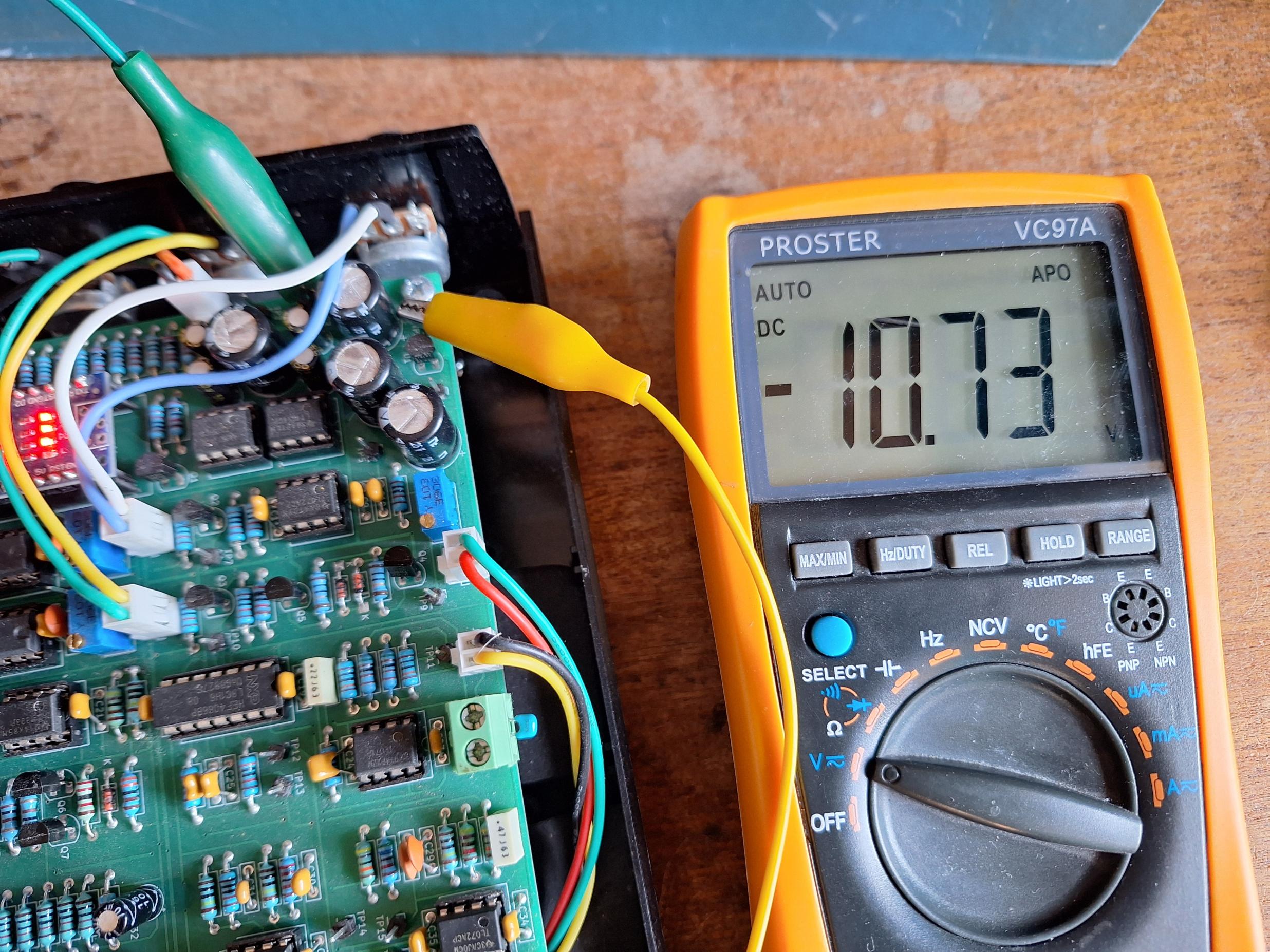

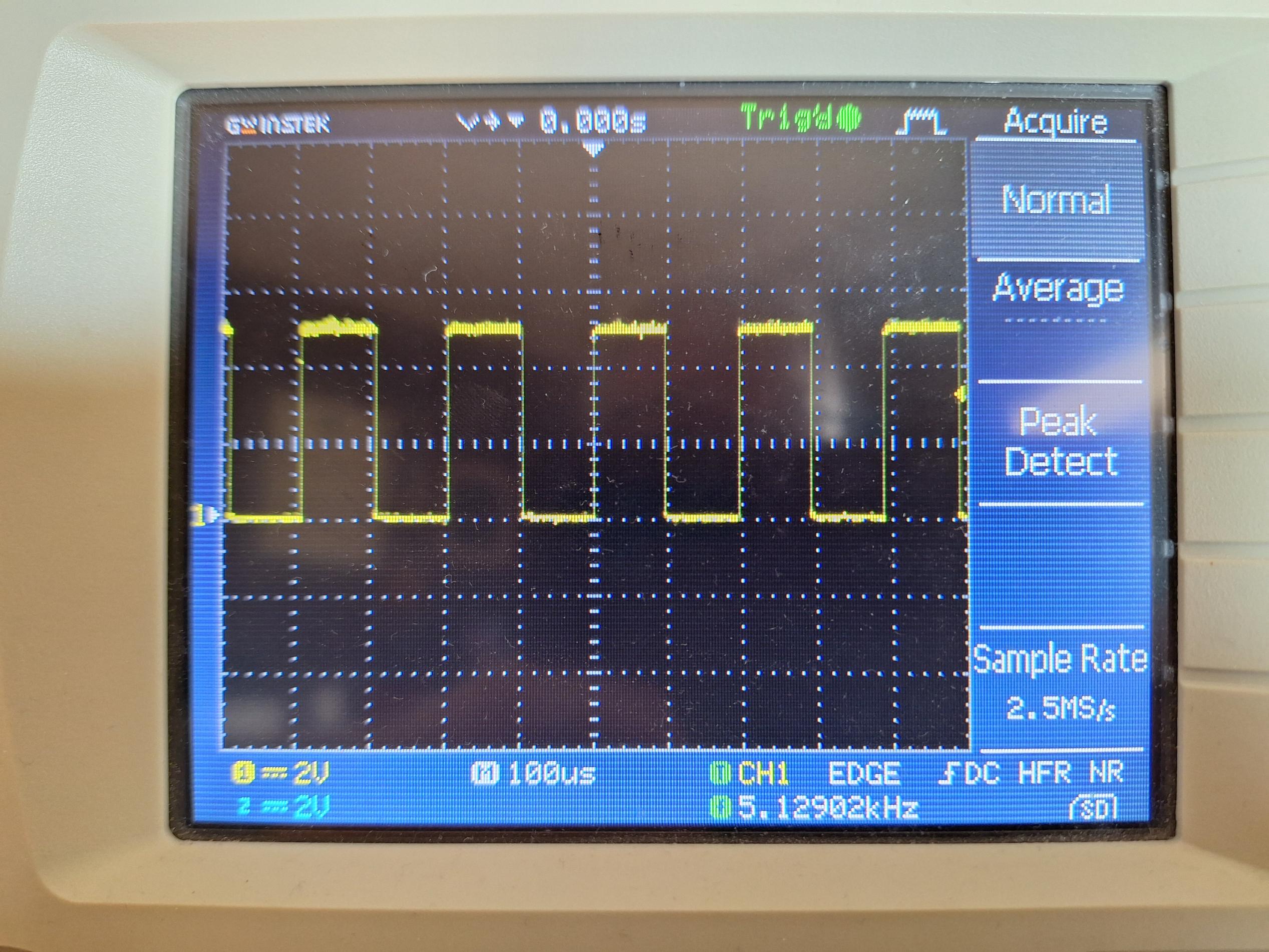

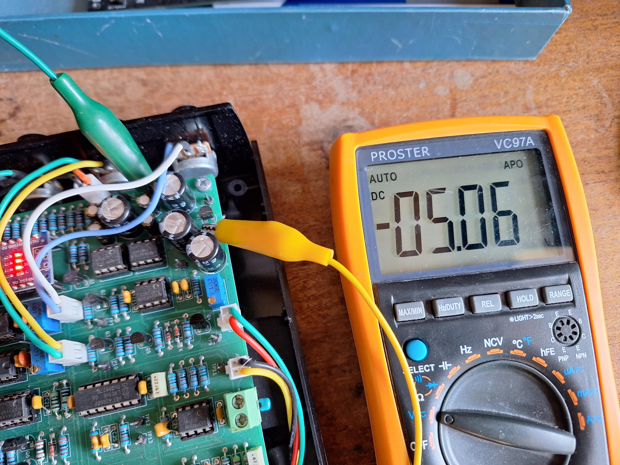

                            • #59
                              ok another batch of LT1054 there is something not right with this build who has actually got this build working ? there is a problem getting the negative voltage
                              • #60
                                I can assure you that the build works perfectly as advertised.
                                To prove this, I have taken the attached measurements today.
                                1) PCB in case
                                2) Voltage at TP2
                                3) Voltage at TP3
                                4) Voltage at TP4
                                5) SYNC pulse
                                6) OSC pulse
ID:	434862 Click image for larger version
ID:	434863 Click image for larger version
ID:	434864 Click image for larger version
ID:	434861 Click image for larger version
ID:	434865 Click image for larger version
