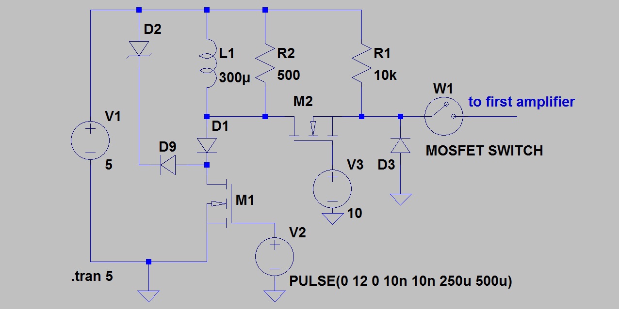

                          ... a variation of my design ...
                          ...the servo loop in the patent can be dispensed with and a fixed bias on the pass mosfet can be used instead as per the following example .... there is a conventional damping resistor used ( because the current sink is not functional ) Instead of using a messy frontend switch to block the flyback voltage we use the flyback voltage itself to do the switching. The 10 volt bias on the gate of pass mosfet M2 ensures it is hard on except during the flyback period ... note that this bias is higher than the TX voltage of 5 volts. D2 and D9 form a snubber which could be 200volts for example depending on the zener value. A high voltage cap in parallel with D2 will help the snubbing function. D3 prevents excessive negative excursions. W1 is the mosfet sampling switch or you could put the amp here .... The main benefits of this circuit are flyback voltage blocking, no need for switching, low impedance path from coil to first amplifier and simplicity and it may be covered by one or more patents.
                            Funny thing is that I once played with a biassed diode bridge limiter which in effect does pretty much the same thing. Big difference though is that diodes' dynamic resistance is not as small as mosfet's so your solution is far better in a serious build. But it may be interesting for speeding up surfs and baracudas where input impedance is not critical.
                              ...this circuit is not quite as good as the full servo loop but still provides superb performance on a traditional pi design.....obviously you can tinker with the component values to optimise further.
                                I smell trouble with this. Reading all this carefully, i'm pretty confident there are some issues whit method described, namely it may not work with real coils in all cases, as in simulation. Issue#1 (main one): this is fine for ideal, lumped element coil, but real coil is distributed parameter circuit, and fastest way to discharge it is by resistive load. Circuit will not “source” energy any faster than limited by natural LC, so cannot be “sinked” any faster with current sink, in effect highly nonlinear resistance during discharge period. Maybe I’m wrong on this, never tried, just my opinion.
