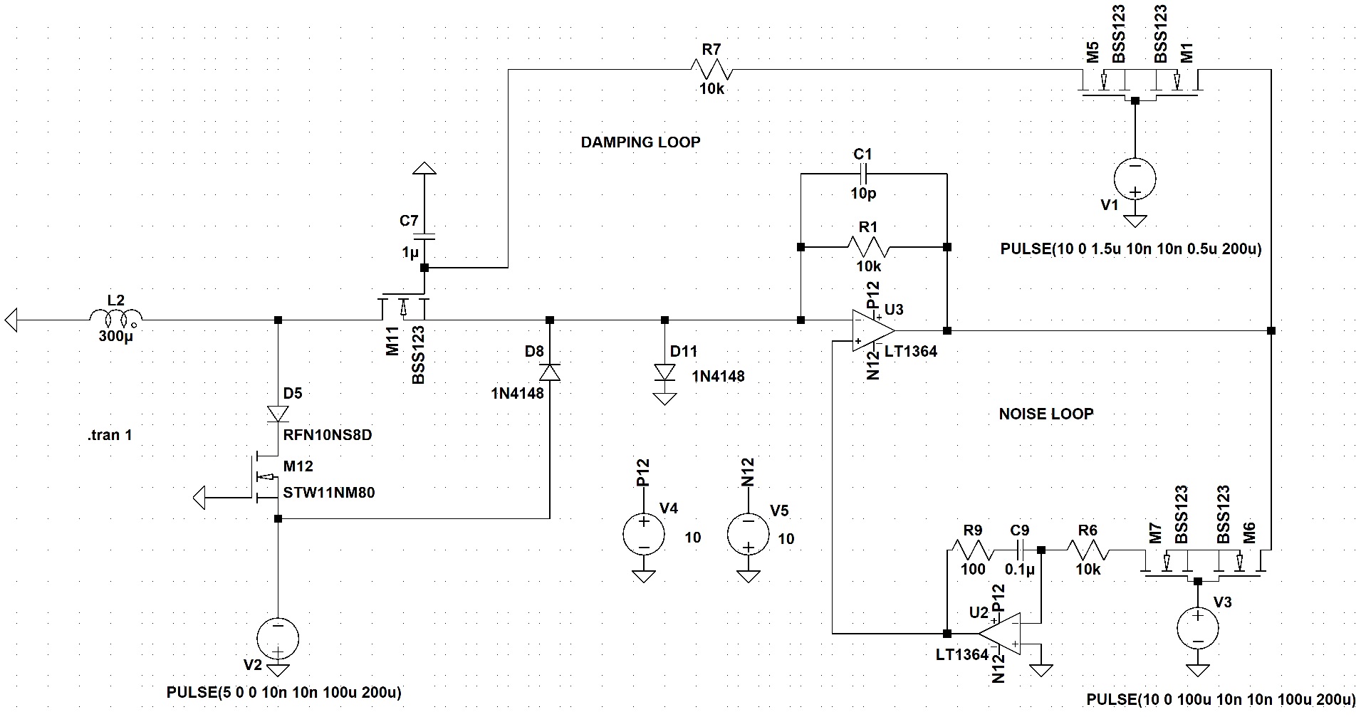

    ZP aka Zero Point damping uses the non linear characteristic of mosfets where for a given gate - source potential the drain current will substantially remain constant even though there are large voltage changes at the Drain.
    This "non linear resistance" can be used to damp a coil faster than any sort of fixed resistance.
    The damping is achieved by a negative feedback loop that samples the "damping error" and sets the gate voltage appropriately. Once the optimal damping point is achieved the gate voltage remains substantially constant.
    The amplifier used in the loop is functioning as a TIA or transimpedance amplifier ( current to voltage ) but is also the preamp for target samples ...
    However if a single feedback loop is used the damping loop can be affected by Earth Magnetic field and Mains Hum .... so a second feedback loop is provide to sample this "noise" and remove it also.

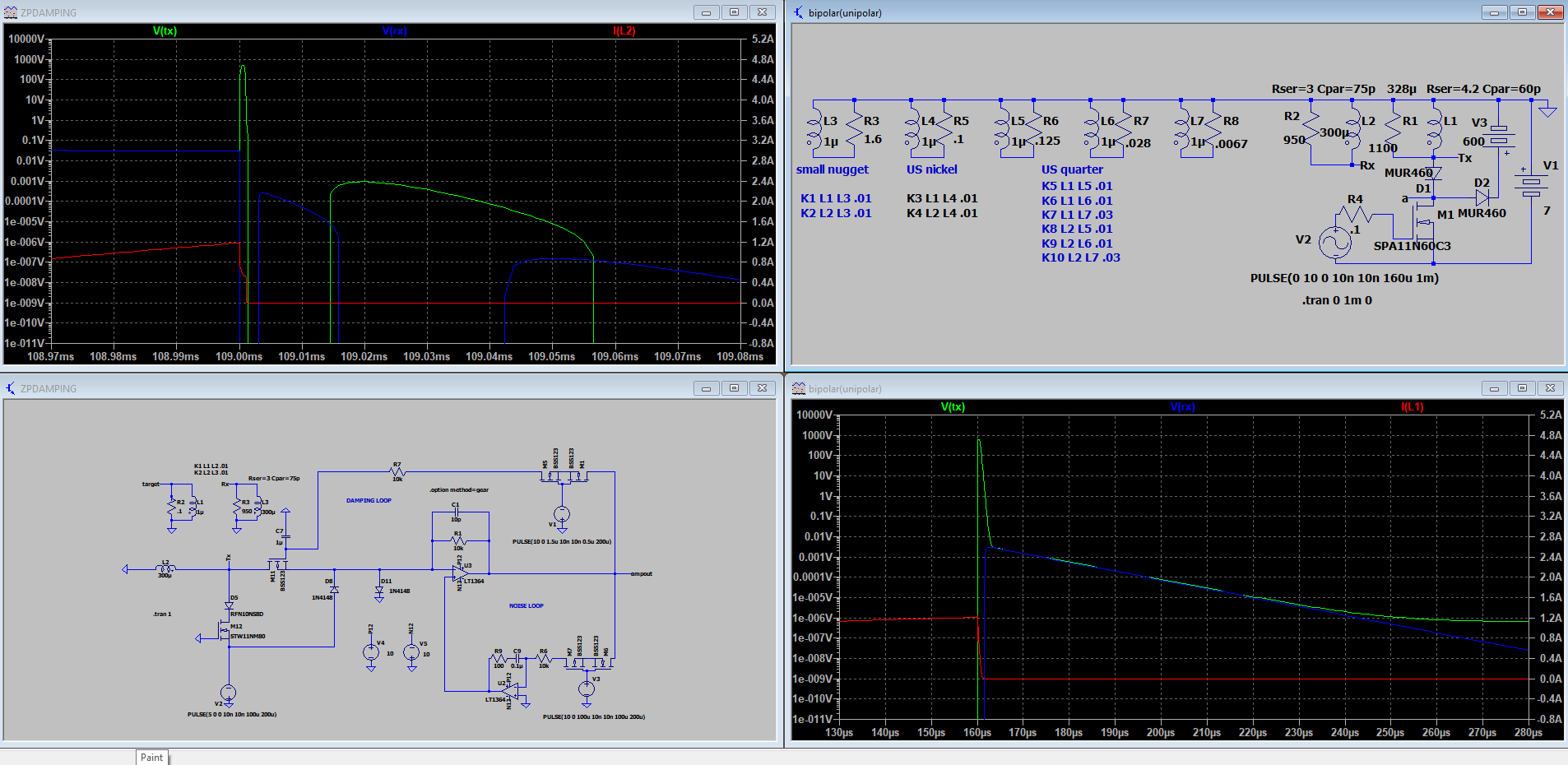

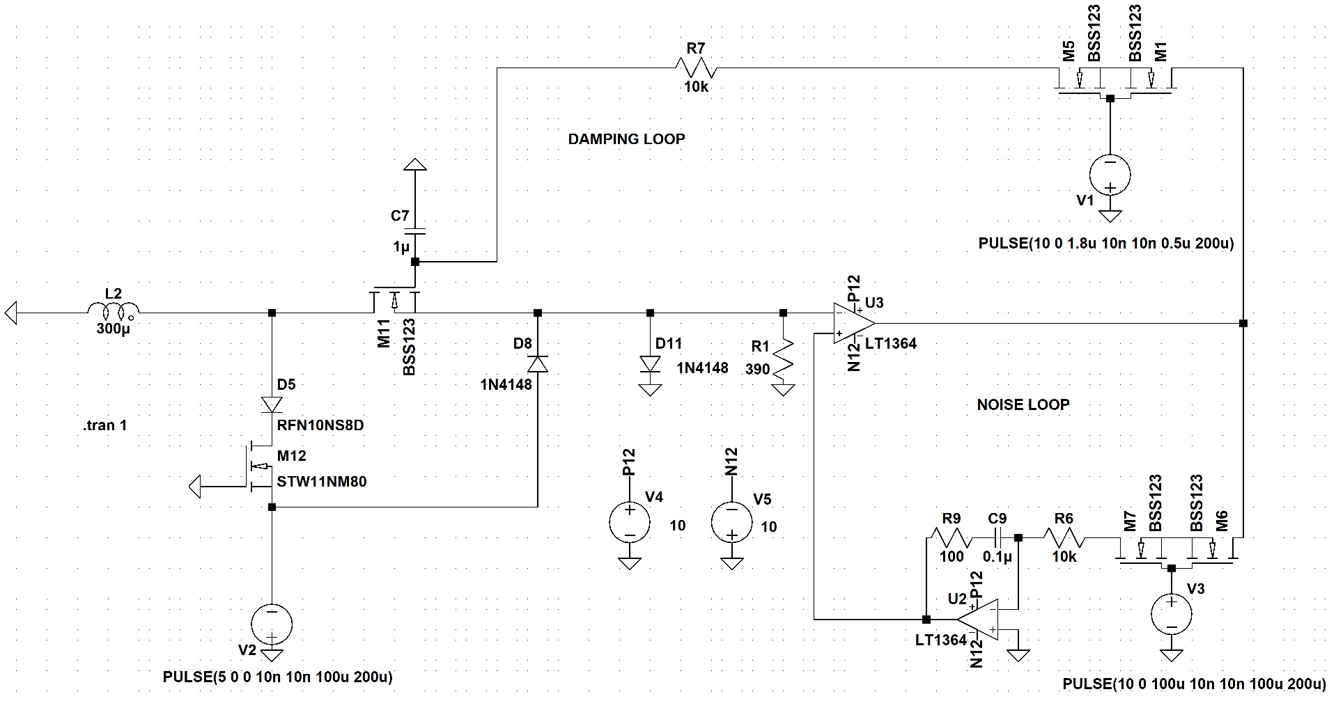

    A couple of variants and a sim file for LTSPICE.

    moodz
    I really like the Idea of ZP
    and I have some questions if you don't mind

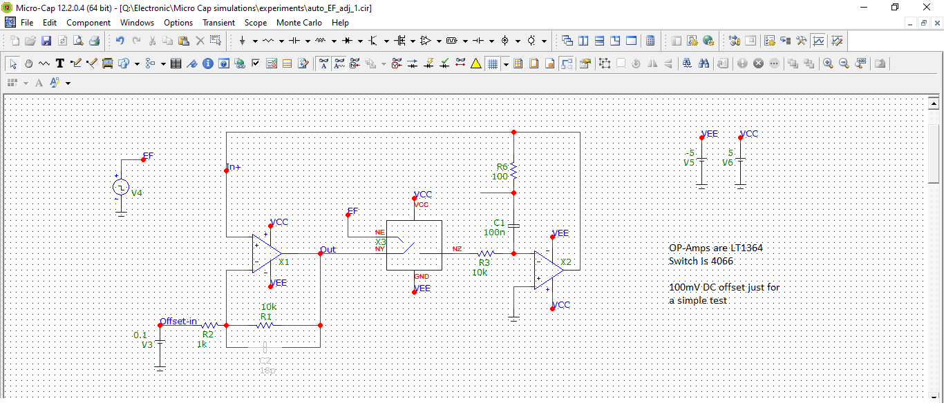

    first about the auto EF adjust loop
    it's a control loop, the op amp will do anything on the output to make two inputs equal
    non-inverting is ground so the output will change until the incoming samples to the inverting input are at ground potential thus eliminating any offset

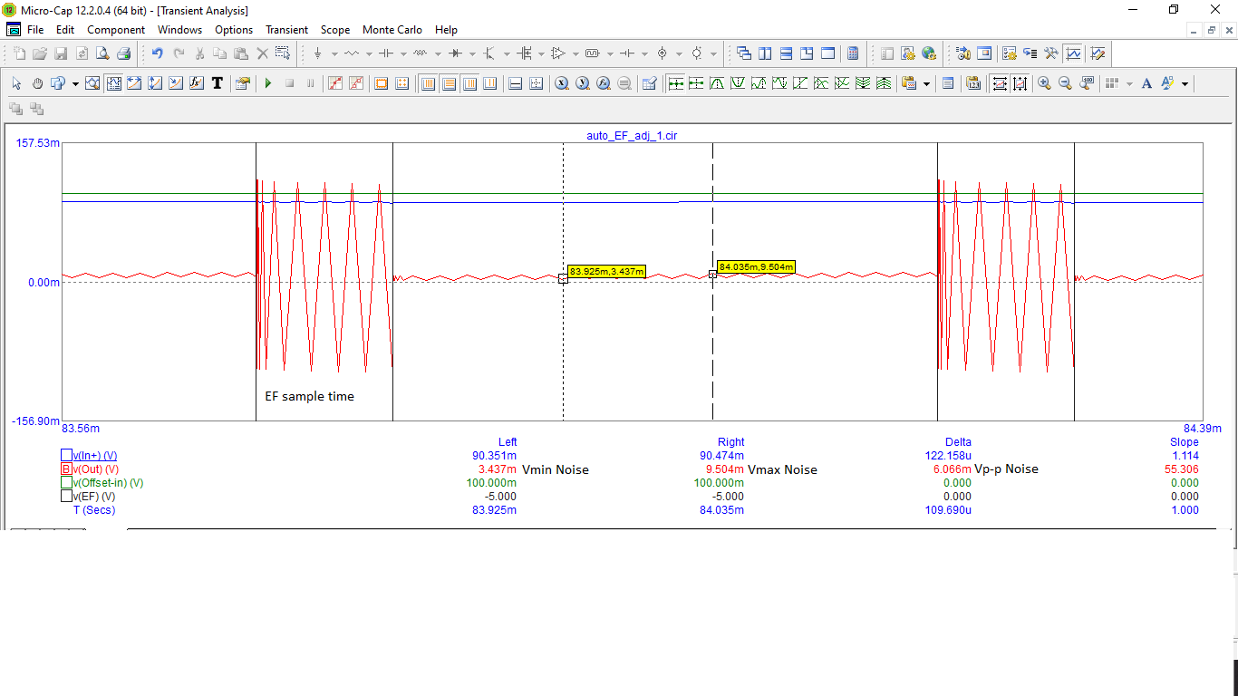

    but the question is; does it produce some noise voltage itself?
    I ran same simulations on that and i can see some bad triangle noise

    could that be the opamp is trying to keep the output at desired value thus hovering around it and making this noise?
    op amps are set to "Boyle model" in the simulation so they are as close to real world as possible
      Might be a simulation artifact. The default integration method is trapezoidal, try setting it Gear instead. In Spice this is done with the command:
      .options method=gear
      I don't know how to do it in MicroCap.
        it was exactly the same command in Micro Cap
        it's real clean now and works very nice
        you're a lifesaver man thank you again
        now what could be the purpose of 100R resistor in series with integration cap? sets a minimum gain for high frequency noise maybe?
        can't see any affect in droop or noise in my oversimplified simulation
          The output impedance of a bipolar opamp is generally inductive because of the beta roll-off of the output devices. So it's not a good idea to drive a purely capacitive load, some series R will improve stability.
            strange for me
            any current through that capacitor has to go through input resistor (10K) since input of both op amps are ideally infinite
            i was thinking that the input resistor will prevent the op Amp from any type of oscillation

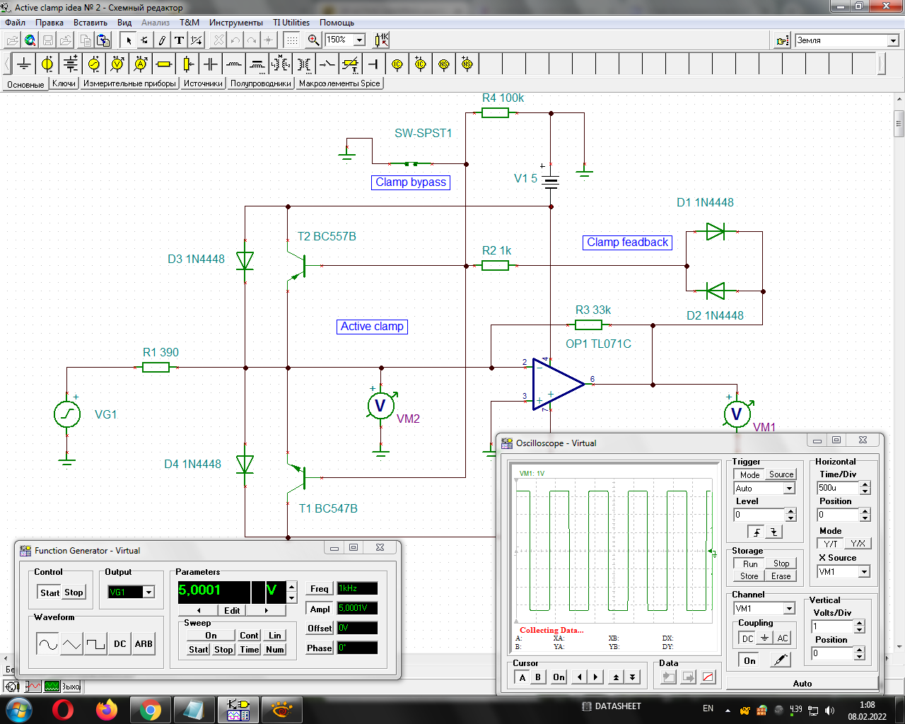

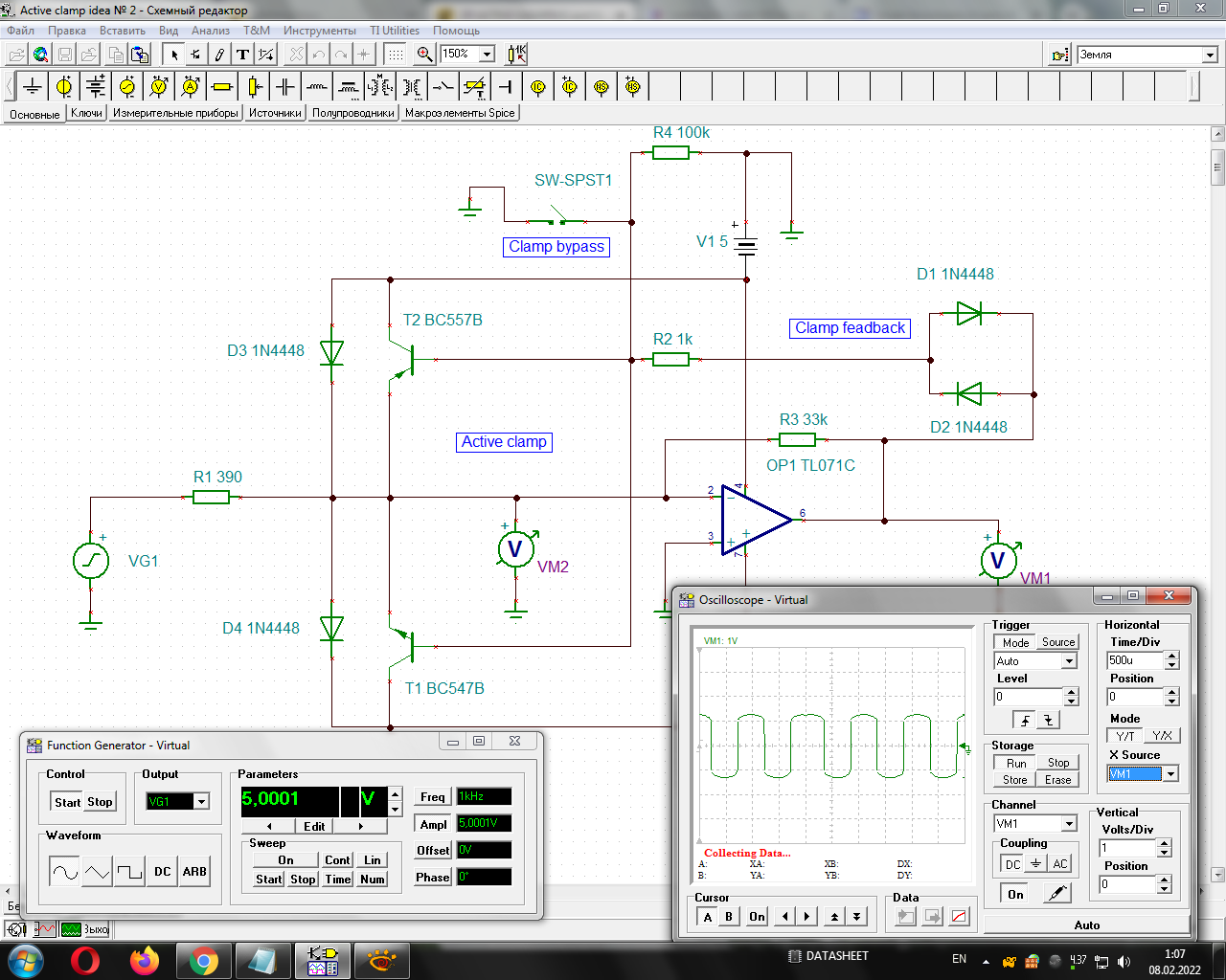

                    Heres my idea for active damping, tested last year in software.

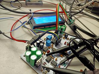

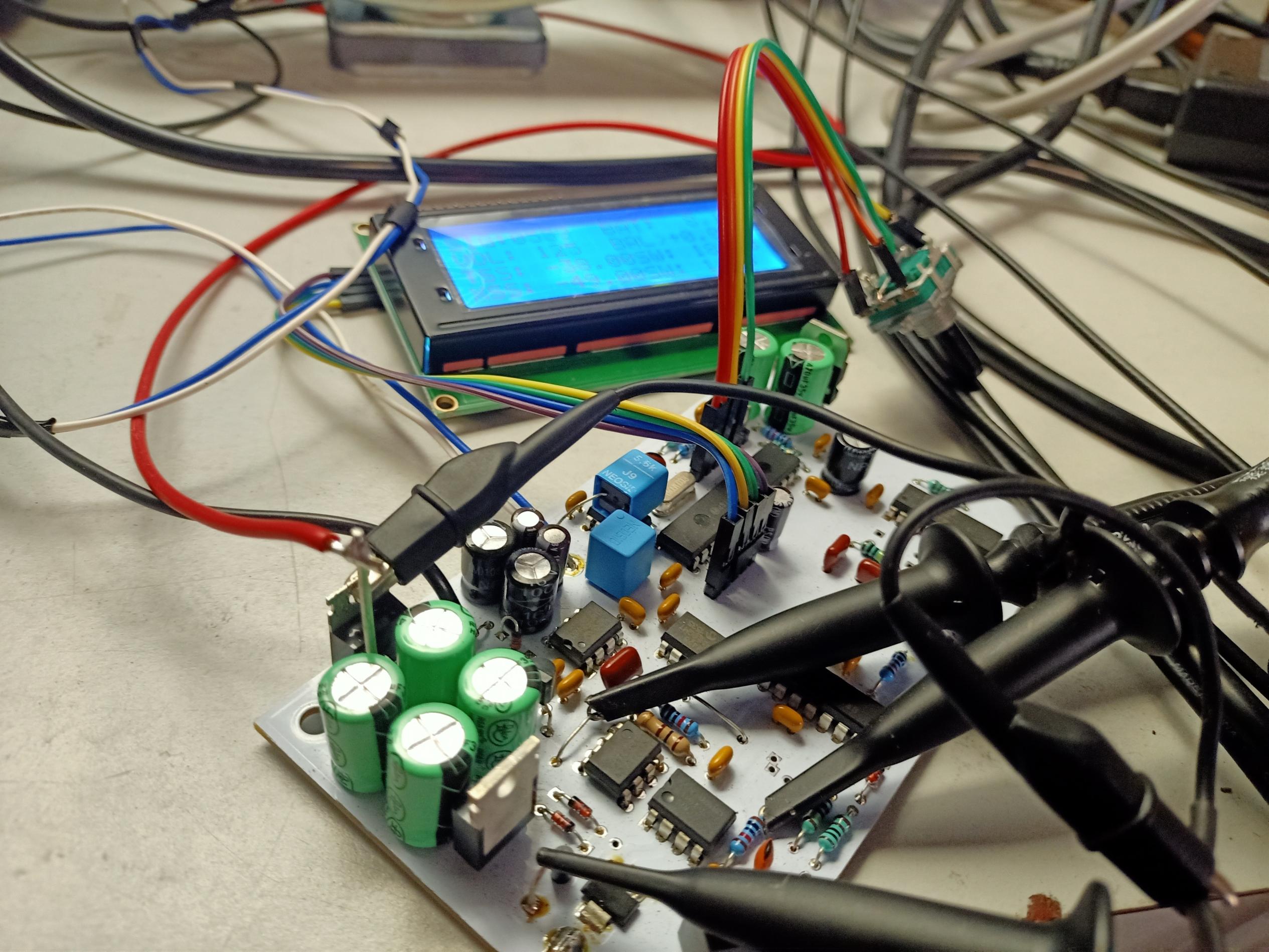

                      Procastination is the biggest enemy of progress and so is too much time in front of the simulator .... so I had some boards made to test the ZP damping theory nearly 3 years ago now but only just built one of them up ( properly ... there was an earlier one but that is another - interesting story ).
                      Anyway to cut a long story short the assembly is complete and except for some minor tweaks to the source code for the PIC controller was able to obtain good results.
                      For a simple thruhole design with just 1 SMD transistor ..

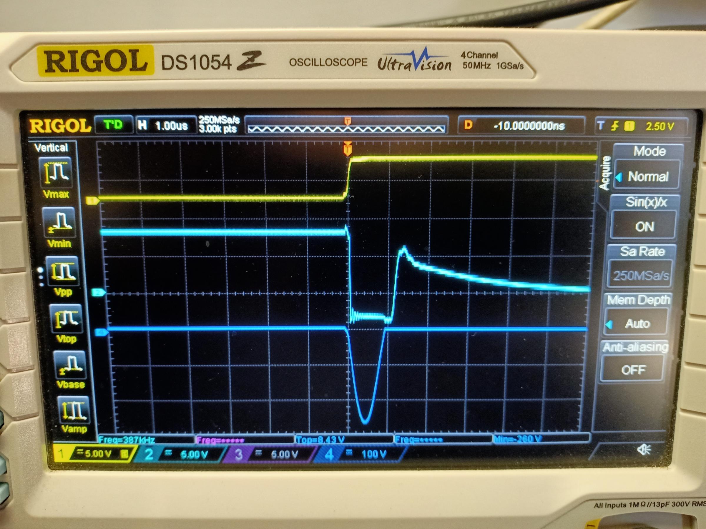

                      Excellent damping of the flyback in under 1 microsecond from a 260 volt ( negative going peak ).

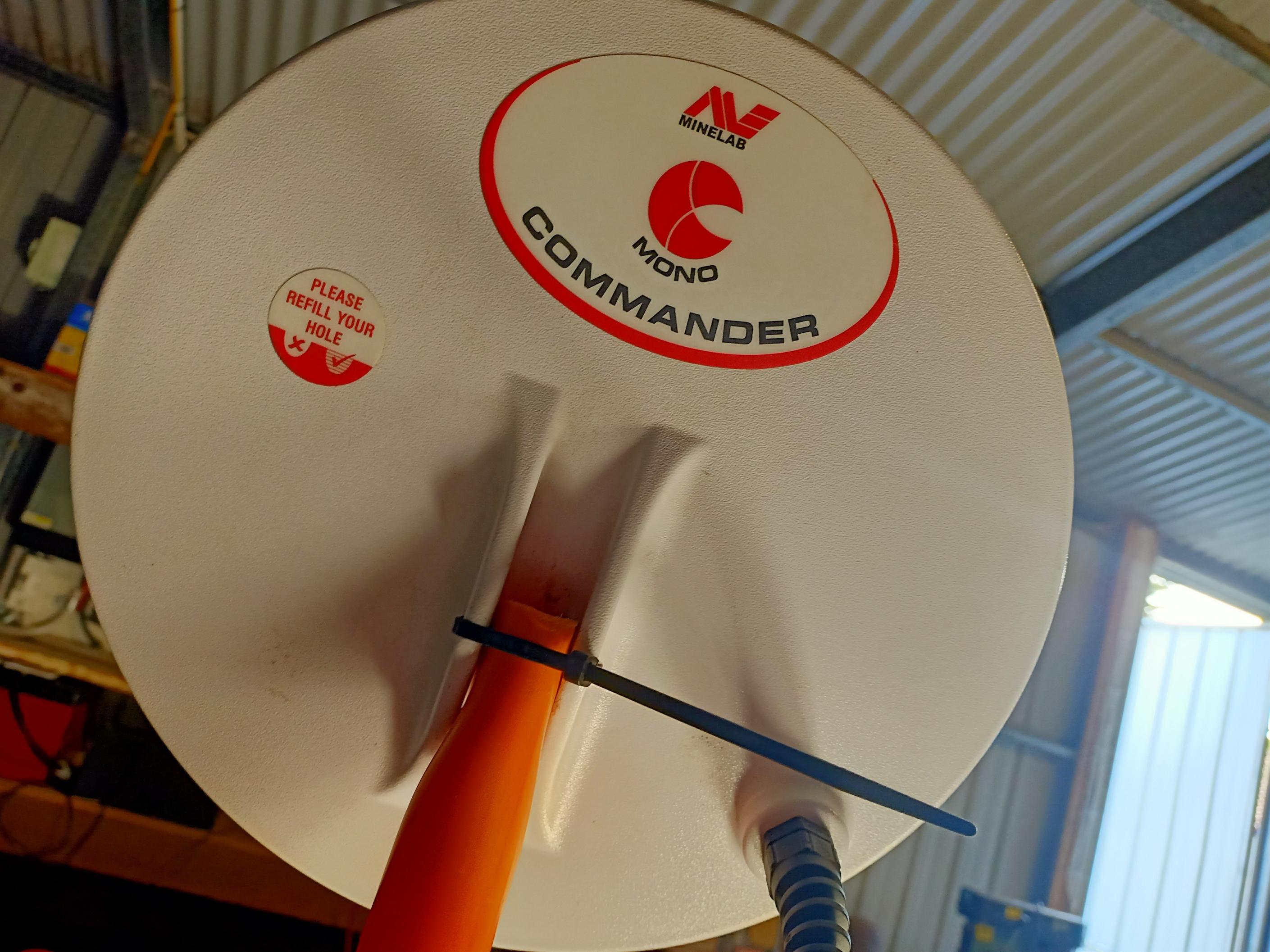

                      Excellent Ferrite , EF , mains EMI rejection. Rejects hot rocks that fool my GPZ7000.
                      Detects .05 gram nugget at 1 cm in air. Detects 10cm x 10 cm foil target in air at 1 meter. Using a minelab ( 10 inch ? ) monocoil.
                      No controls to tweak .... there are several settings to adjust for factory baseline in the optional LCD / rotary encoder but not required for operation - feedback loops handle everything.
                      Runs of two lithium 3.7 volt cells or 12 volts ext. ( @ 250 ma max )
                      First pic below ...
                      Yellow is TX control ( high is off )
                      Light Blu is preamp o/p ( gain = 1000 approx )
                      Dark Blu is flyback measured directly off coil -260 volts peak ( no snubbing or avalanche in normal operation )
