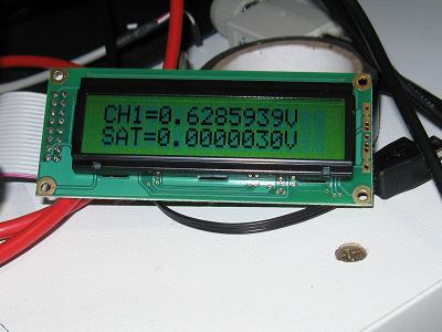

    The latest update is that the SAT is working and available for all channels ... The pic below shows the SAT in action and tracking with a 20 second dwell and a 30 microvolt deviation. Its probable I wont need this sort of accuracy as noise from the coil will be higher ...eg 100s of microvolts ... we will see.

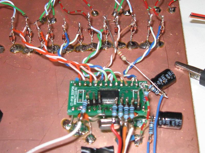

    The other pic shows the ADC on the "test bench" where all the code cutting and probing is done ... not exactly your low noise lay out but certainly good enough to achieve microvolt accuracy and clock the data out at 10 mbit/sec.

    • ...correction that is a 3.0 microvolt deviation on the SAT not 30 microvolts.
