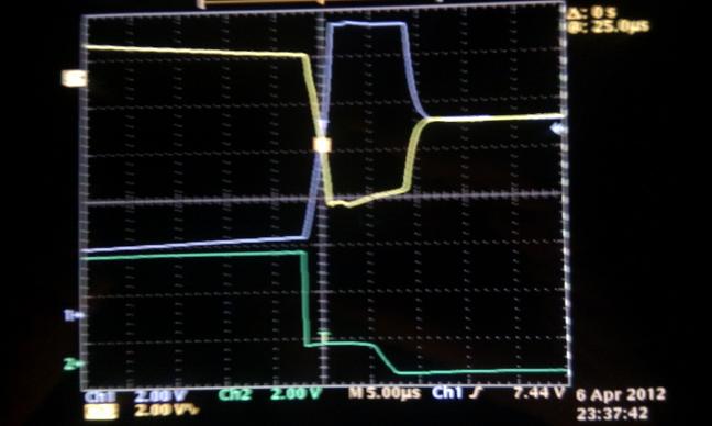

                        • ...revisit the blocking FETS
                          I said I would revisit the blocking FETs and the problem with blowing them up all the time is solved ....
                          ... I will give it a good testing prior to publishing anything ...
                          ... below is a pic of the blocking FETS in action ( scuse my camera shake ) .... neatly snipping the top and bottom off a 500 volt peak flyback with perfect tracking of the base line signal voltage. The coil used here is an 18 inch differential coil. No amplfication .. we are sampling directly off the output of the blocking FETS. The dynamic range and sensitivity is an order better than with crowbar diode blocking The flyback is neatly blocked to a 8 volt peak to peak signal ... so it wont blow the input to the sampling demods .... . the neato thing is that the blocking FETs draw almost no current when blocking .... unlike diode crowbars.
                          The white trace is the +ve flyback ... the yellow trace is the -ve flyback ... the green trace is the TX mosfet gate drive signal.
                          moodz

                          • great news moodz!
                            I'll be looking forward to giving it a go!
                            Philip

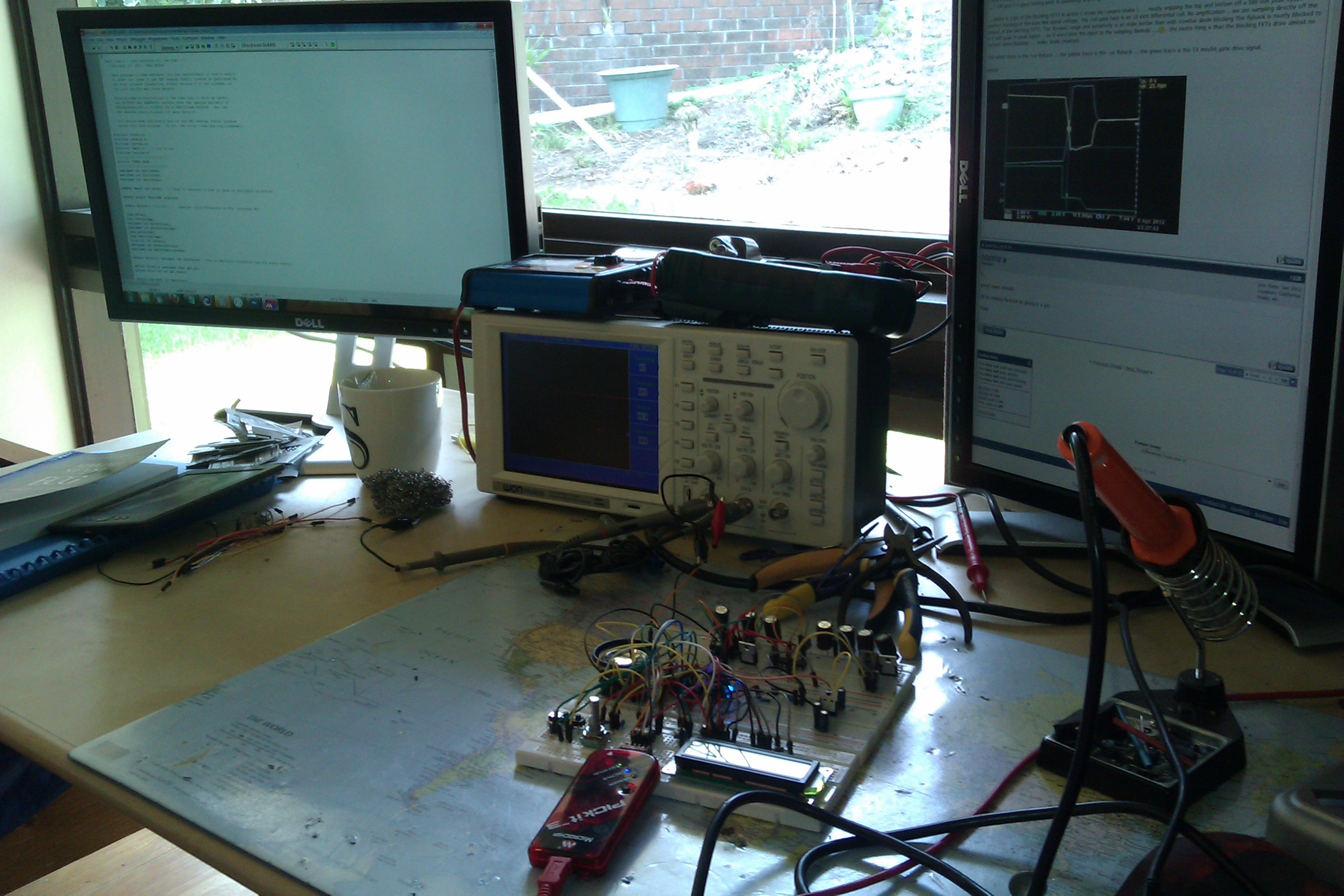

                            • The dsPIC30F4012 code worked first time! Pulse waveform easily controllable with the rotary switch setup. Nice. Just waiting for matched FETs to arrive before rigging the differential stage. Interesting project Moodz, can't wait to see how the benchmarks turn out on coins and rings. Does anyone have any preliminary benchmarks (eg. an Australian $2 coin at 19cm in air).
                              Planning to eventually identify a set of parameters (eg pulse width, gain parameters, etc) and algorithmic control variables and put them in a genetic algorithm / neural network optimizer. Hopefully I'll be able to share some good parameter sets that will be tweaked for specific target sets eg a coin set, a gold set, a ring set etc. The fitness function will comprise of a complete system simulation involving moving parts! Two stepper motors will be connected to large (1 meter) wooden wheels that rotate parallel to each other and are spinning in the same direction at slightly different speeds. At equal spaces on the perimeter of each wheel will be tied a combination of good and junk targets (eg bottle caps, rings, coins, tabs). The coil will be positioned a few inches away from the perimeter of the wheels so that as the wheel spins, new targets will automatically applied (come in range) of the coil. Note, because there will be two wheels different combinations of targets will be presented to a coil to simulate the situation where a good target is coincident on a junk target as well as an isolated good and an isolated junk target. A "fitness" evaluation of a sample parameter set will be an assessment of the ability of the system to positively identify good targets and to reject interference and junk targets. Of course, I'll share all code. Will probably have to run the code on the PC and commicate down the RS232 line as genetic algorithms consume considerable RAM.
                              Good collaboration.
                              Simon
