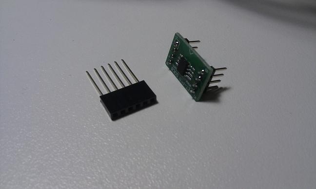

        Mounting the blocking FETS on a small plugin module should an unfortunate event occur .. changing the module is much quicker than soldering ...... also it allows trying out different types of FETS and diodes.

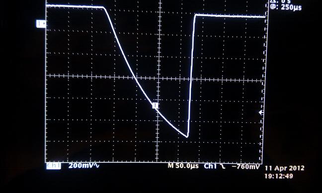

        The coil current reaches 4.6 amps peak in a 260 uH coil .....the mathematically gifted readers should be able to calculate the peak flyback
        Below is the coil current sampled across a small resistance.
        and now THE DILEMMA....in order to prevent the blocking FETS from self destructing but without inhibiting the blocking action ( which is excellent BTW ) the use of a Tank Capacitor was required with a very unfortunate side effect that it builds up large charge ( in the order of 600 volts ). This is enough to give you a severe shock or worse ... I realised this when I accidentally touched the cap myself. The second problem apart from the danger is that this voltage cannot be simply discharged as the high potential is required for the blocking protection to function as it should.

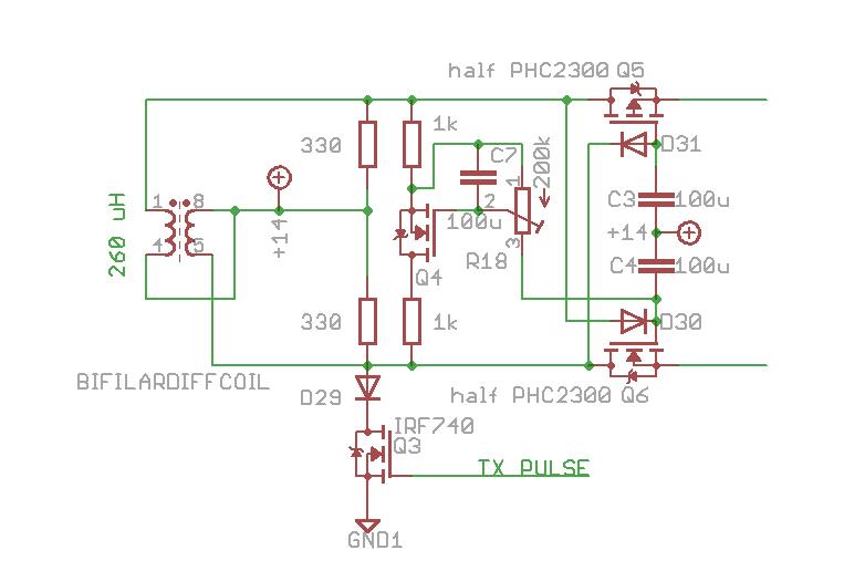

                • BLOCKING FET FRONT END
                  ...dilemma solved .... I wont include the protection circuit .... the blocking fets will not blow if the circuit below is utilised and ... TX PULSE must not exceed 100 us ... this allows a healthy safety margin by limiting coil current.
                  The circuit has been tested and verified ..... works like a charm.
                  moodz.

                  • that's pretty clever
                    if I'm understanding it correctly, the 330 ohm resistors are used as the primary damping , and the 1k/Q4 acts as a fine tune damping circuit with the adjustment of R18.

                    • Originally posted by hdphilip View Post
                      It would be insteresting to see the different waveforms, no target/ ferrous/ iron
                      Philip
                      Thanks ... You are right about about the damping ....oh and I did not indicate that the damping MOSFET Q4 is an IRF740 and all diodes are 1n4004 ...no fancy parts required LOL.
                      R18 should be a multiturn pot.
                      This frontend is now the "reference standard" frontend for differential pi detectors and it is not tied to microprocessor based designs ...you could easily put a surf pi type backend on with some small mods. The only things you have to remember is that the fly back voltage must not exceed the breakdown of the blocking fets and that VPP or battery pos is your analogue "GROUND".

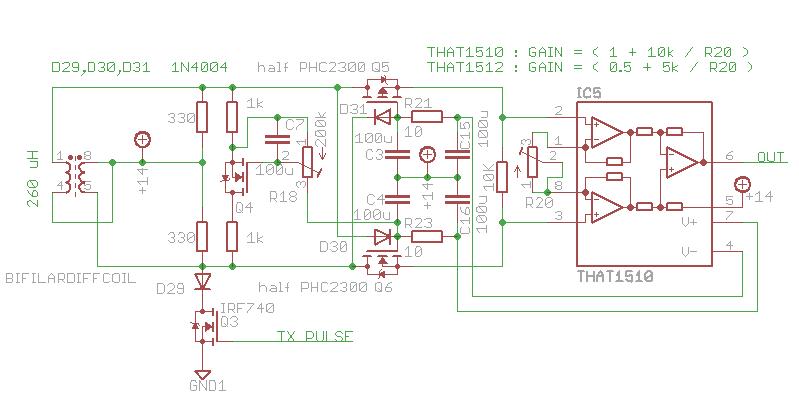

                      • ...front end with the amp fitted.
                        R20 varies the gain
                        R18 varies the damping
                        moodz

                        • moodz
                          now thats what i'd call confidence in the blocking fet design, putting the That 1500 amp on the flyback chopping block.... ,
                          but, i do notice powering the 1500 from c15 and c 16 ,
                          Philip
                          can you post your eagle sch file for it?
                            moodz
                            Philip
                            LOL ... I will PM you the file ... the amp circuit is not fully tested yet so I guess that is a work in progress.

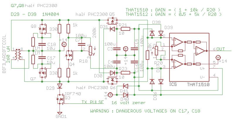

                            • The full motza ...
                              WARNING : THIS CIRCUIT COULD KILL OR HARM YOU .... DANGEROUS VOLTAGES CAN BE GENERATED.
                              ... having said that ... the fully protected circuit.
