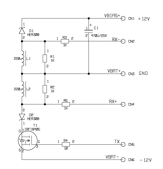

    Interesting preamp, don't think I've seen that one before. Great specs. However, the 1nV/rtHz noise spec is wasted; with R5 & R8 = 1k they have 5.6nV/rtHz. You need to get them down below 100 ohms, which implies a dynamic input clamping circuit. Now there's a design challenge!
    Of course, if the PIC ADC is 12 bits (I'm being lazy by not looking it up) then this level of noise is probably in the mud anyway. Might want to consider a fast SAR 18 bit ADC, I'm currently playing with a AD7982 and ADS8484. Any idea on what sample rate you are going to use?

    Hi Carl and thanks ...the dspic30F4012 has only 10 bits ...unfortunately ... so yes the preamp noise specs are of academic interest only in this application. The circuit is more of a "demonstrator/experimenter" however it should be able to match performance of the simpler PI designs around. The TX pulse rate is just over 5 Khz with a 100 us duty cycle. The ADC ( working at approx 750K smps ) grabs 64 samples after turn off and each sample is averaged over 1024 TX pulses. I then end up with post turn off waveform oversampled by 1024 updated at a rate of approx 5 times a second ( 5k / 1024 ) Basically then a digital version of the differential integrator is applied where late samples are subtracted from early samples and compared to an early reference sample that is stored either automatically or on press of button ... I hope to dump the averaged waveform by way of RS232 so coil speed can be measured. The traditional boxcar algorithm had to be modified for the averaging calculation as it used too much ram to average a whole waveform point by point. The current code can average and store waveforms up to 512 points over 1024 samples each or more.( there is only 4k of ram in the dspic )

              Something I tried that seems to work very well is to use the auto-transformer action of the coil to generate the +ve rail: I prefer to call the +ve battery terminal "ground" and keep the -ve negative . Now when the centre tap of the coil is connected to ground and the mosfet switches one end of the coil to -ve, the other (unused) end of the coil goes up by the supply voltage above ground for the TX pulse duration. Using a fast, HV diode this can be used to juice a capacitor that holds the +ve bias for the amplification stage! I used an HER308 (3A, 1KV, 50pf, 75ns recovery) diode and it doesn't appear to have any discernible effect on flyback duration. Using the same type of diode in series with the mosfet makes a significant improvement to the flyback duration.

                  How much load you can put on it depends on factors such as pulse TX width and coil inductance but with a low dropout, low quiescent 5V regulator (like the LM2936 I've used) there should be enough for at least three or four OPAMPS in most applications. 7805's take around 5mA just to keep 'em ticking over which I always feel is a bit greedy. The advantages of this bias generating scheme is that it is phase locked to the TX/RX cycle making free of noise when it counts and also costs next to nothing given that it consists of just a diode and capacitor
                  Naturally it also applies to a plain (not bifilar) coil that's centre tapped and connected in the same way as above. I'm still trying to prove to myself the merits or otherwise of the bifilar winding

                    Way back, I tried that with a mono coil and it generated enough power. But it increased the flyback period quite a bit. I have a circuit to test your idea on. It has five dual op amps and the diode tripler that I incorporated, but it can't handle the load. I let you know.
                      But was that a differential mono coil Altra? Perhaps you tried capturing some of the +ve flyback from a single ended mono - that would wreak havoc with the decay time. This scheme is quite different. During flyback, the diode is reversed biased by the full flyback voltage and only its recovery time (under 100ns) is added to the overall decay. Charging current into the reservoir capacitor also begins and ends with the TX pulse through auto-transformer action so the supply is settling throughout flyback and detection phases.
                      The only refinement I can think of might be to place a small value inductor in series between the diode and capacitor to control the charging current.
                          Of course the actual voltage developed across the upper winding also depends on the coupling coefficient between the two halves of the coil as well. This is bound to be less than one, but then I've been shooting for 5V with a LDO regulator which appears to be viable with the couple of different coils I've made so far.

                            I did try it out on a big coil and get nearly +10.5 volts at 100 ma loading ripple is 500 mV ...after a regulator this will be alot better. The peak flyback voltage dropped about 15 volts on a 470 volt max but the overall decay was not impacted. This will be useful for powering a diff amp located in the coil head or a pluggable module near or on the coil head. The coils I use are made with magnet wire tightly twisted 2 -3 TPI and coupling seems to be quite good.

                              With the above circuit, is this setup inverting ?. Eg. The coil in ON when the dspic pin is low and OFF when it is high.
                                The mosfet driver between the dspic and the mosfet is inverting ... TC4421 .... so a low input will produce a "high" on the output of the driver thus turning the mosfet on.
