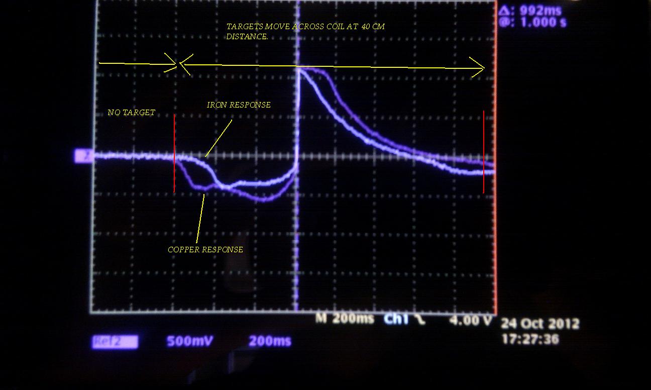

                                Below is the input signal to the audio modulator ...ie the output from the amps etc etc ..... two identical test targets are moved across the 18 inch monocoil at 40 cm ( note the time base ... about 1 second target time ) .... iron and copper ... for comparison.
                                This unit (the "PRO" experimental model ) uses an analogue signal chain processor so some user skill will probably be required to determine discrim tones ... the "Super Pro" experimental model has
                                the full ducks guts DSP unit and should ( when I finish it LOL ) provide more indicative discrim. FYI the non ferrous targets sound mellower ... the iron targets have more of a ping.
