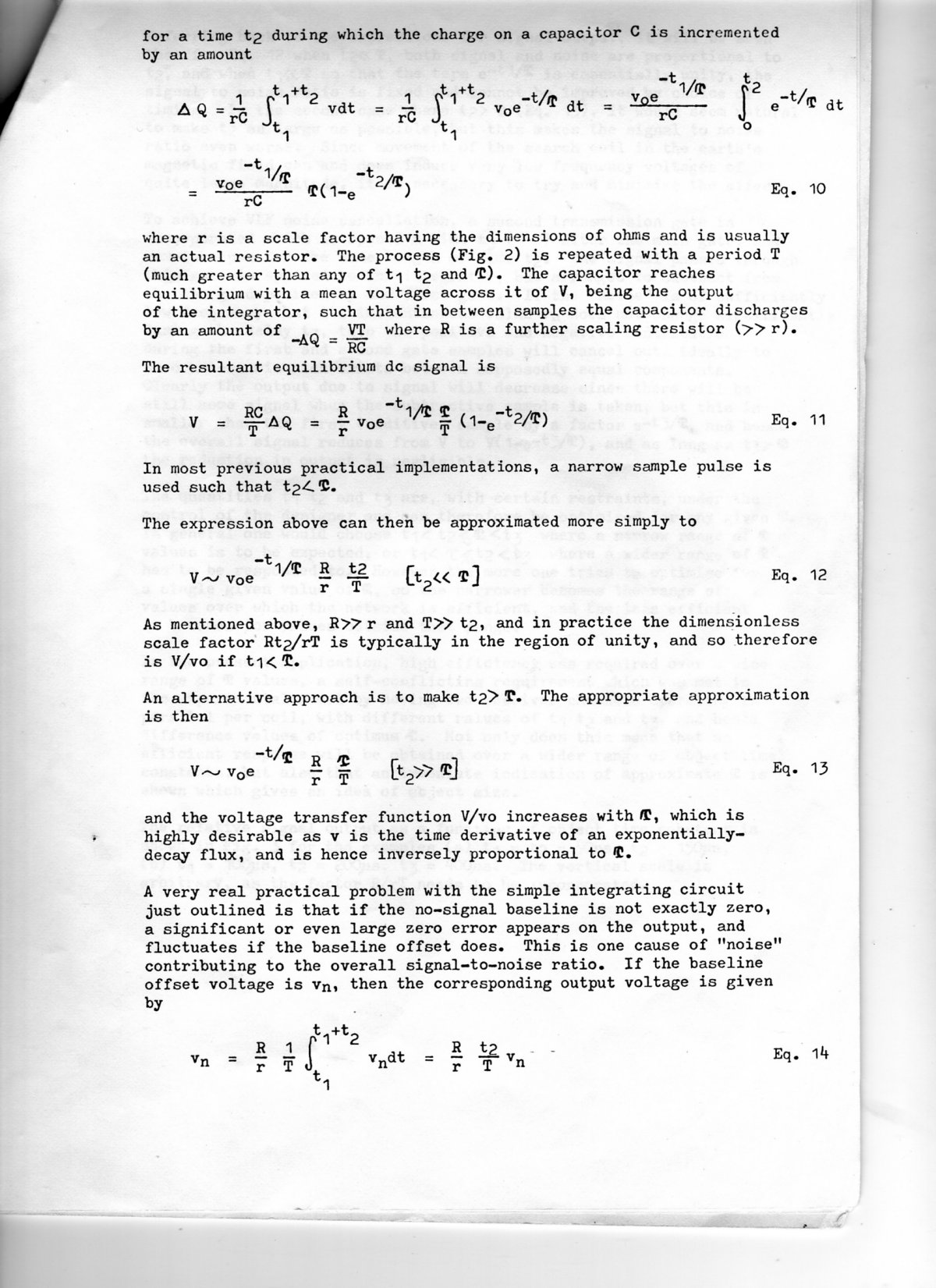

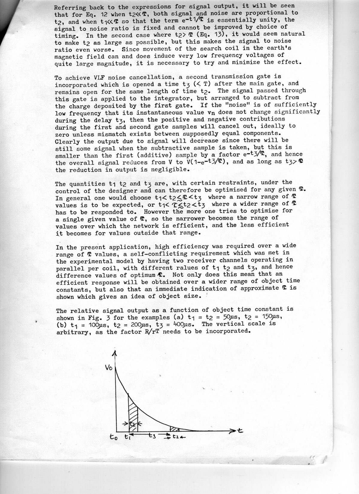

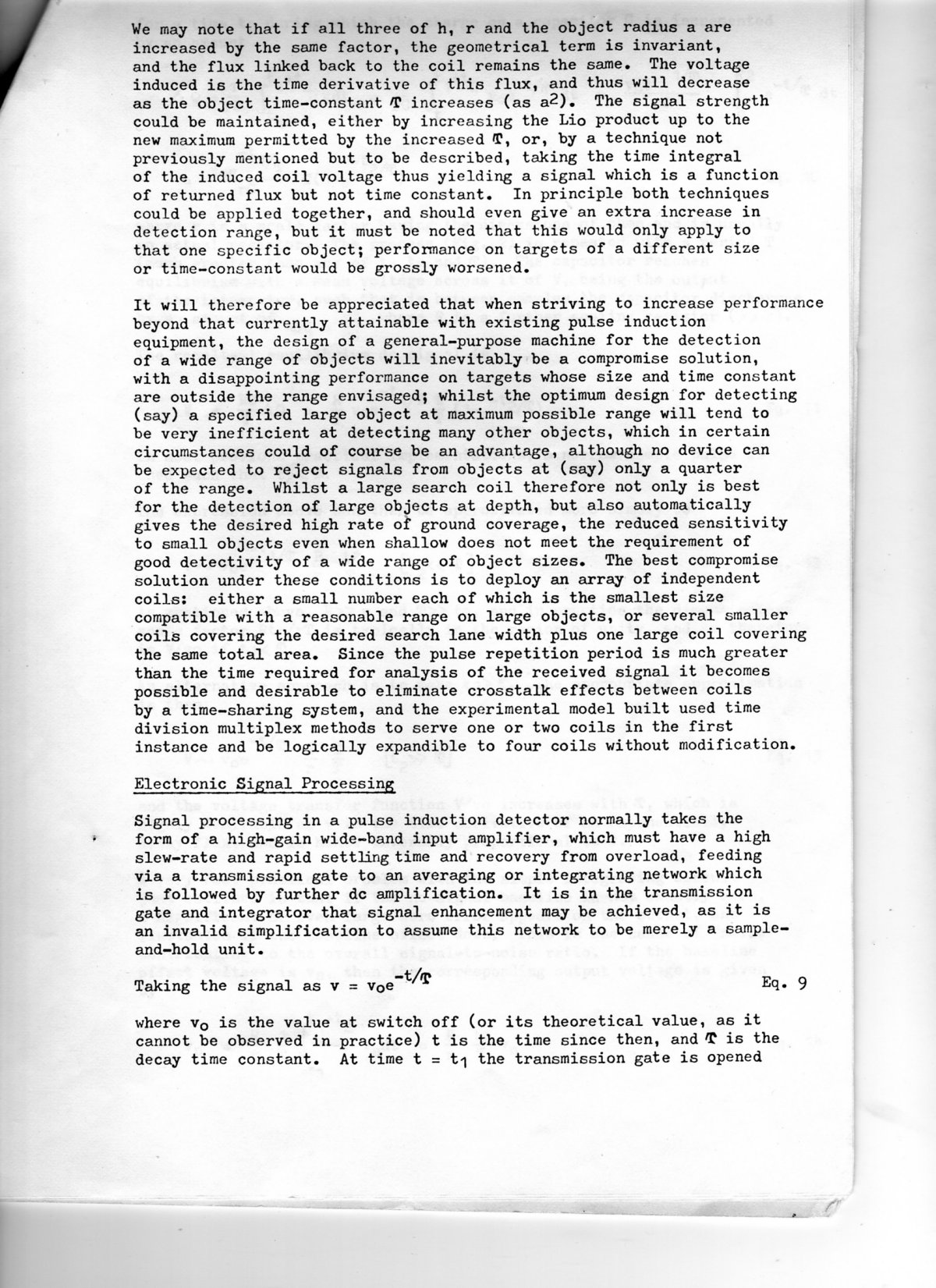

                        • Well this is what I have. Not by me but by John Alldred, employed by myself in the 1970's. He had a Masters Degree in physics and was one of those rare persons who could work out all the maths and theory and then build something that worked. Sadly he died 10 years ago at age 61 of lung cancer.
                          Aziz, it would be interesting if you could refine this and bring it up to date. Also to include extra samples for GB.
                          There is data on coils but this will be posted later in Advanced Coils for PI thread.
                          Eric.
Name:	PI Theory003.jpg
                          • Nice, thank you.
                            There are, however a few points that may be emphasized... vo can in fact be measured directly in case of a separate Rx coil placed in induction balance, and EF can in fact be cancelled by both bipolar pulsing and HPF.
                            Furthermore, I'd say keeping sampling periods equal may stand for easier math, but is certainly not good for S/N at later samples.
                            You may consider a period t-to to be a bandwidth limiting one, so in fact you are subtracting amplitude responses of ever so lower cut-off low pass filters, thus enhancing the high frequency content e.g. short tau. With 1/(t-to) being the boss, I can't see equal time spacing to be optimal. I also fail to comprehend why is a late sample taken after every pulse. Some kind of iambic pulsing would provide more punch per time, while keeping the goodies of the late sampling.
                            • We need to do what geophysics has done in TDEM for years. Bipolar pulses and logarithmically spaced sequential time gates. This gives good resolution at early time for fast decays and at late time maximises the signal. Samples the whole space between TX pulses and cancels EF too, as you say.
                              Eric.
