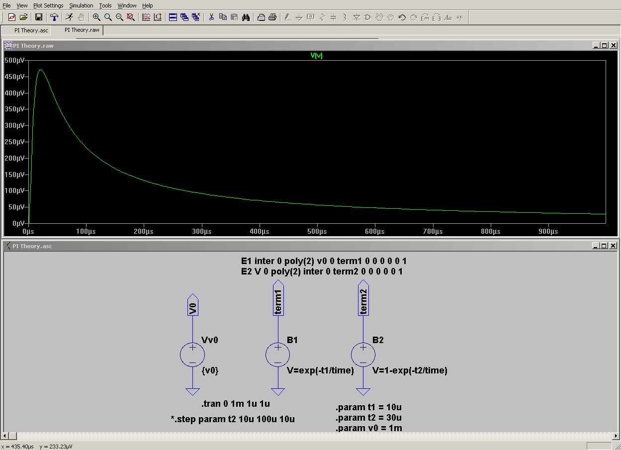

            Here is an LTSpice simulation of equation 11 in John Alldred's paper:
            .......... (Eq.11)
            Since >> and >> , the dimensionless scale factor is typically close to unity, and can therefore be excluded from the equation. Hence we have:
Name:	PI Theory.jpg
            Unfortunately LTSpice does not possess a library of mathematical symbols, but it is possible to achieve the same functionality by using B elements for the exponential terms and a couple of 2-dimensional polynomials for the multipliers. This has the additional benefit of allowing the individual terms to be plotted in the graph.
            The graph shows how the output voltage (V) varies for a specified main sample delay width () as the target decay value () is swept from 1us to 1ms.
            Initially I ran this simulation as a DC sweep, and performed a parametric sweep of . Although this gave the same result, the x-axis was labelled in volts. Then I realised that LTSpice has access to the current simulaton time via the "time" variable, and it became a simple matter of using a time domain analysis to sweep the value of .
            You can readily observe how the amplitude of V is affected at the extremities of the curve. i.e. on the left-hand side is the dominant factor, but on the right-hand side has little effect. This was correctly predicted in the previous calculations.
            I have attached the LTSpice file for your delectation.
            If you uncomment the .step command, you can generate a set of curves for from 1us to 100us.
