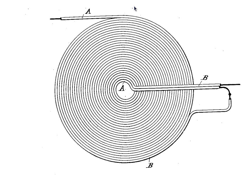

    Simplified diagram of a flat wound coil with no twists below ... with thanks to Tesla.

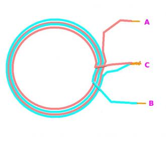

    Hi moodz
    is there any influence how to connect A and B connection wires from Tesla sketch to other PI parts? Can this two coupling points be swapped in connection?
      Hi moodz
      The A and B can be swapped ... I think .... the field induced pulse polarity would be reversed ... truthfully I have not done enough experimentation to verify effect.

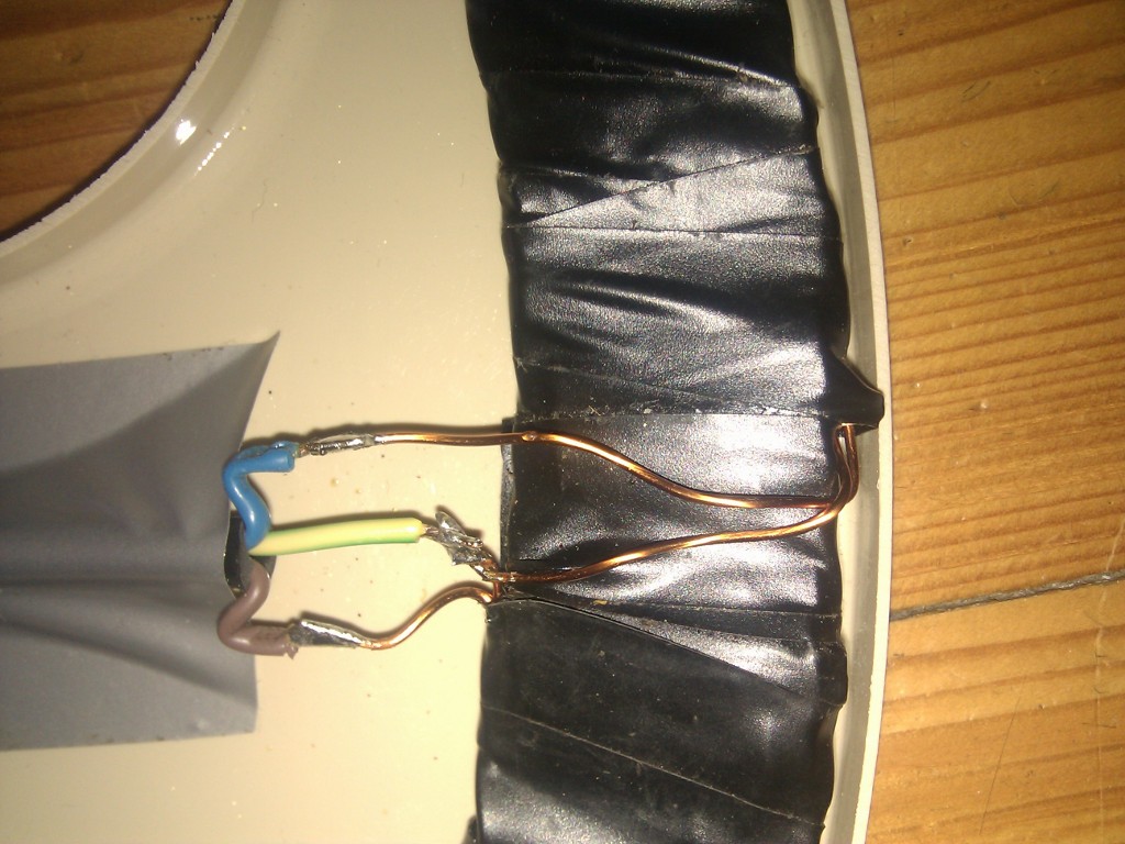

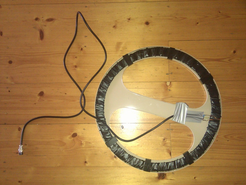

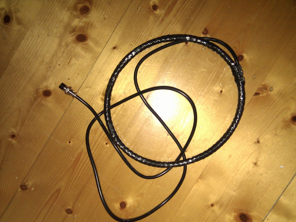

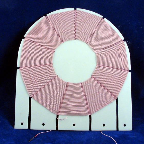

        18 inch flat wound differential coil.
        To clarify the construction of a practical diff coil here is the visual detail below.
        18 inch flat wound coil.
        detail of connection of flex lead.
        winding detail .... you can clearly see twisted pairs wound flat in basket weave to minimise capacitance. The black tape is ordinary PVC electrical ... there is no shielding.
        moodz
          Interesting coil, not seen yet.
          Something like "Differential twisted pair spiral zig-zag coil". And for coil cable you use simple main power connection cable, never seen to yet on PI too. And pro connector.
          Very inventive. Looks good - must be good. High Q for sure.

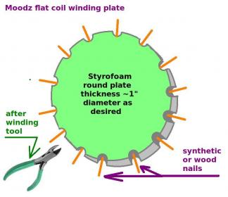

            Possible solution for moodz coil winding accessories.
              Very good coil....
              It is time to try it
                How to make twisted pair wire out of lacquer copper (Cul) wire:

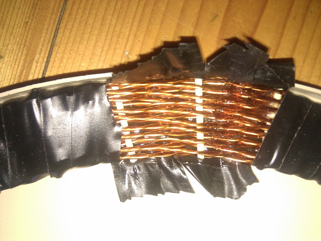

                Hey ... thats almost exactly how I did it !!! I used a circle of MDF with odd number of holes drilled every inch along outer edge. Used bamboo skewers as spokes. Wind on the coil ... paint with varnish then cut skewers at base to remove coil.
                  This is important... see the spokes.
                  These separate the wires to reduce capacitance.
                  Remember, capacitance is the enemy in a PI coil... and these spokes separate the windings to reduce capacitance to make a very fast coil.
                  Better than using litz wire....
                  Do this same as Moodz did so you can have a fast coil too...
                  Best wishes,
                  J_P

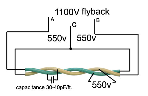

                            I have some doubts regarding twisted pair coil design: high capacitance, 550v between wires.
                            Thank you for the great project. Can't wait to see it working.
                            1. There is a huge capacitance between twisted wires.
                            If good coaxial cable has 16 pF/ft. then twsted pair has 30-40pF/ft or so.
                            Coil will have additional approx. 35pF x 60ft. = 2160 pF
                            You can find twisted-pair capacitance calculation here:
                            http://www.signalintegrity.com/lib/htm/TWIST.htm
                            It may help to reduce capacitance if wires will not be twisted
                            or coated thick insulation with low dielectric constant (teflon,polyethylene)
                            2. If flyback voltage can reach 1100V then you can expect 550V between
                            wires in twisted pair according diagramm below.
                            Regular magnet wire can survive 130V only.
                            So it requires much stronger insulation. At least 600V teflone coated wire.
                            http://www.bulkwire.com/wire-cable/p...nded-wire.html
                            Unfortunately this wire is silverplated so it inducing more eddy currents in the
                            wire then tinned wires. Teflon coated Litz wire will be best if it is possible to find.
