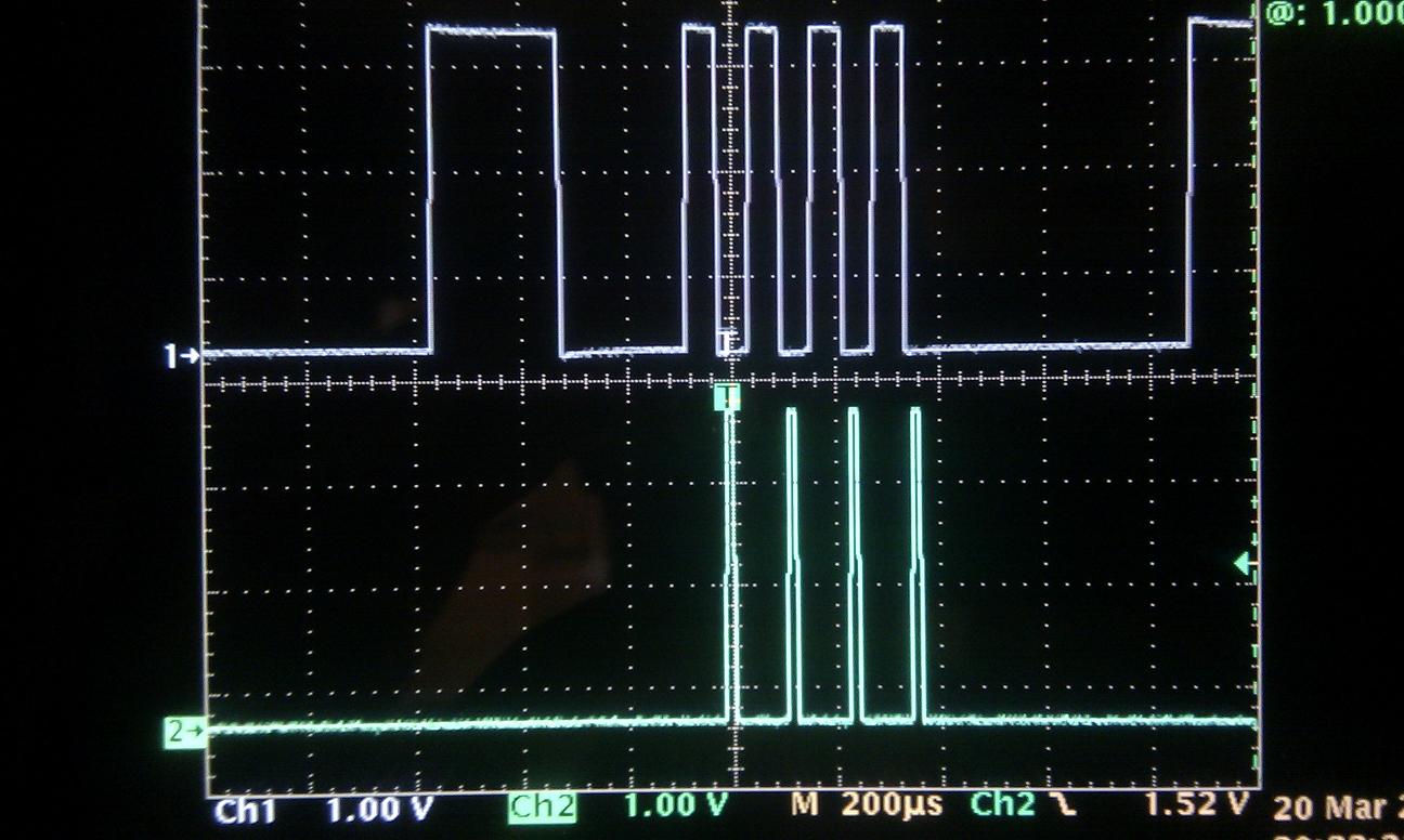

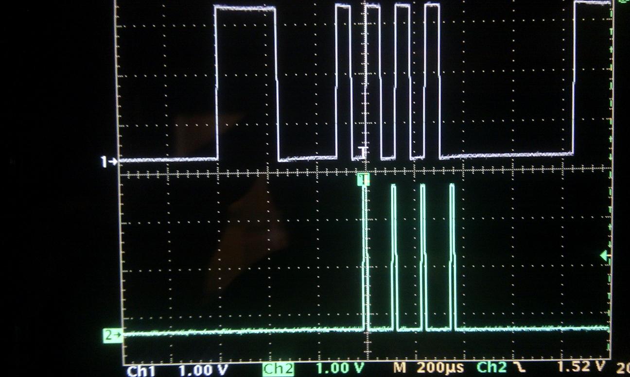

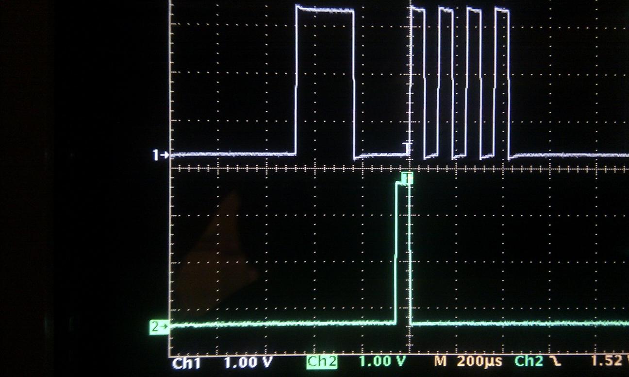

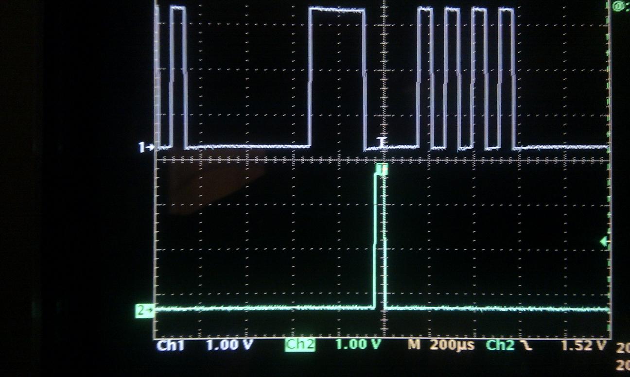

          It might ... however you will need to provide the timing diagram for the TD.
          In the meantime I found another timing diagram lying around on the web ( for SIDO ) and popped some code into the UNO32 to see how it would do .. indeed it is not bad ... very low CPU overhead around 5%, arbitrary pulse trains with patterns that are only limited by the RAM to store them.....and the timing clock is 80 MHz so thats 12.5 nanoseconds of resolution on adjustments. Each mark and space in the pulse train is fully adjustable on the fly and its all generated with 50 lines of code ... not bad if I say so myself
          There are 5 outputs on the UNO32 implemented so far ... Pin3 = TX Pin 5 = channel 2 sample A Pin 6 = channel 2 sample B Pin 9 = channel 1 sample A Pin 10 = channel 1 sample B. The ground balance samples are another story ... I ran out of pulse hardware on the PIC32 .. but doable. ... but who needs ground balance when you have the patent pending "moodz" AGB system ....right ? ...
          This system would be very busy to manually enter a pulse train and adjust each pulse timing on a simple LCD display ... so I am thinking a bluetooth interface to program it from a smartphone ( prob android ).
          Heres the hex so you can verify ... note the menu does not work !!!! ... this is a UNIPI hack to get the pulse generator only going ... its not adjustable ...
          I would upload the pix and the hex .. but nothing is uploading to geotech at the moment
          • ...try to upload pix again ...
            damn ... cant upload anything even a screenshot of the upload error ?? doh.
            • The pix are posted at a well known unmentionable web site under this topic.
              "pulse generator for doing detector stuff"
                ...third try ...
                comparison of the TX pin to the other pins ... the pulse train is similiar to an expired patent and old detector.

                • Hi Moodz,
                  I don't know how you have set up the pulse train, but if its using the output compare module, you only need 1 oc for each channel. After the + sample has been taken, re-assign the OC to the - sample pin....
                  Cheers Mick
                  • Originally posted by Mechanic View Post
                    Hi Moodz,
                    Cheers Mick
                    ....heh heh ... You are right Mick ... It's using all the OCs .. I just implemented the timings as per the diagram .. With pulse steering I will have all the sigs and one OC left over for ... Channel 3 Or even the AGB. I only hammered the basic code out to test for any jitter or funny business in the pulse hardware that microchip implements. So far so good.
                    Now to add the QED timings from the patent ...for experimental purposes only.
