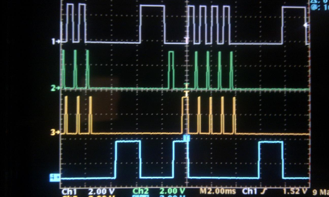

        • ...just to recap
          Now that I am back on deck ...
          The pulse generator hardware results based on UNO32 board ( Pic below ).
          Very roughly based on a UNIPI code however new tricks with the interupts and hardware from Microchip allow better resolution and stability.
          Pulse sequences can be of almost any length with 5 "channels" and up to 4 outputs per channel with different pulses in the sequence coming out of different outputs or one output. ( ie upto 20 outputs/pins if you want )
          Each pulse sequence and ouput pin is programmable on a pulse basis with fully defined start and stop times for each transition in 12.5 nanosecond steps ( might change this ... its actually too fine LOL ).
          In the case shown ... the SD2000 pulse timing is a no brainer.
          You could also set up a single channel surf PI type pulse even more easily.
          Any single pulse, combination or all the pulses can be adjusted on the fly during use for whatever you may desire.

          • hello paul,
            Nice!
            on the software, are you usuing 1 32bit timer to "feed" the 5 output compair modules? to keep it all in sync.
            or is it the "trick"......
            Philip

                A single 32 bit timer is the source reference. The "trick" is to get the arbitrary pulse sequences which could even mean changing the TX frequency on the fly without glitching the sample pulses. Give me a call on skype and we will talk about it ...

                  • HI Paul,
                    Nice job man!!!
                    So how many times in one cycle can say output 1(or any of them) be turned on and off?
                    12.5ns resolution, you are the best Don't lower the resolution, if anything have a setting that can be set to adjust resolution.
                    Cheers Mick

                      Hey Mick ....you can have as many pulses as you want provided the 32 bit timer has not reached final count in that cycle. There is a limitation however because interrupts are used on each pulse the sequential pulses cannot be too short or the interrupts will clash. For the sd2000 timing the margins are relatively big so no clash occurs. The 12.5 ns timing comes from the 80 MHz clock driving the timing reference. For Ian's application ...and mine also the multi pulse scheme will not be used because the interrupt timing clashes with the ultra short sampling and tx timing. Using one pulse per period per output uses no CPU overhead at all. ie. one tx and 4 sample outputs.
