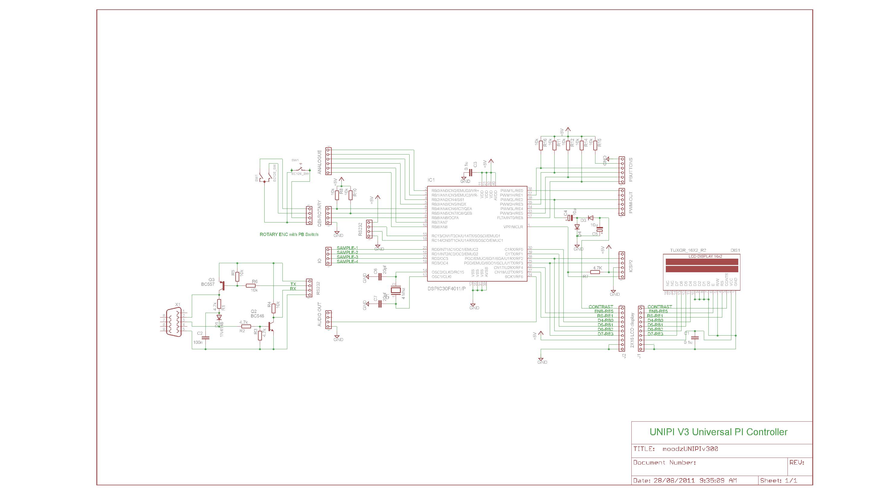

                      UNIPI Universal PI Controller V3
                      UNIPI now moved to slightly bigger chip .... dspic30F4011. Forty pin DIP so easy to solder
                      4 sample pulse lines now .... works in Goldscan Circuit ...
                      Each pulse line can have individually settable ON and OFF times during or after TX pulse in 66 ns step resolution.
                      Dynamic control of coil damping. Optimise coil damping at the press of a button.
                      Crystal Clock option.
                      More buttons.
                      Real Serial port.
                      All features in UNIPI v230 still included.
                        Great moodz, this is for us old fashioned boys. Probably new hex file too?
                        • #87
                          Just testing the code then will release hex file.
