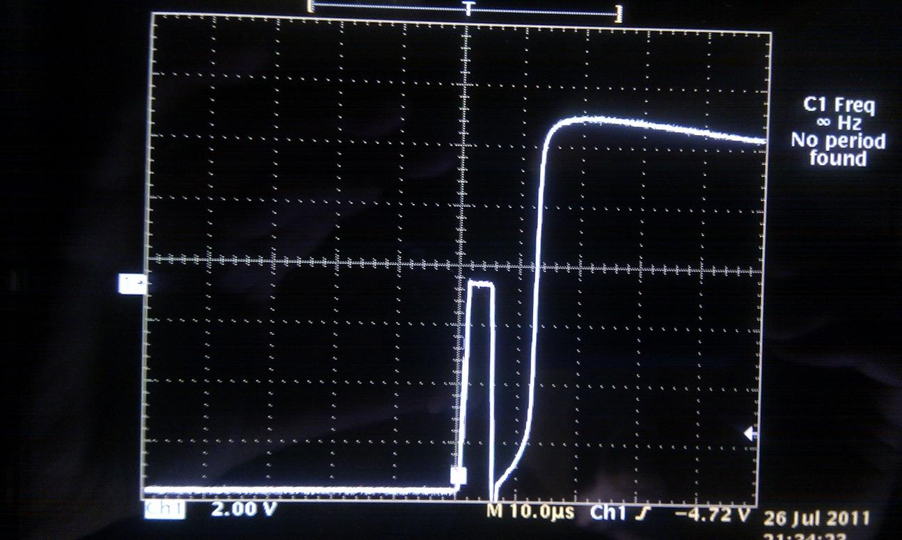

    I knew it was there but I was looking in the wrong place
    No DSP required .... let the front end do the work
    Stable and repeatable descrimination seems to be successful and I got bonus early sampling time without even trying.
    Three result shots ....

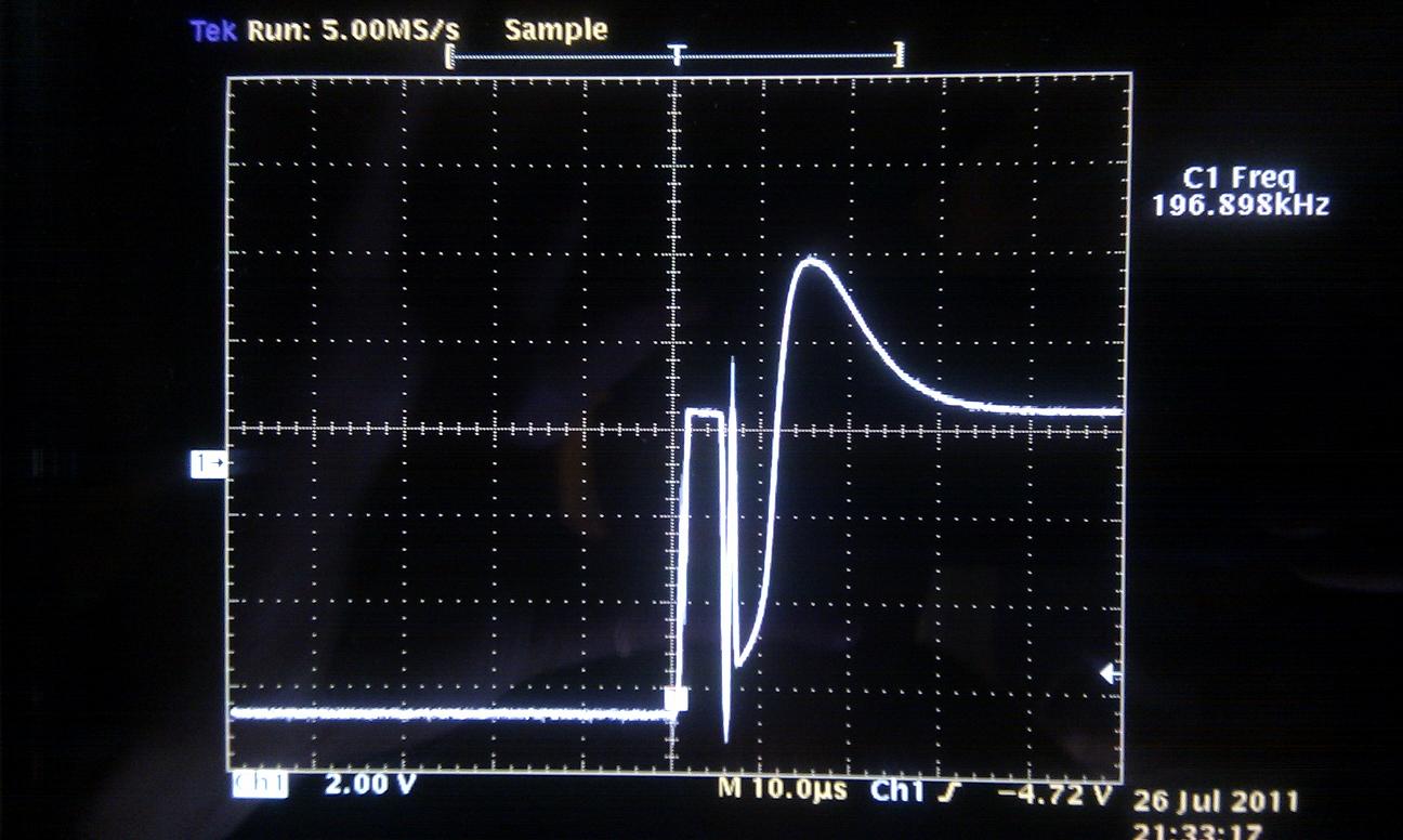

    1. No Target

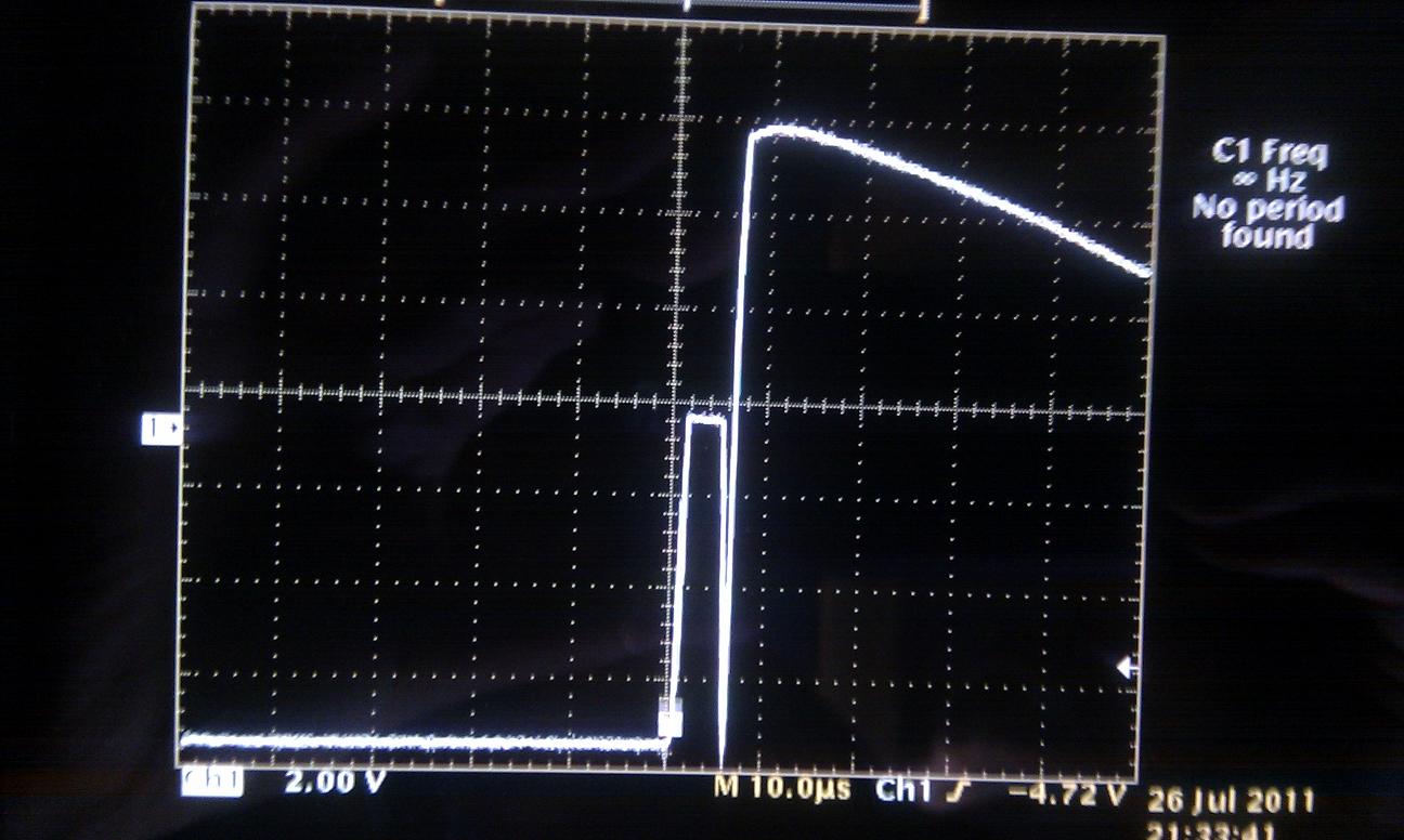

    2. Steel Target
    3. Copper Target

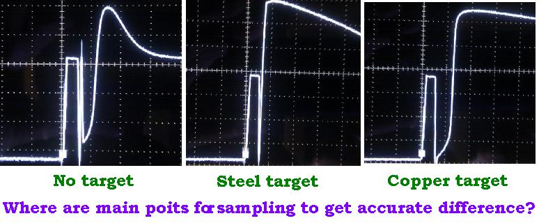

    It would be interesting how we can manage with copper plated steel?
    And what is area of sampling to get accurate and repeatable discrimination results?
      Look at gap between flyback and signal ..steel or iron makes gap smaller. Look at slope of decay ...iron drops off faster ... I have only just realised this cct...easily more optimisation...regds moodz

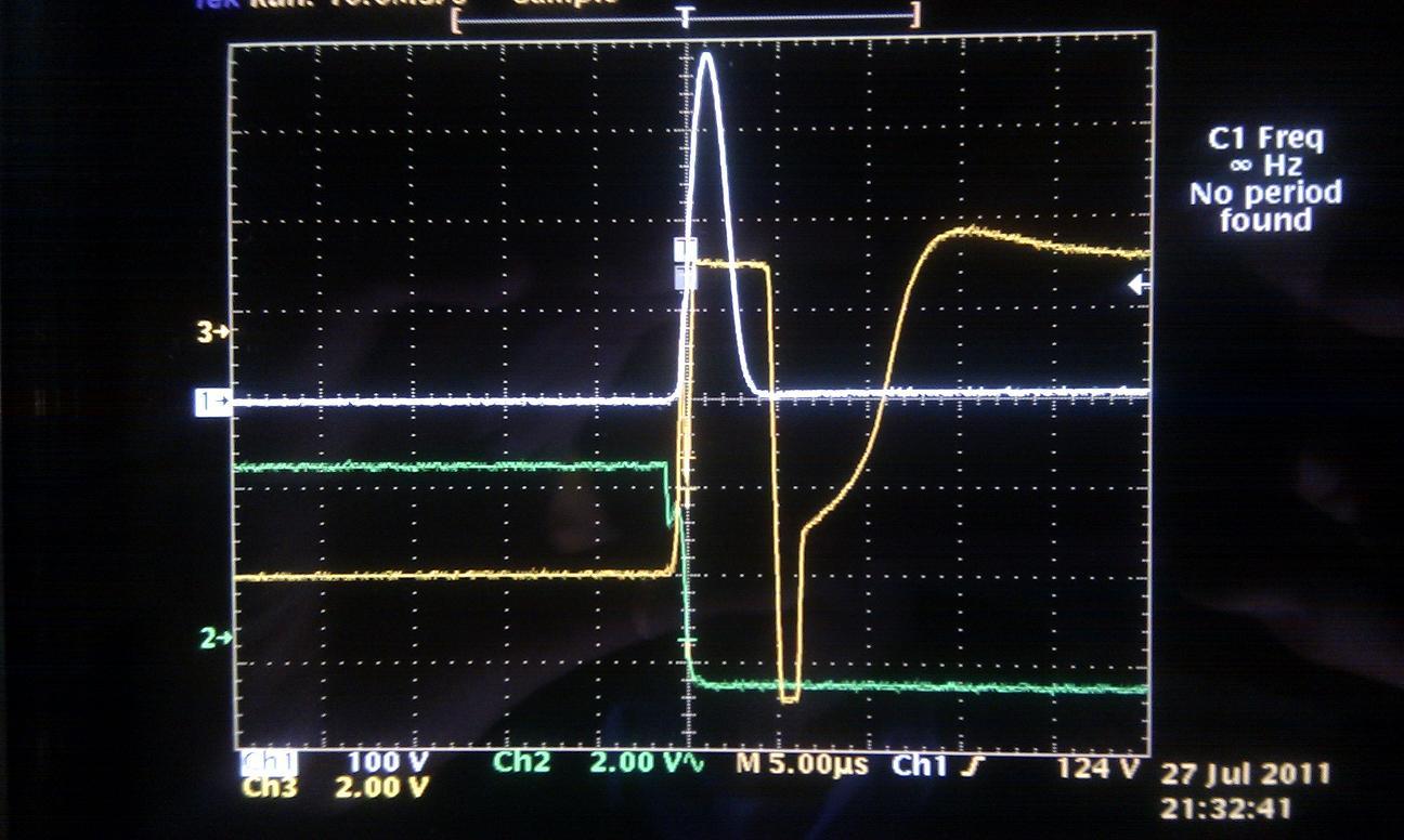

        descrimination waveforms
        Green = mosfet switching .... ( bit noisy ... driving directly off CPU not MOSFET driver )
        White = Flyback voltage measured at coil ... peak just under 400 volts.
        Yellow = output of preamp .... The preamp can swing +/- 10 volts so it is NOT saturating.
        easily sampling at 5 microseconds with active damping enabled.
