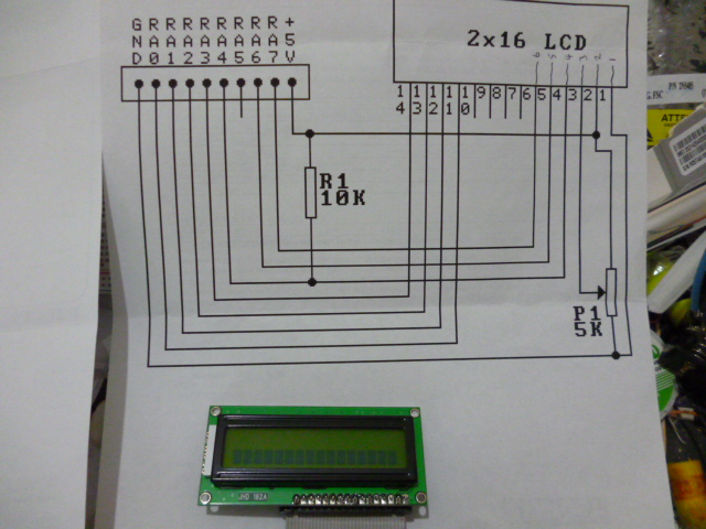

    btw for testing the lcd it needs a 5k - 10k pot for the contrast control
    turned almost to full earth for the display to work
    or the characters are invisible
    you will see here a row of blocks

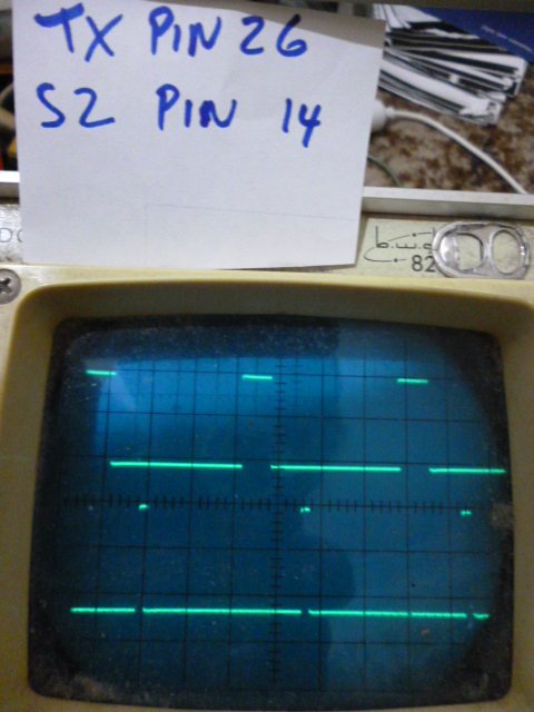

      I think I have come to the conclusion that my pickit3 clone setup
      is not programming my chips properly. I have 4 chips.
      today i decided to try and re program a couple of them
      first i tried to erase them, which seemed to work.
      but when i tried the blank check or reprogram them or verify
      i started getting errors, maybe the chips are duds.
      trying to erase them, and program them now just gives errors.
      I dont like to ask for help, but before i give up, Mr Moodz would you mind if I posted a couple of chips to you
      to see if your system can erase the chips and reprogram them please ?
      I know that this is not your intention to support folks that have problems like this
      but if your pickit2 system works with my chips then it will prove a fault in my system,
      then I may buy a real pickit2 and try again.
      If you dont want to do this, thats ok, I may have another try at this project later.

                        • #87
                          Success
                          received my chips back from Mick today
                          and have tested one of them
                          and can see some pulses at last
                          THANKS MICK
                          • #88
                            Hi Mick and Moodz
                            this is chip number 2 with nice pulses
                            6666
