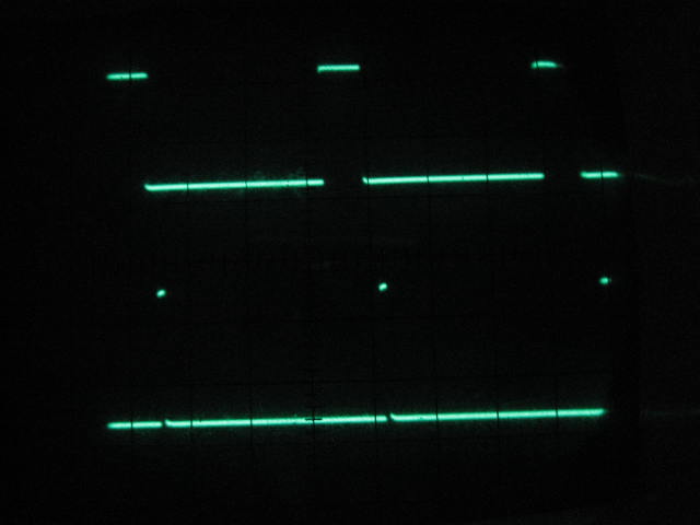

      I have had a 4012 running for about 1 hour with no LCD connected
      still was pulsing ok

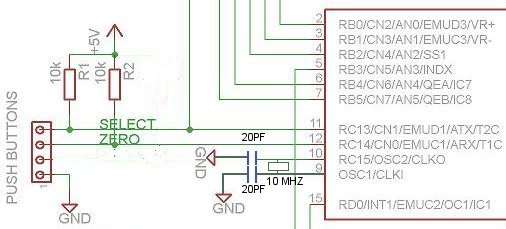

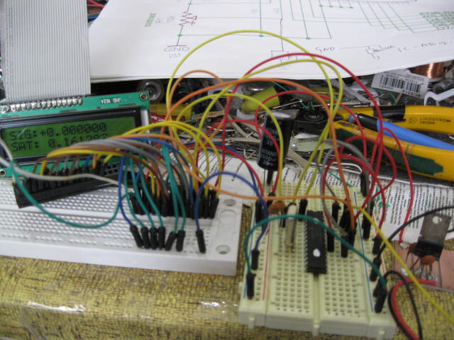

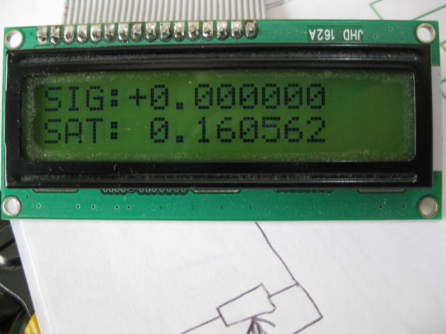

          • Late last night I revisited this 4012 project with the aim of trying to find out the minimum number of leg and power connections to get the chip working so it can be tested for pulses.
            With the chip loaded with the default hex, and the 10Meg Xtal on pins 9-10,
            here goes, pins 20-28, and 19-27, thats it.
            A word about the Xtal, I could not get a small 10Meg watch Xtal to work, but the larger 13mmx10mm works fine.
            http://www.geotech1.com/forums/attac...1&d=1321413350
            • I should also mention the Xtal capacitors to ground,
              now onto making the LCD work.

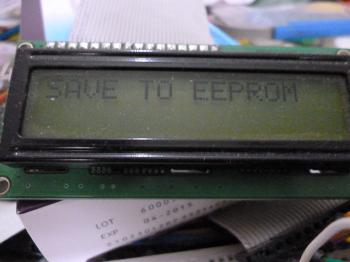

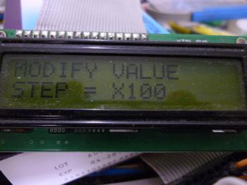

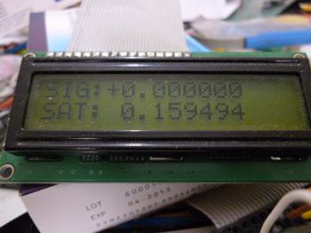

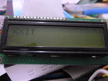

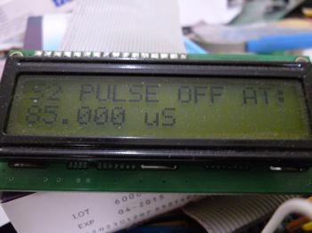

              • FINALLY
                after a long time,
                got this project to fire up on the bench, with the LCD,
                only on bread board, but it displays past bootup, and still is giving pulses
                no encoder just yet, so still need to try and talk to chip,
                next a pcb of some sort.
                Thanks Moodz
                cheers

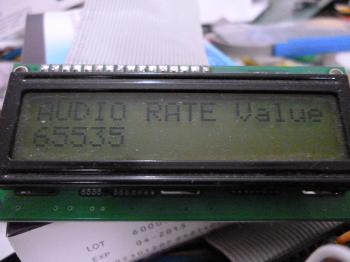

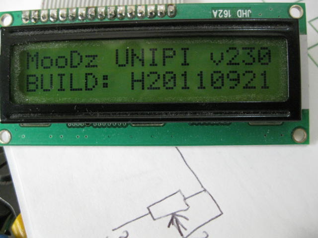

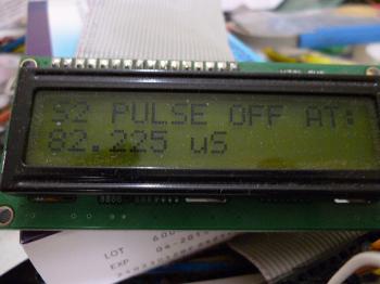

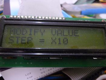

                6666
                some pics for your viewing pleasure

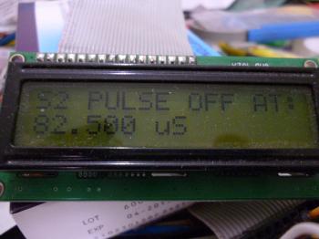

                    • Had a bit more of a play with this project today , if you place the "select" 10k r on pin 11 and dob on earth on pin 11 you can cycle through the menu.
                      The rate at which you dob on the earth will display different parts of the menu, if you dob slowly you get the main values, if you dob quickly you get sub menus it seems, by simply cycling through the menu with just dobing the earth on seems to have altered some of the values.
                      6666

                              • Finally I managed to put it working!!!
                                The problem was related with wiring. I've missed the connection between LCD R/W (pin 5) to the ground
                                XiX
