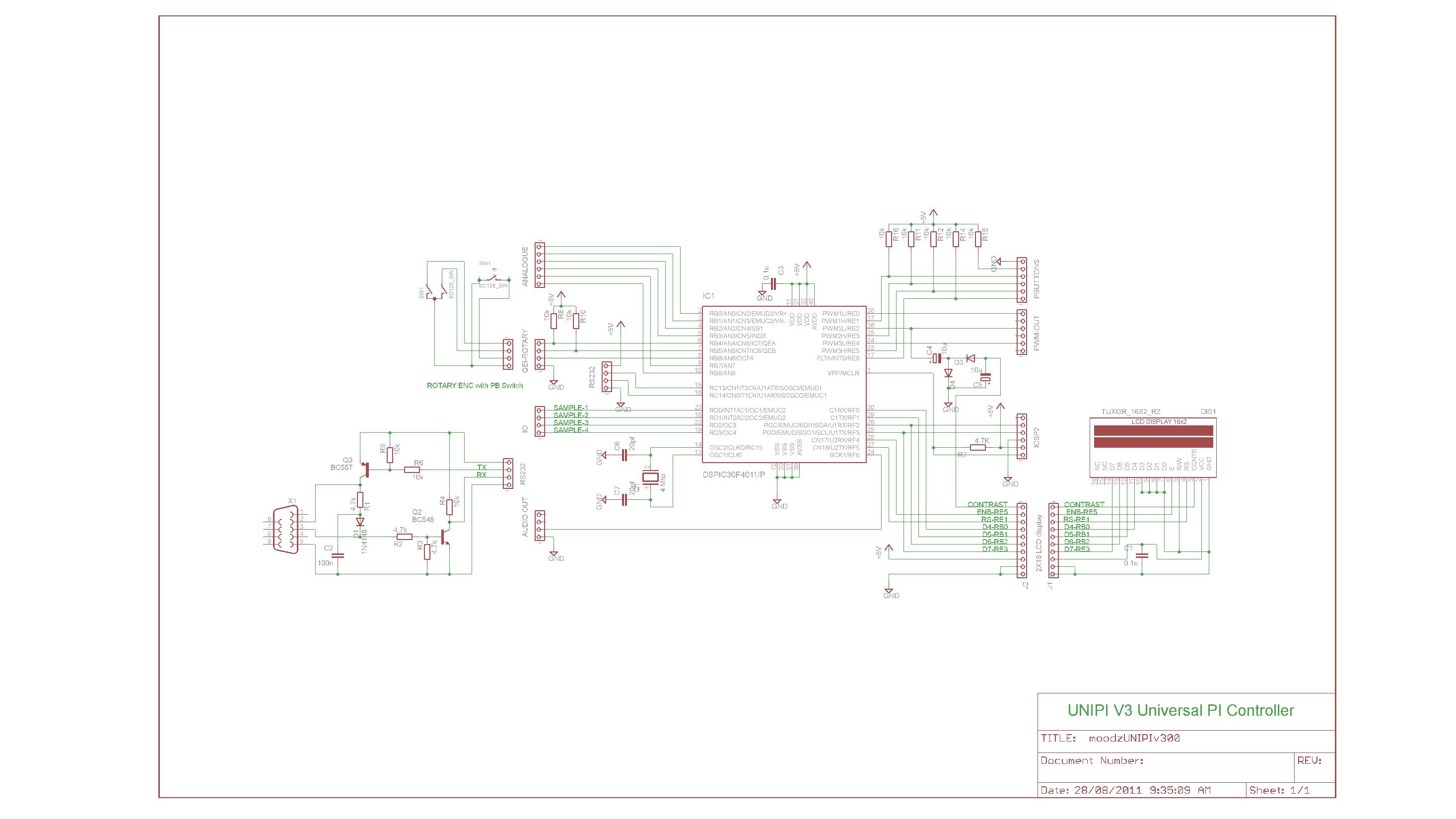

      Here it is ... however you need to connect 10 Mhz Crystal.
      The serial port is currently on the programming pins ....
      moodz.

        Thanks Moodz
        and this cct is still valid with 10mhz xtal
        cheers

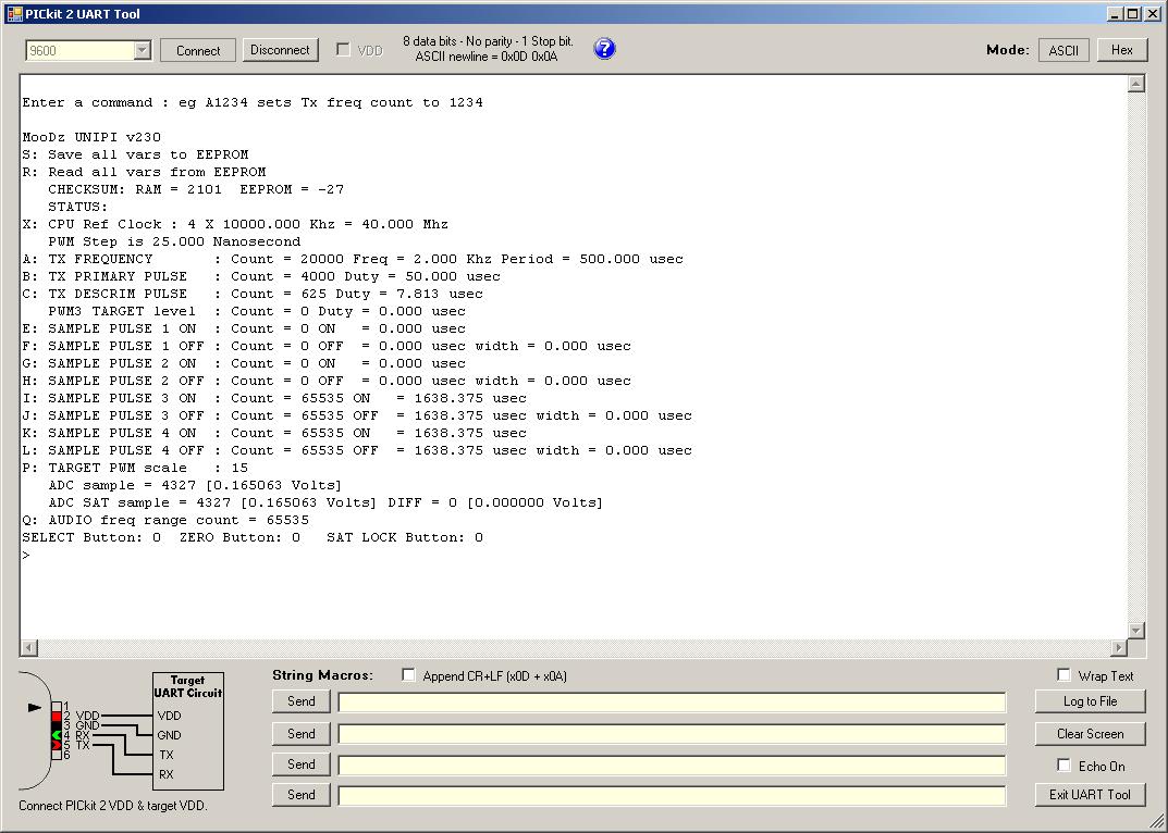

          .... it should work ... the rs232 comes out of the ICSP port not as indicated on the drawing ( convenient for pickit2 UART tool ). 10 Mhz instead of 4 Mhz
          I wired up the board but not with an LCD or rotary switch ... works OK on serial port. Let me know if it works or I will change code :-)
          moodz

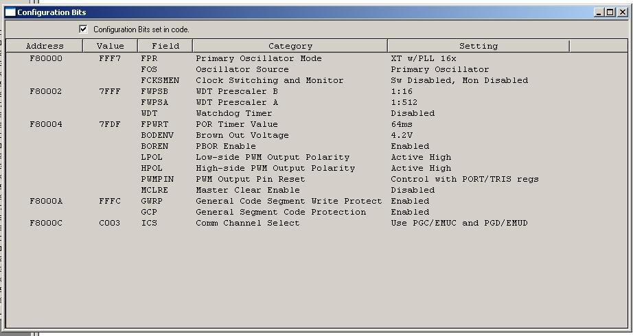

              the heap only needs to be set to 200 bytes ...
              the remaining settings as follows ..
              moodz

                  Hi Moodz,
                  Thank you very much for the details. It appears there are some settings straight into code that overwrite what you mentioned in the screenshot for the configuration bits (for example, the code instructs for internal RC oscillator, while the config settings are selecting an external crystal). All these are basic things and easy to change for people who have a bit of experience with PIC programming.
                  Also, the Pic Kit 2 software still raises the warning no matter what I tick/untick in the configuration bits, maybe this is a bug in the Microchip software? You indicated protection of the code, if I understand in your settings, but won't this prevent updating the chip with a newer version?
                  Best regards,
                  Nicolae

                      Hi Nick .. the original code did use the internal oscillator however there was too much jitter so we switched to a crystal.
                      this is the line of code that does this ...
                      _FOSC(CSW_FSCM_OFF & XT_PLL16 ); // 10mhz * 16 / 4 = 40 mips on ext osc
                      Some other settings like brownout and start up delay and tx pulse polarity are set by ...
                      /* enablebrownout @4.2v, 64ms powerup delay, MCLR pin NOT active */
                      #ifdef BUILD_TXLO
                      _FBORPOR(PBOR_ON & BORV_42 & PWRT_64 & MCLR_DIS & PWMxL_ACT_LO); //TX pulse is active lo
                      #else
                      _FBORPOR(PBOR_ON & BORV_42 & PWRT_64 & MCLR_DIS & PWMxL_ACT_HI); //TX pulse is active hi
                      #endif
                      and finally the code protection settings only prevent the chip being copied ... they dont prevent it being reprogrammed ... this code does this....
                      #ifdef __DEBUG // secret squirrel code protect ... too bad this is open source ;-)
                      _FGS( CODE_PROT_OFF & GWRP_OFF );
                      #else
                      _FGS( CODE_PROT_ON & GWRP_ON);
                      #endif

                                Hi 6666,
                                Not at all, I don't have a board to test the microcontroller, all I've done was to prepare the files and compile them (to generate the hex file). I don't know what pulses are coming out of the microcontroller. Ask Moodz nicely to provide the latest hex file
                                Nicolae
