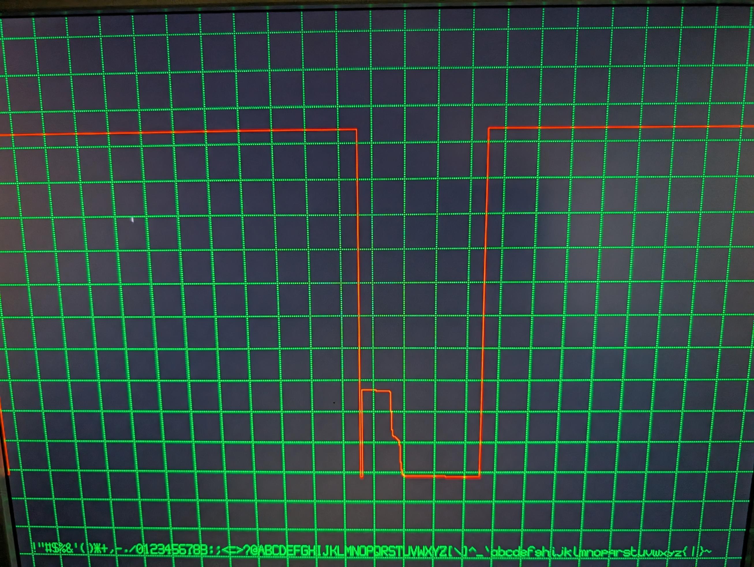

    The horizontal time base in for the last pic was 1.6384 milliseconds per value ( but just for the wave form bit ... as we are really looking at a memory buffer here in real time ).
    The update rate of the waveform is 610.35 Hz.
    The numbers are weird in decimal because all the DSP is done in pure binary .. not decimal.
    Hmm however having said that ... those rates above are the "update" rates of the samples .... so think like your CRO with 1024 waveform averaging set on.
    The real time base is still 400 nanoseconds / per sample ... ie 2.5 MSPS.
      Ok, thanks
        ...added the code to integrate the waveform across the buffer ... no idea yet if I am supposed to integrate across different sections and add or subtract for ground balance .. so in the mean time just integrating the whole lot and see where we go.
        The integral sum is the first "spike" on the LHS of the waveform as it has wrapped around ... some counter issue maybe.
        Not much to look at here ..but now we have the DC level to feed to the VCO ..( next step ).
