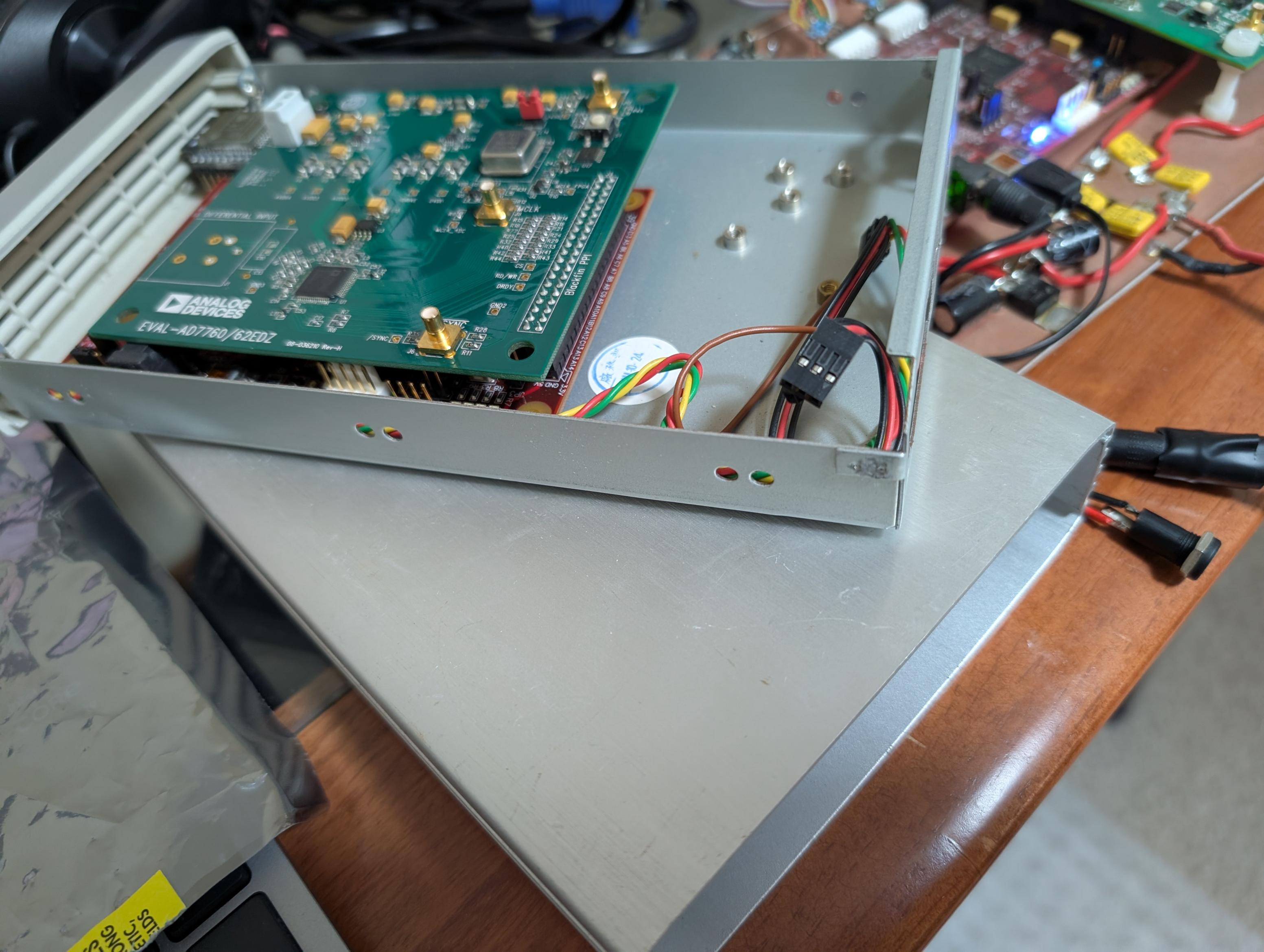

          ... making up a field test unit. Spun the ADC board around on the FPGA board ( will have to remap the pins in code ).
          ESP32 for house keeping WIFI / bluetooth etc.
          TX board and power supply + hardware to be fitted.

            Look good Moodz.
            cheers for posting progress

              Thanks Brian ... I am moving closer to using your display unit.
