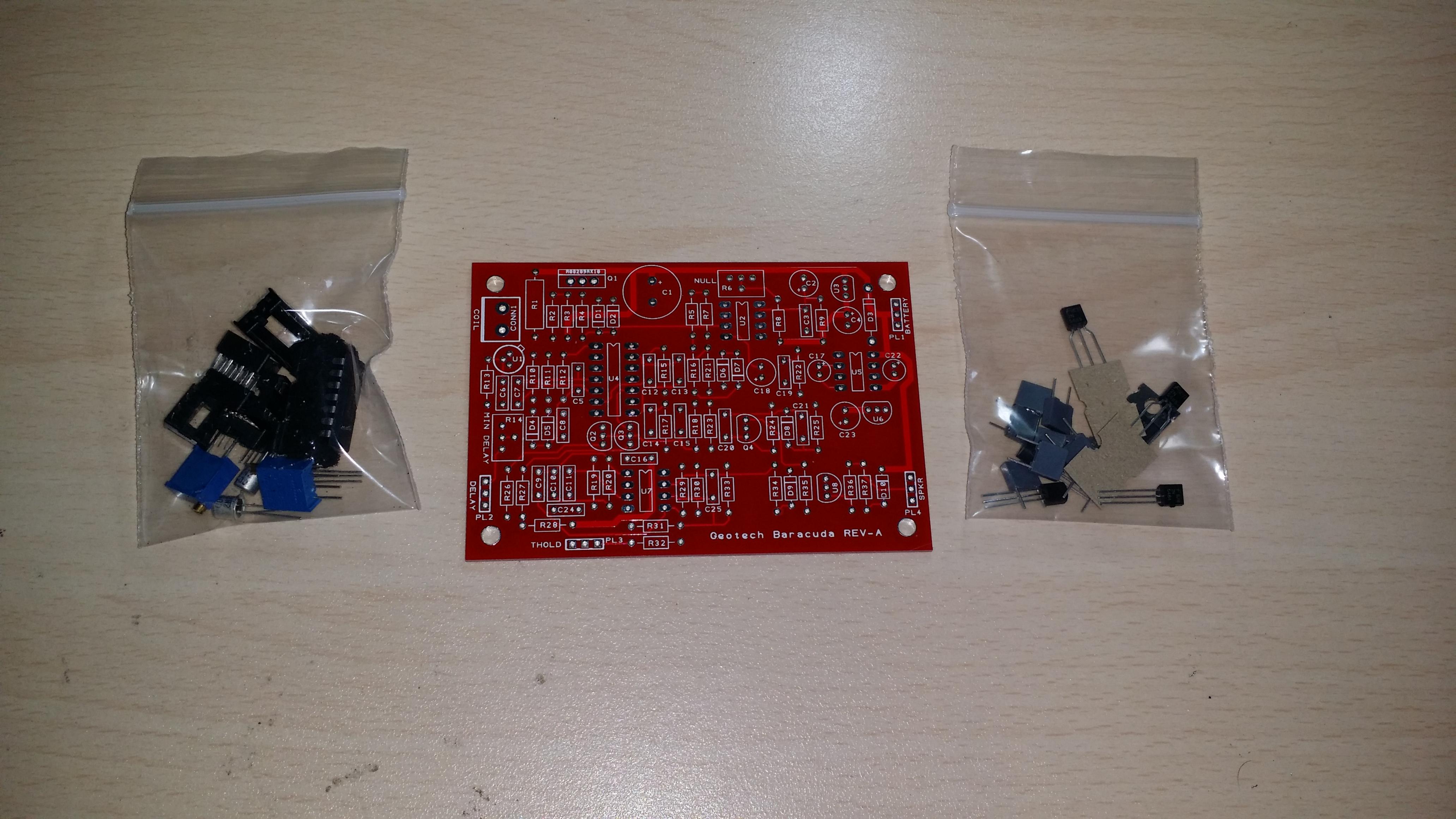

    Hi, today I recieved the Geotech Barracuda Rev A from Silverdog. I ordered the pcb and some components since I had most of the components needed for the project.
    Andy at silverdog was very kind and sold me some components that weren't available on the store. Very nice experience. All the components arrivet at very good conditions.
    Here's a picture of the components I recieved
    All nice and shiny.

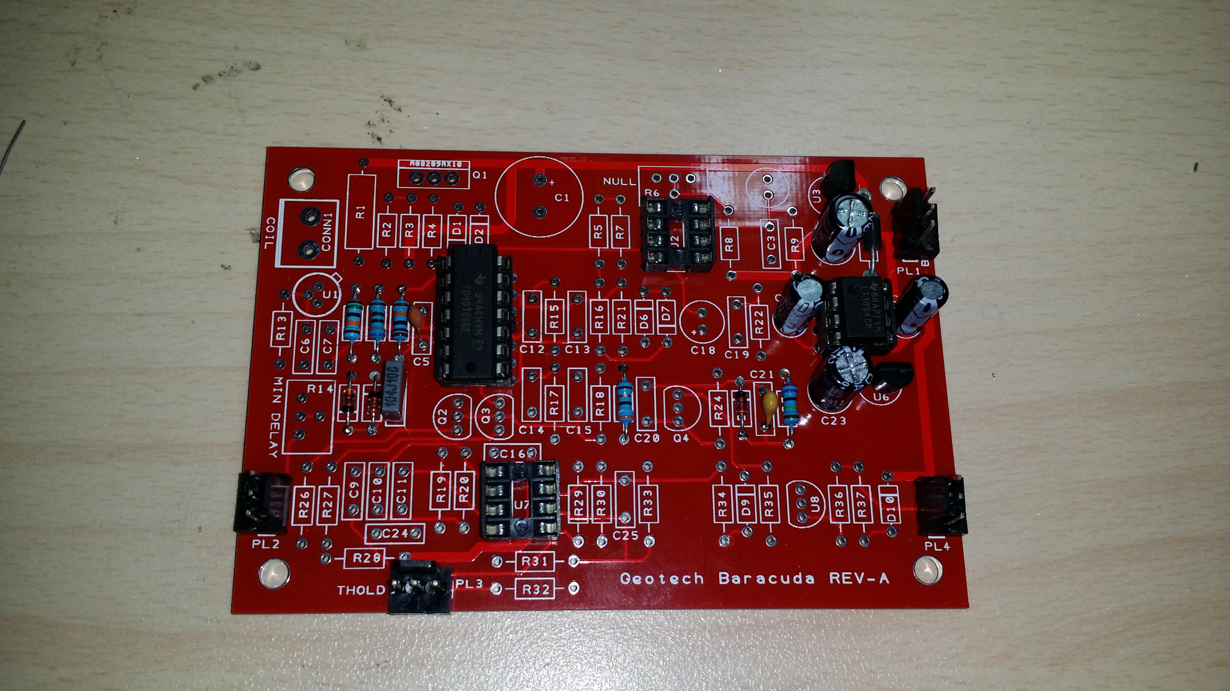

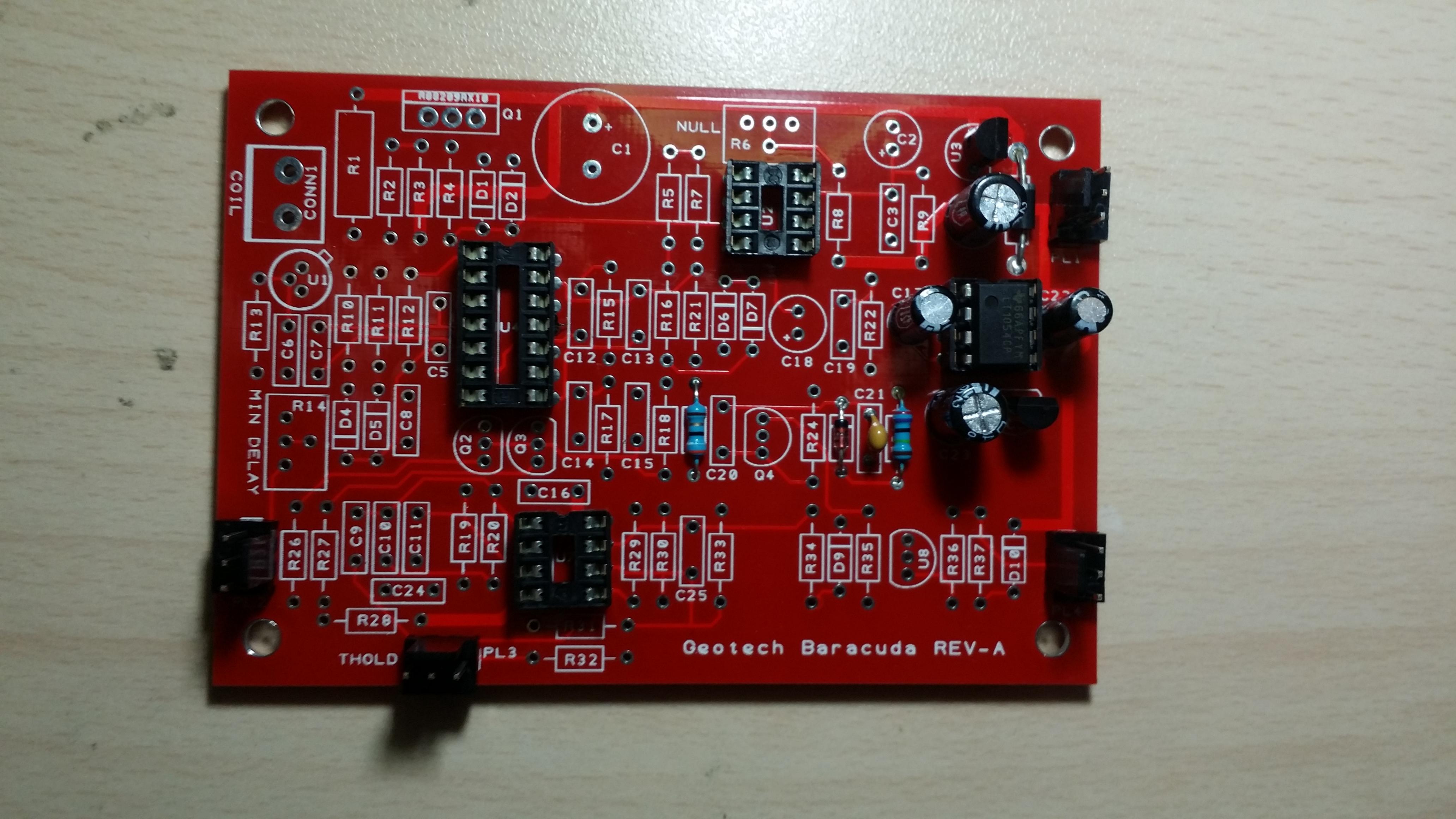

        Update!
        Step one completed, picture here: Click image for larger version
        Step two completed, picture here: Click image for larger version

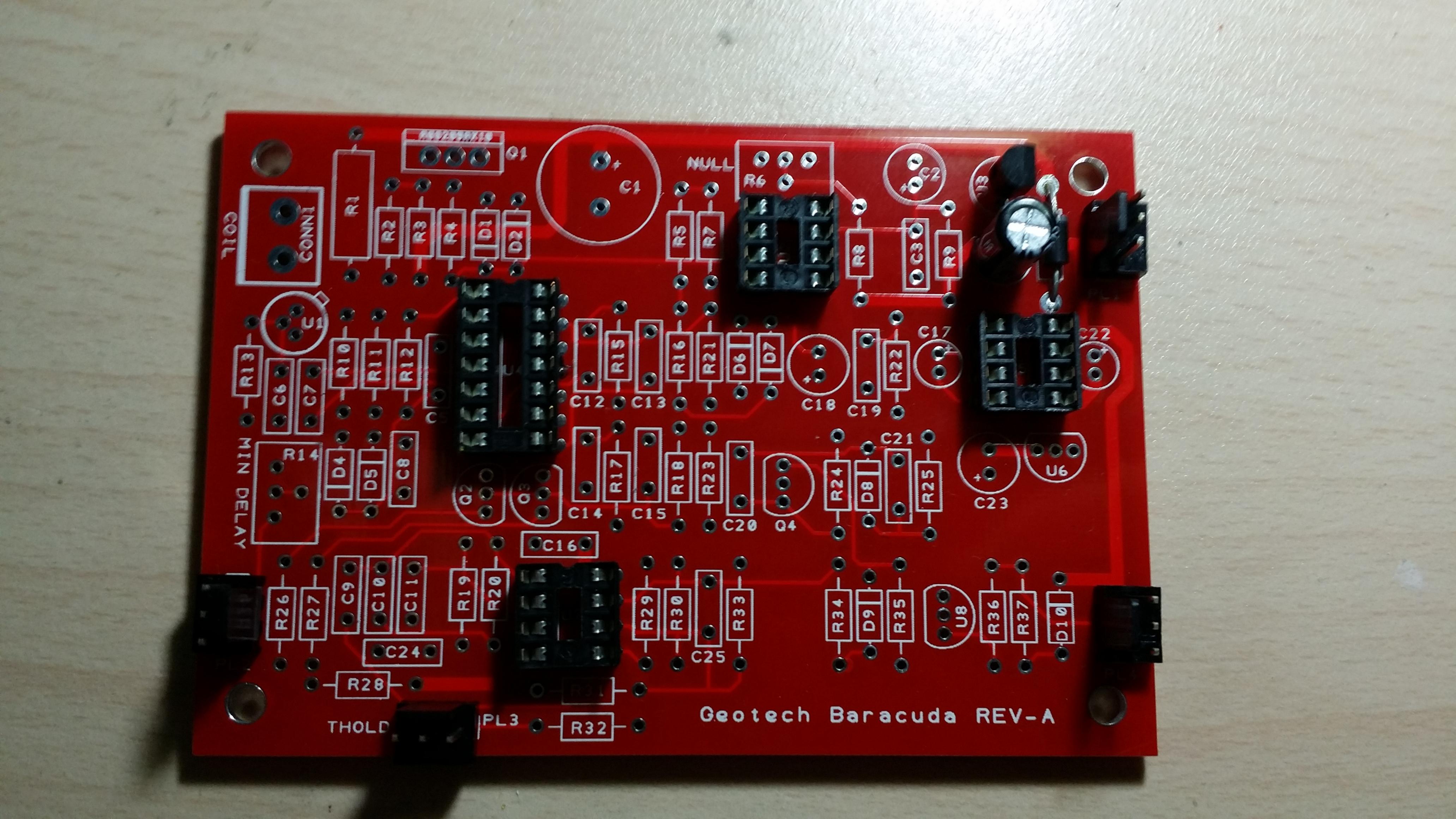

        Step three picture here: Click image for larger version
ID:	347801 can't test it because I don't have a high impedance speaker or an oscilloscope, I will try to find a high impedance speaker, but I've read that there are transformers that adapt low impedance to high impedance, does anyone know about this? Maybe I have some transformer that I can use for this, I take lots of transformers from power supplies and chokes or toroids etc. So I maybe I have something compatible but I don't know what to look for. Anyone knows what can I do to adapt 8ohm speaker to some high impedance value so I can test step three? Thanks
        By the way, for now, step three is as far as I can go, as I don't have received the copper wire yet, and it is necesary from step 4 on. Until I get a high impedance speaker I don't want to proceed with the build because I want to test each step before proceeding.
          i used an old phone speaker 100ohms or so. i think is working with any headphones.
            Headphones! that's right! I opened some headphones and they are rated 32ohms, it worked! Thanks to you I have tested the step 3, it works, thanks
            Step 3 tested and working. Now I have to wait until I make the coil to build and test the step 4
            Edit, in step 2 (-5v supply) There's a 2.2Mohm resistor, I didn't have that resistor and I putted a 2.7Mohm one, it worked nice, I got -5.06v. There are also other resistors that don't seem to be standard, and I only have standard values, so I don't have them, and I will be putting other valued resistors that are similar value there, I will post details everytime this happens, and if it doesn't work, then I'll have to buy it, but I think that the difference is so small it will work
              Well, I've got a problem... I'm in step 7. In step 6 there's a resistor , R14, a 20k cermet resistor that has to be adjusted using an oscilloscope, but since I don't have one, the pdf says that I have to build step 7 (the sampling integrator) and then adjust R14 measuring pin 1 of U7 and set it to -2.1v. Also short pin2 of pl2 to pin 1 or pin 3 because otherwise the voltage will not change.
              Well, I've done that, and the voltage doesn't change at all... Black probe on the battery black wire, red probe on U7 pin 1, and no matter how many turns and which way I turn the cermet resistor, the voltage doesn't change. I've tried both pin 2 with pin 1 and pin 2 with pin 3. Also, I have pin 3 connected to pin 1 because I've read in another thread that has to be done in order to be able to put a potentiometer with 2 cables, that way you don't care which way you connect it.
              Could it be the coil? I built the coil and when connecting it it emmits a high pitch continous tone. When doing step 4 (the transmit tx circuit) I had to put a speaker and measure it in AC mode to test if it was really inducing something into the speaker because I couldn't hear any tone trough some headphones. It measured 5mv when close to the coil, 0mv when far from the coil, so that should mean the tx circuit is working, right?
              I have taken out the cermet and measured it and it works, so the cermet it's ok.
              I don't know what else to do, I need help. Thanks
