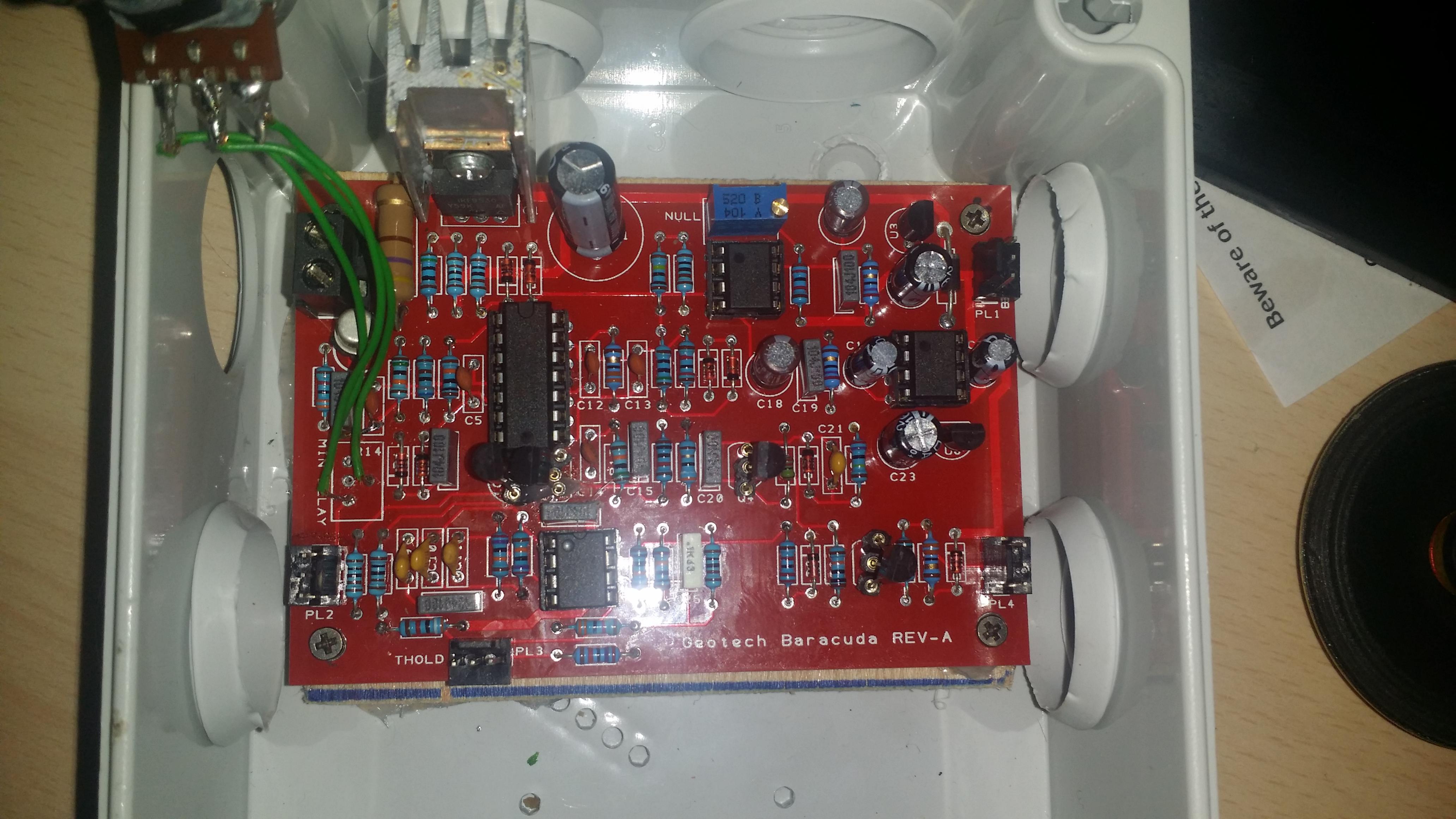

    Can you have a look at R7, R5, R16, no need to remove from PCB, just check the correct value.
    Yes, I have checked them right now, the value is exactly what it should be.

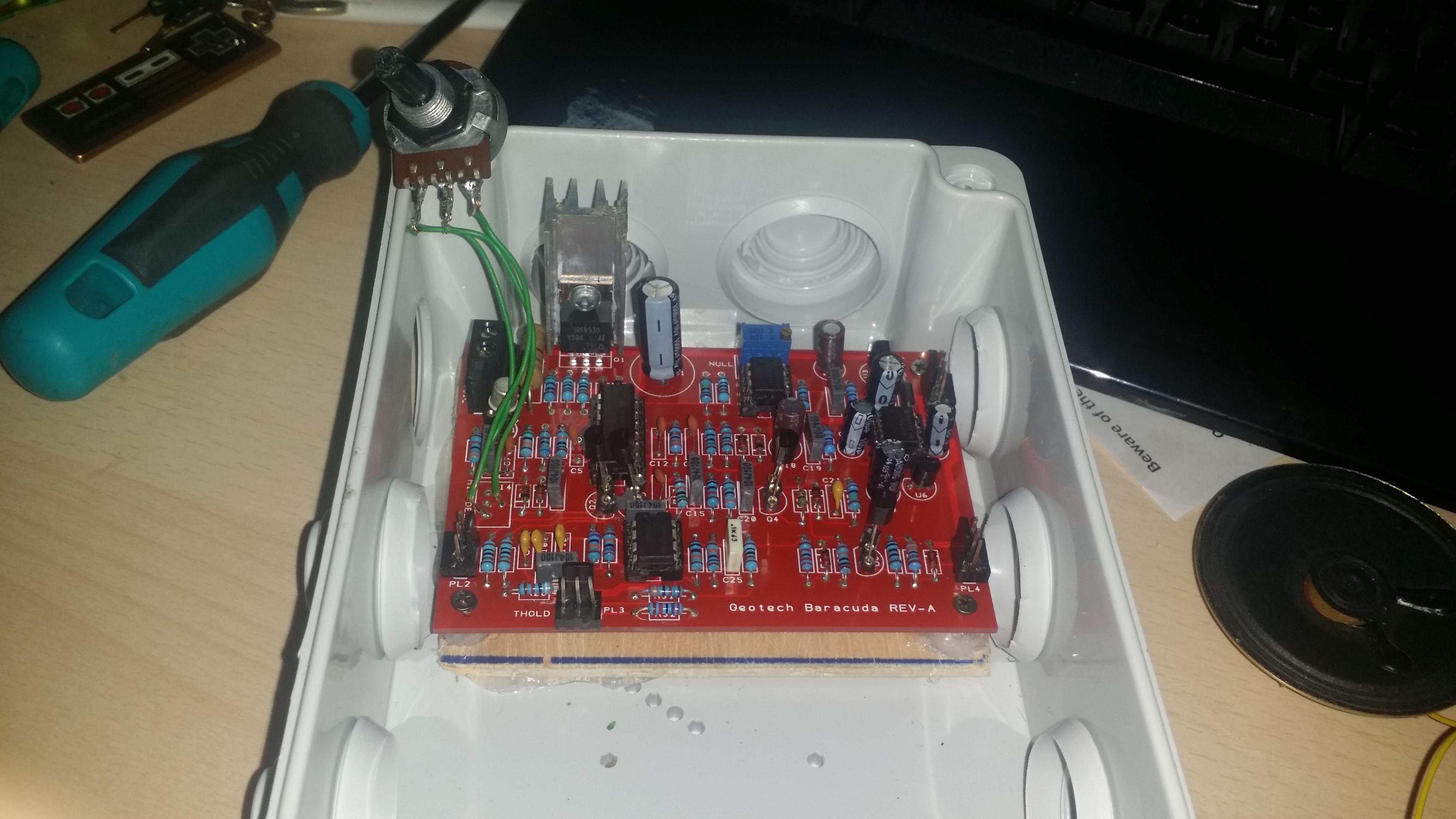

    • #47
      Can you post again your latest photo of your board?
      • #48

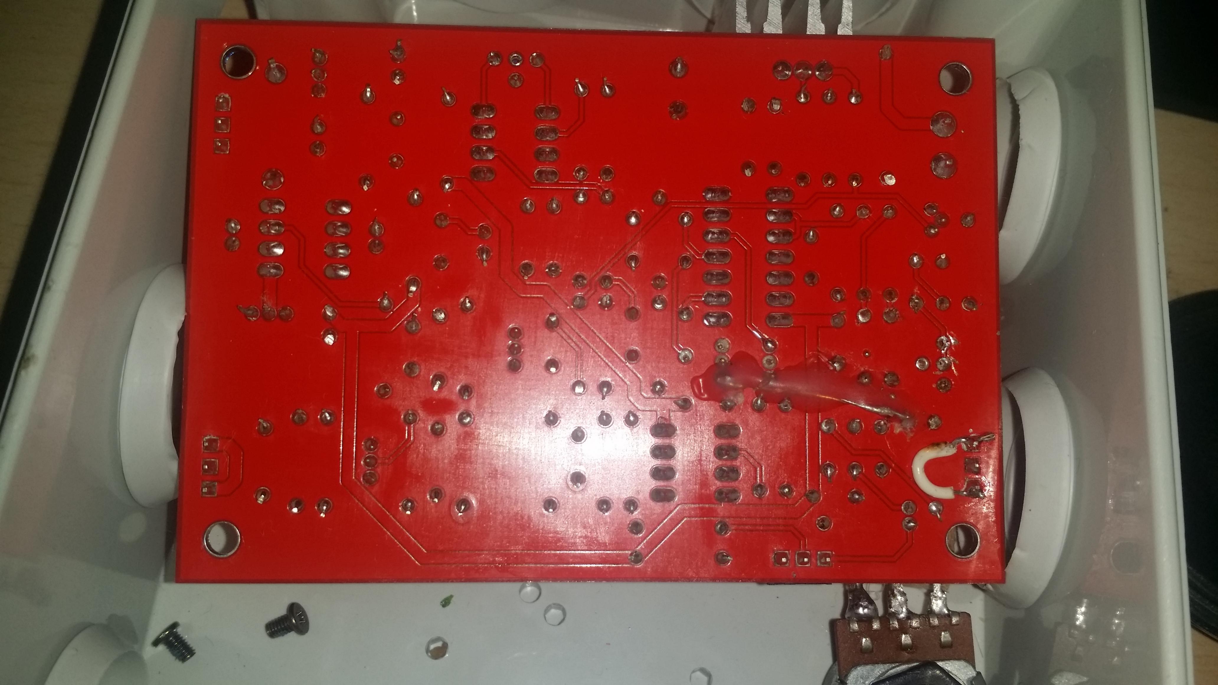

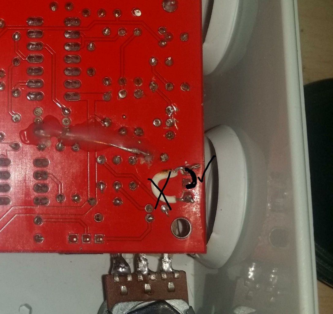

        Sure, But let me point some details xD The hot glue I used for holding those female round headers on the middle of the board is not conductive, there's also a wire sealed with hot glue that connects a leg of the right 2n5485 to a resistor on the left side of the board since I broke the trace and was easier for me to do it that way. It looks like part of the wire is exposed but it's really all covered in glue, you can't touch the wire. I checked for short circuits and there aren't any xD It was hard to do it, and looks bad, but it's actually very solid and stable. On the back of the board picture, r14 pads made short circuit with ground (you can see solder very close to the trace, because I acidentally broke the red cover outside the trace, (r14 is at the right in that picture) so I soldered it on the top side as you can see in the other images. Is tested and working, no more shorts. Again, looks bad but it works xD

        • #49
          • #50
            [ATTACH]39003[/ATTACH]
            But if I short the center pin to the upper pin wouldn't that disable the 10k potentiometer? I putted that because the third pin in pl2 is not connected, connecting it to pin 1 makes me able to connect the pot with 2 legs and not caring if I do center with pin 1 or center with pin 3. And having it connected this way I get the ohms reading on U4 pin 5 so it is connected the right way... Isn't it? Am I understanding wrong?
            • #51
              If you short the pin 1 and 2 you dont need to use the 10k pot. But if you like that the 10k pot still connected then do not short pin 1 and 2. You can short pin 2 and 3 but never short pin 1 and 3 of the pot.
