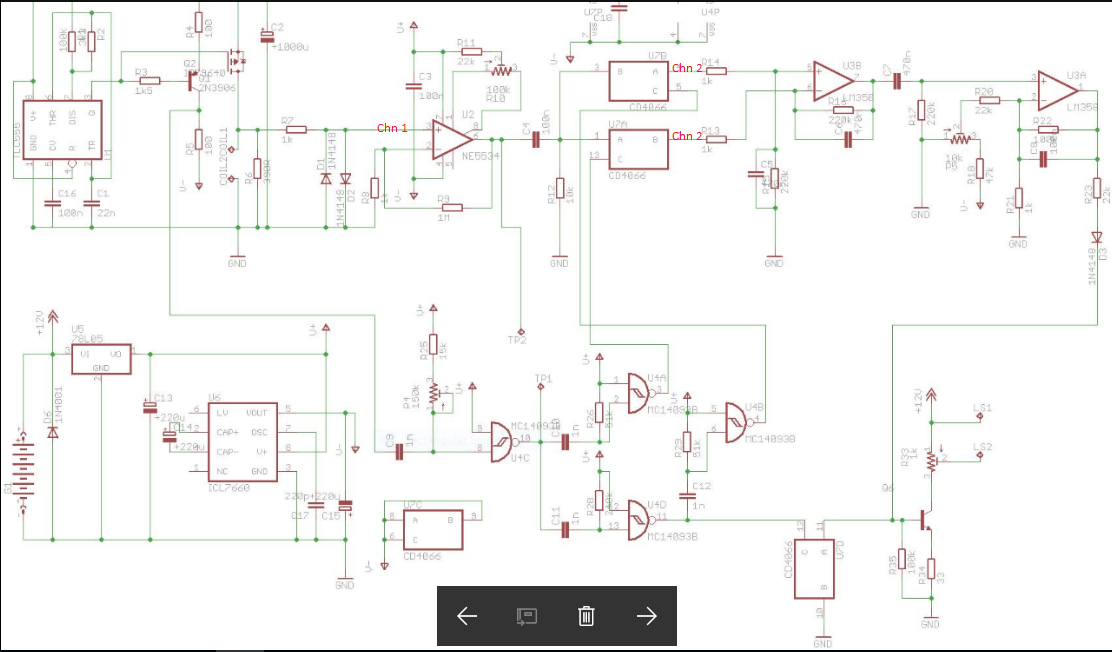

            so whats the best points to take the readings of to set the delay using a duel scope
              http://www.geotech1.com/forums/forum...Published-2015
              good starting book to begin a way into electronics. ITMD. believe me now.
                Here if you want absolute Delay Measures including Propagation delay. Chn 1 end of Tx is the start in time. Chn 2 first and second sample time.Click image for larger version

                    Timings are in the build document.
                    http://www.geotech1.com/forums/showt...roject-Details
                      the timings is there but no details i already looked at that @homefire that's the points i was testing but i used the opamps output, all i was looking for on this thread was a quick setup for people who own scopes and some details and info lol, mines is already setup and working fine i just think this info is missing

                          You wanted Optimal. Optimal for Me in a PI is short as possible sample delay. I seek Low Conductive targets like Gold. You may want Longer Delays to be Optimal for what your looking for. The Three point I referenced are the point you would need to measure to include All Delay after Tx Shut Off

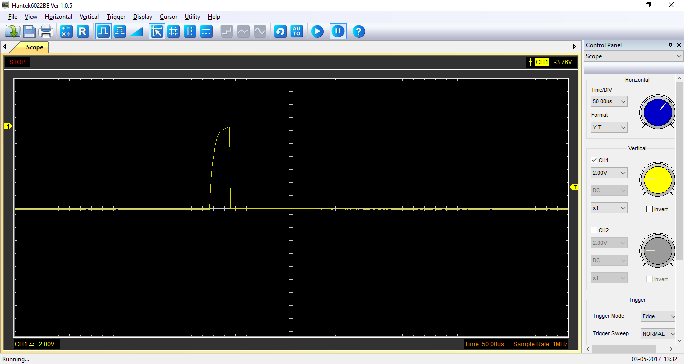

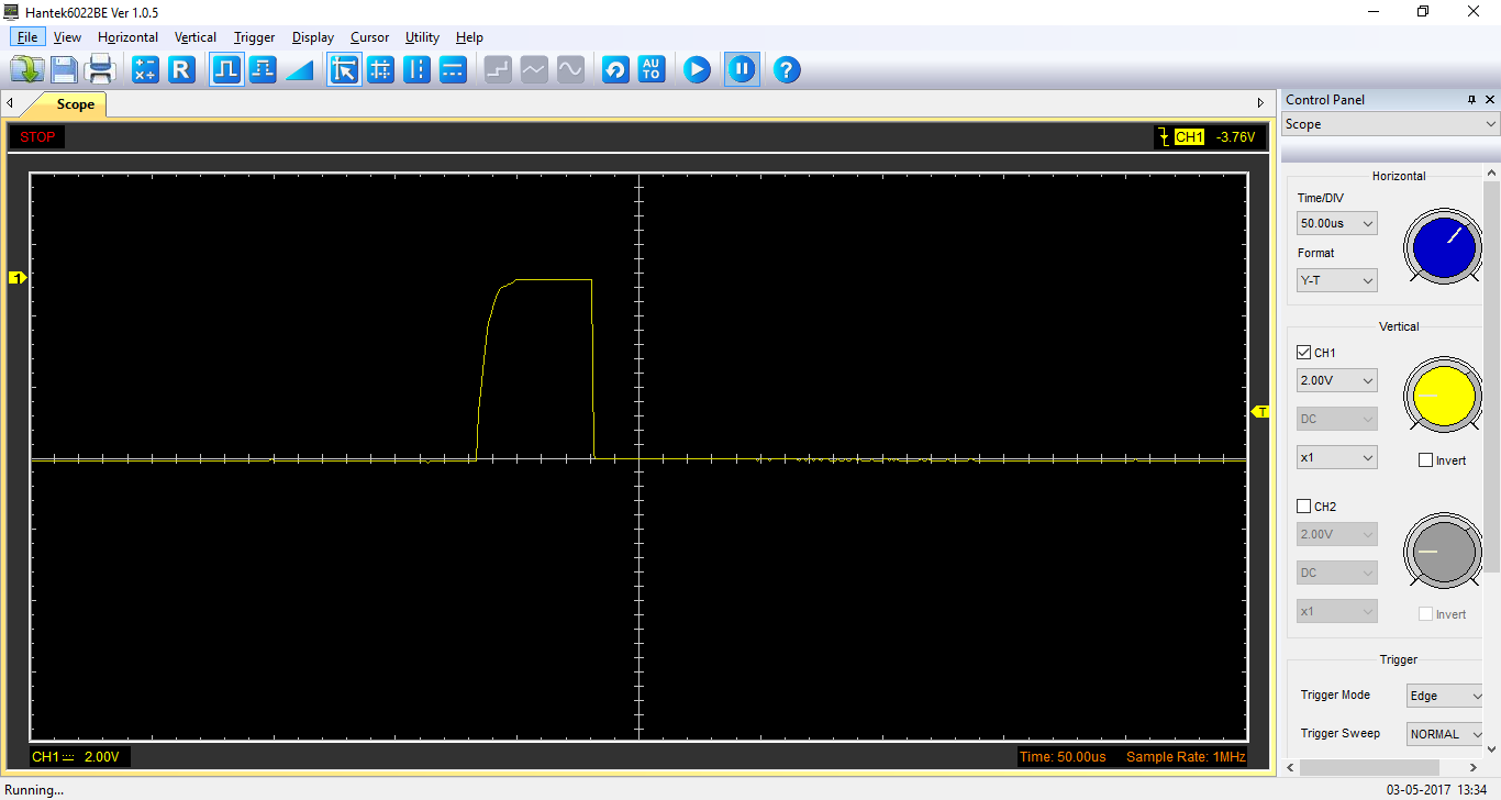

                            this is the way i set it on pin 6 u4 i set the pot to 0 and adjusted the trimmer to the point before it flat tops this seems to be the best setting for the delay
                            and when it set you turn the pot to max resistance you get
                            i would say that's optimal for my coil im using, or am i setting the delay wrong or is there a better way ?
                              Sounds like you doing it right to me. The Rising Edges are your time marks. Using the Test Point I described measures Absolute Delay including Propagation times of the Fet's.
                              I used the Old Schematic showing points for Chn 2 at 4066. On New schematic it would be just after the Fet's.
