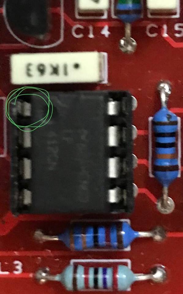

    Have you measured in the right place - IC 7, pin 1?
ID:	352375 u7 pin1 volt -3.62 and I can not adjust it to -2.1volt

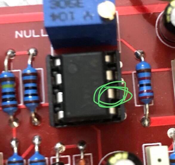

ID:	352376 5534 measure 0.0V to pin 6

              Originally posted by rdz28 View Post
              [ATTACH]44413[/ATTACH] 5534 measure 0.0V to pin 6
              The signal at pin 6 of the 5534 (preamp output) is dynamically changing. You cannot set the null-offset adjustment using a multimeter. An oscilloscope is required to adjust the null so the signal settles at 0V, not so that the average voltage is 0V
