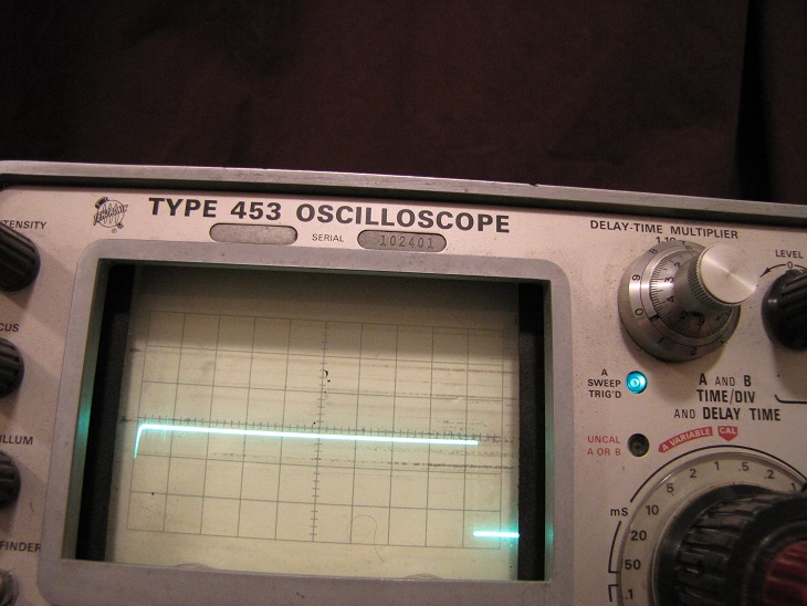

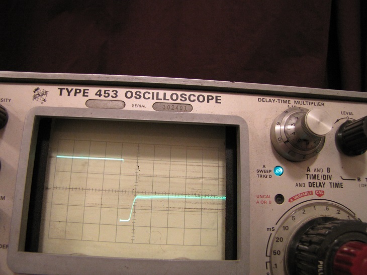

                  Thanks for the response,however i can only confirm the sample width. It changes when i'm turning both the trimmer and the pot. However, due to the triggering i can see only one sweep(or i'm a noob and don't know how to do it properly). Meantime the coil is not suspect any more as on the surf it gives if not decent at least better performance than the mono coil from magnet wire.
                    The photos are ready but i have no time to upload now so will do later. As per what i see and as far as my Tek 453 is calibrated properly i have the following:
                    MSdelay U4 pin 6 20us wit PL2 at 0ohm;
                    MSpulse width U4 pin 10 45us;
                    SSdelay U4 pin8 460us
                    SS pulse width 43Us
                    The 5534 offset despite adjusted with multimeter seems ok on the scope too. Damping looks ok as well.
                    Impression is MSP is wider than the SSP marginally and SSD is 60us wider. What do you think about that?

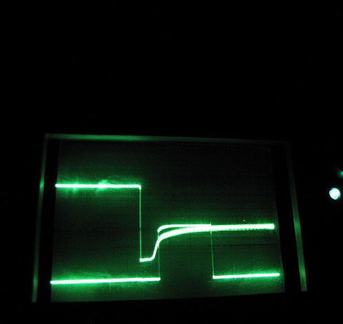

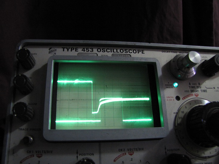

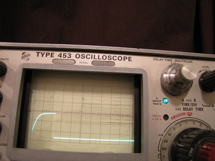

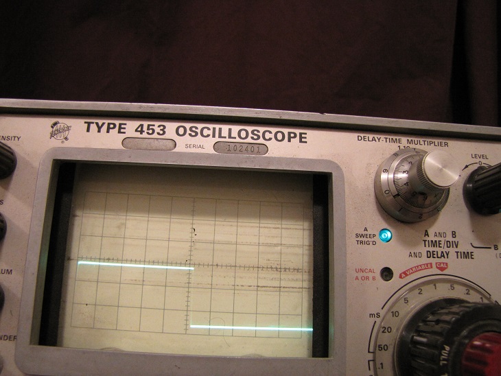

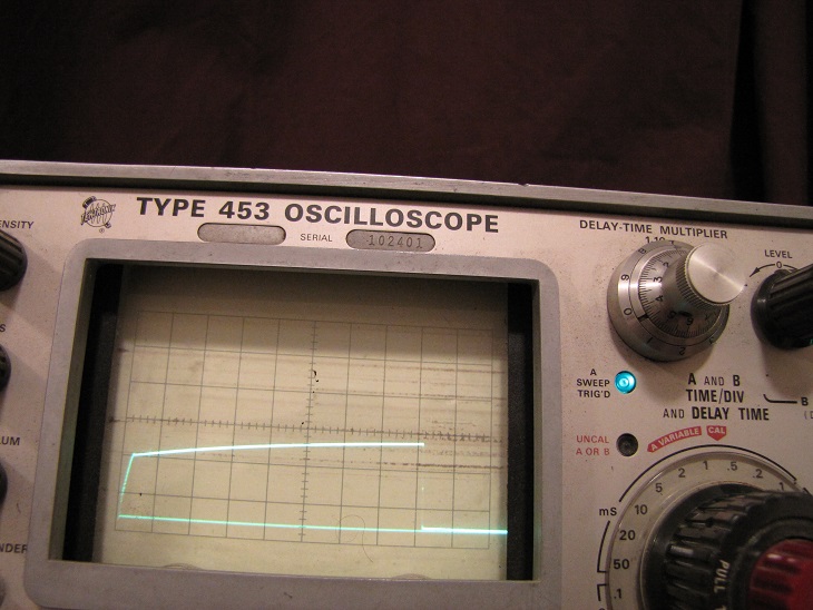

                        Please look at the pics below. Measurements done at 2V/div & 20uS/div ,50uS/div for SSD and 10us/div for MSPW. Regarding the behaviour i'll try to upload video on youtube soon. Unfortunatelly i have no us nickel in hand.

                          The last photo - at which point was there measured?

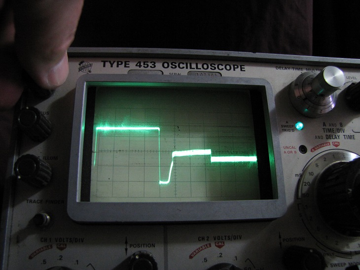

                            The Tek 453 is a Dual trace scope. So I would like to see the Sampling pulse on second channel and the trace of your DMP image that looks to show the Pre-amp output.
                            What to look for is the first Sampling starts near the end of the rising coil decay.
                            Then look at the second sample timing which should take place a bit later.
                            Also while looking at the pre-amp output (DMP image) move a metal object near the coil and you should see the shape the the decay curve change. It will not change by much but should be see-able.
                            • #44
                              Yes, thats exactly the case i think. Does it matter which setting the pot is on?
                              • #45
                                Sorry, it take me more than an hour to find the proper way of holding the probes and remote control of the camera together(god knows where i hide the tripod;-). So i miss the time for editing. Thats why some people have digital scopes.
                                The pics are in three different modes so i hope they give the clue. Do you think it is worth to play more with the offset or it does not make sense? i would like to set it away from interference but the chinese DSO is crap for that and the TEK will need mains.
