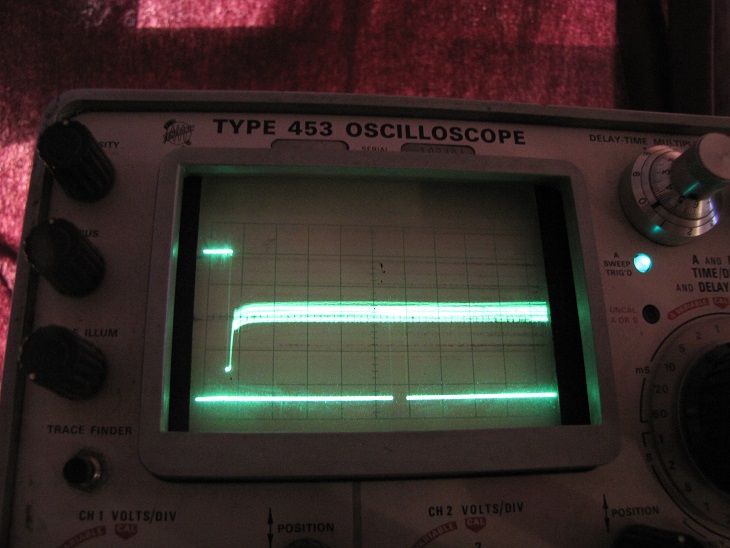

    The last photo - at which point was there measured?
    Secondary sample pulse at pin 12 U4 (thats 10uS /div)
    • #47
      Hm, the signal looks unusual to me, maybe I'm wrong
      • #48

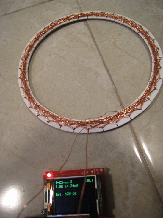

          Coil?
          • #50
            32 turns of 24awg on 190mm OD basket coil, 1,8 Ohm, 340uH
            • #51
              I mean, too many windings for this coil diameter
              Try another coil
              I think basket coils for a terrible crap
              • #52
                With the other coils it is even worse.
                • #53
                  I have to fit.
                  It is probably only a small mistake, but it is to be found.
                  You say the depth is bad, please give an example
                  • #54
                    There's not much point using a basket weave coil with the Baracuda. The reason for that type of coil is to reduce the interwinding capacitance and produce a faster coil for gold nugget hunting, whereas the Baracuda has a single-stage pre-amp and is designed for use at the beach where sub 10us sampling is undesirable.
                    Try making a jumble-wound coil and redo your tests.
                    • #55
                      I think both the first and second sample timings are ok. Here the pic of the second one at 2v/div and 100us/div. About the coil... the basket one is the best performing so far.... Cant think of it as a rubbish. Do you all agree about the rest that offset and damping is done properly? May start checking with different manufactured 5534 ans 40106?!?
                      • #56
                        there seems to be a lot of ringing or interference on that?
                        • #57
                          The delay should not be below 20μs for this circuit
                          • #58
                            Yes interference.
                            Please clarify which delay you mean? I have no delay below 20uS.
                            • #59
                              No answer but anyway. Just get out in the courtyard and the performance is better now. However i don't have yet the appropriate coil for it so the tests are done with the surf PI one (220uH 1.8ohm).

                              • #60
                                Good, that shows it was probably AC Mains causing interference/noise.
                                2. If the damping resistor is set what might be the reason for the coil ringing?(happened only with the basket coil).
                                Coil has more C than the coil the damping R was chosen for.
                                I place a higher value damping R on the PCB then add inside the coil's cable connector anther R (in parallel) to obtain proper damping for that coil.
