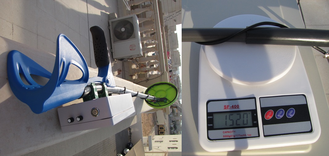

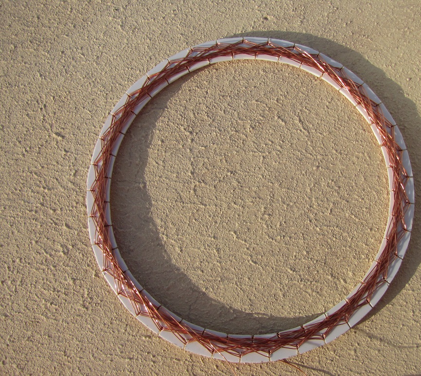

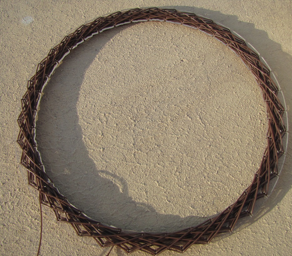

              To KT315 - please see the coils and give me your opinion. I've done all as per the instructions which seem more than clear. The enameled one is exact copy of the Plantilla coil pdf. The other one is expanded form of the same to reach 30cm OD.

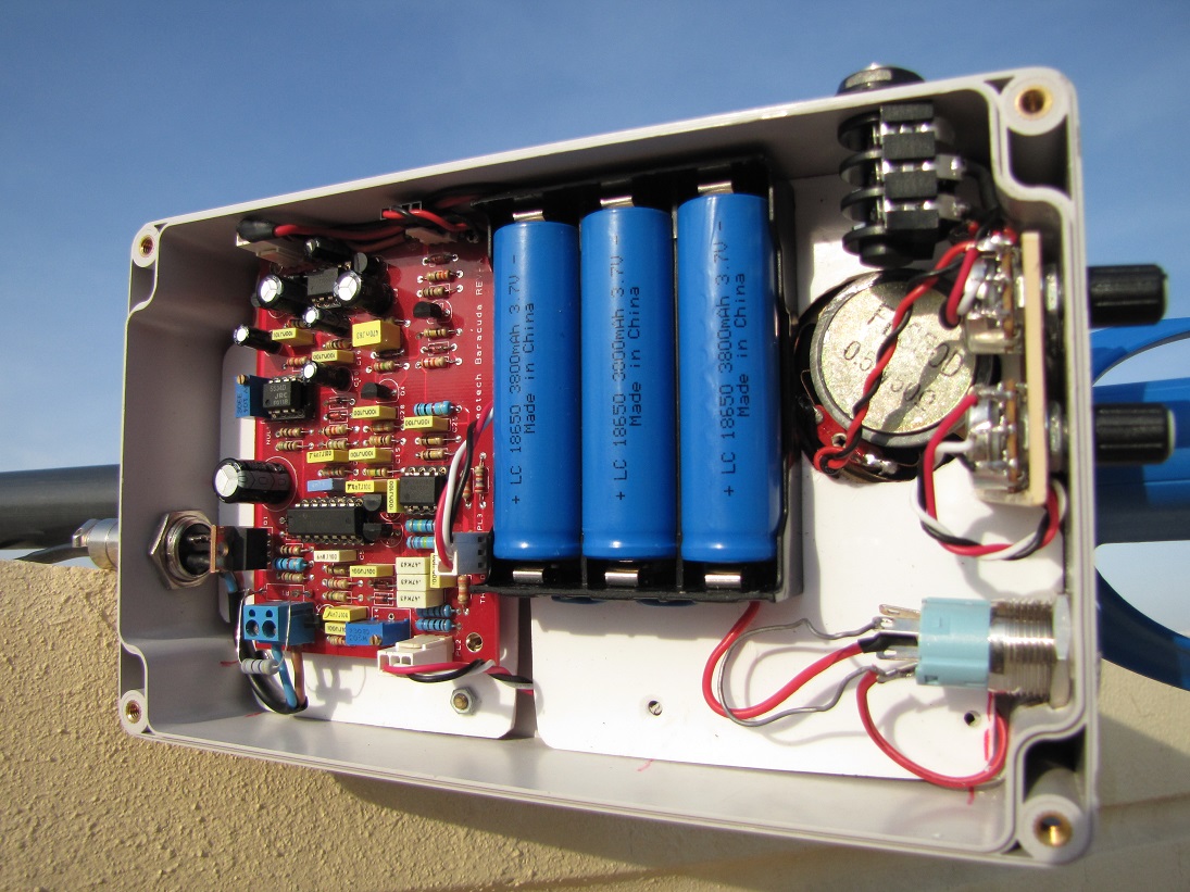

              Further there are some photos of the nearly completed "end product" ;-). Shaft made of 1/2 and 3/4 PVC pipes. Coil housing made of Cake pot. Pipe clips 1/2 & 3/4 are used for control box and coil attaching. The weight is around 1,5 kg but can be reduced by using piezo instead of speaker and fishing rods instead of PVC.

                your coils seems bad for me. i grasp you did not do a transfer step after every 5 turns.
                you read unattentionally the forum. thats bad. i told about basket coil millions times but people do mistakes
                every time. even i did ESPECIAL photo where i showed how to do transfer step but
                anyway people are not able TO SEE it like the blind squerrel. people are merciless in their pursuit of the stupor.
                http://www.geotech1.com/forums/album...chmentid=43266

                      i say again NK. i had did ESPECIAL THREAD where i DID CLEAR TOLD how to make RIGHT basket coil.
                      i did so because this forum is similar to a swarm of angry bees flying in different directions.
                      I feel,like i misunderstood the words layer(слой) and turn(виток).
                      after every new layer you must do A STEP and then to begin new layer. LAYERS MUST NOT BEING PUT NEW-ON-OLD.

                          I have bad experience with fake 5534 chip, causing poor sensitivity, coil after coil did I make wasting time and growing older in the process.
                          It was only when I ordered new chips for another project I decided to try the new chip on bara, and realized huge difference.
                            I don't see myself toting a bottomless bucket around the beach. People may think me insane.
                            Had the same problems with 5534 from china and other chips as-well, and there were 18 10 turn Pots, only 5 were good! all from the same Chinese seller, called Alice1101983
                            • #74
                              Yes, the 5534 problem was long override during the surf pi project. Lucky I bought only five ic's at a local shop. The rest cost me three times more but work as a charm. I'm getting JRC one here and original TI from Farnel.
