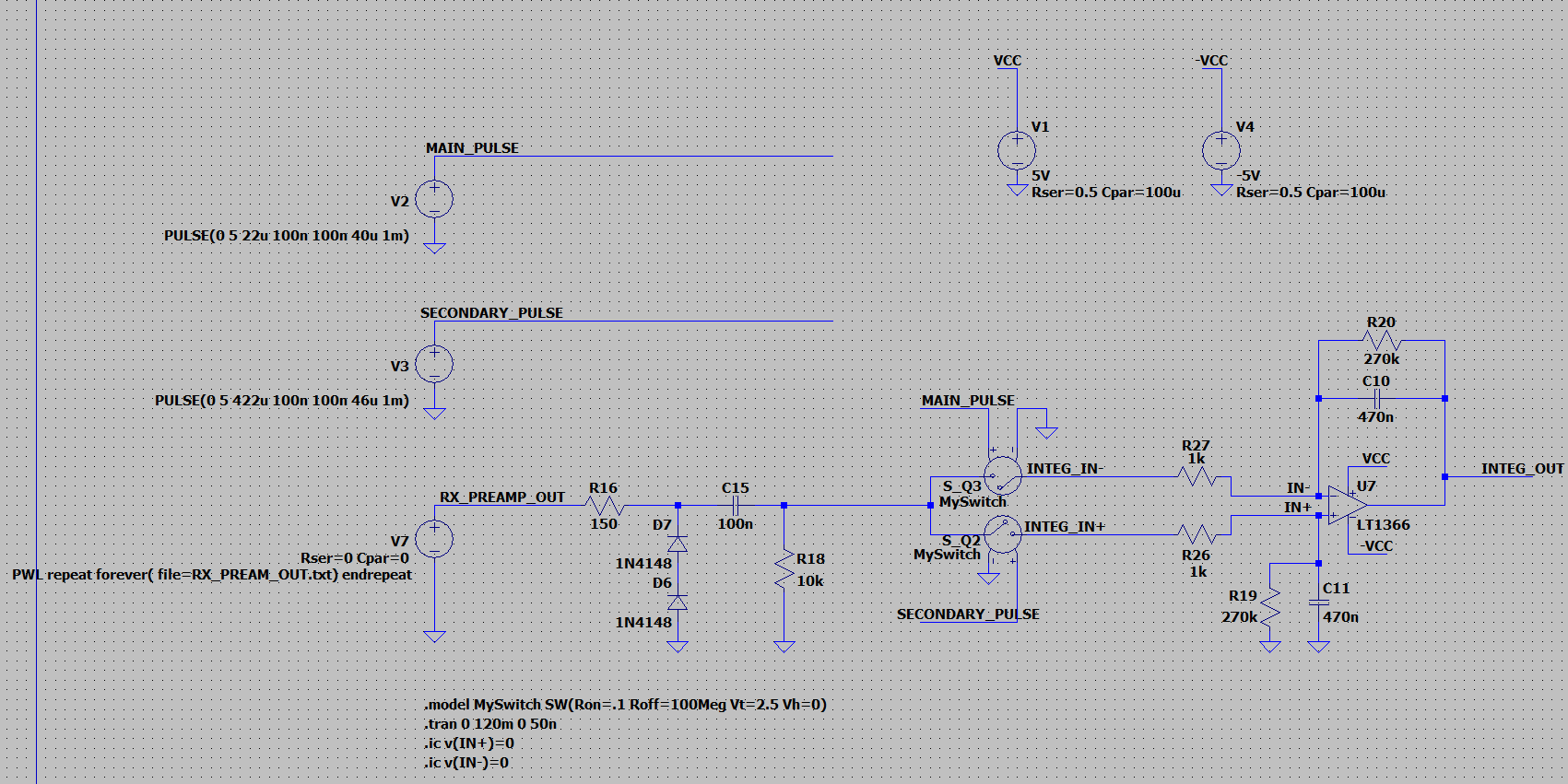

    I have difficulties in understanding how the sampling integrator is operating. I do not currently have a Baracuda itself and it seems to be out of stock in the diyDetector store. I'll place a separate post in the trade section of the forum to try and obtain one.
    Until I get one, I am trying to theoretically analyze (LTSpice simulation) and understand the operation of the integrator itself. I was already able to separately build the preamp and TX circuit, so I am able to get a meaningful signal out of the preamp circuit. I measured this signal with a scope, I captured the waveform in digital format and I am able to feed it (in the LTSPice simulation) to the input of the integrator. The picture below indicates the LTSpice simulation circuit. The V7 supply is a PWL source generating the output of the RX preamplifier, as I have captured it with the oscilloscope. I have simulated the Q2 and Q3 transistors with ideal switches.

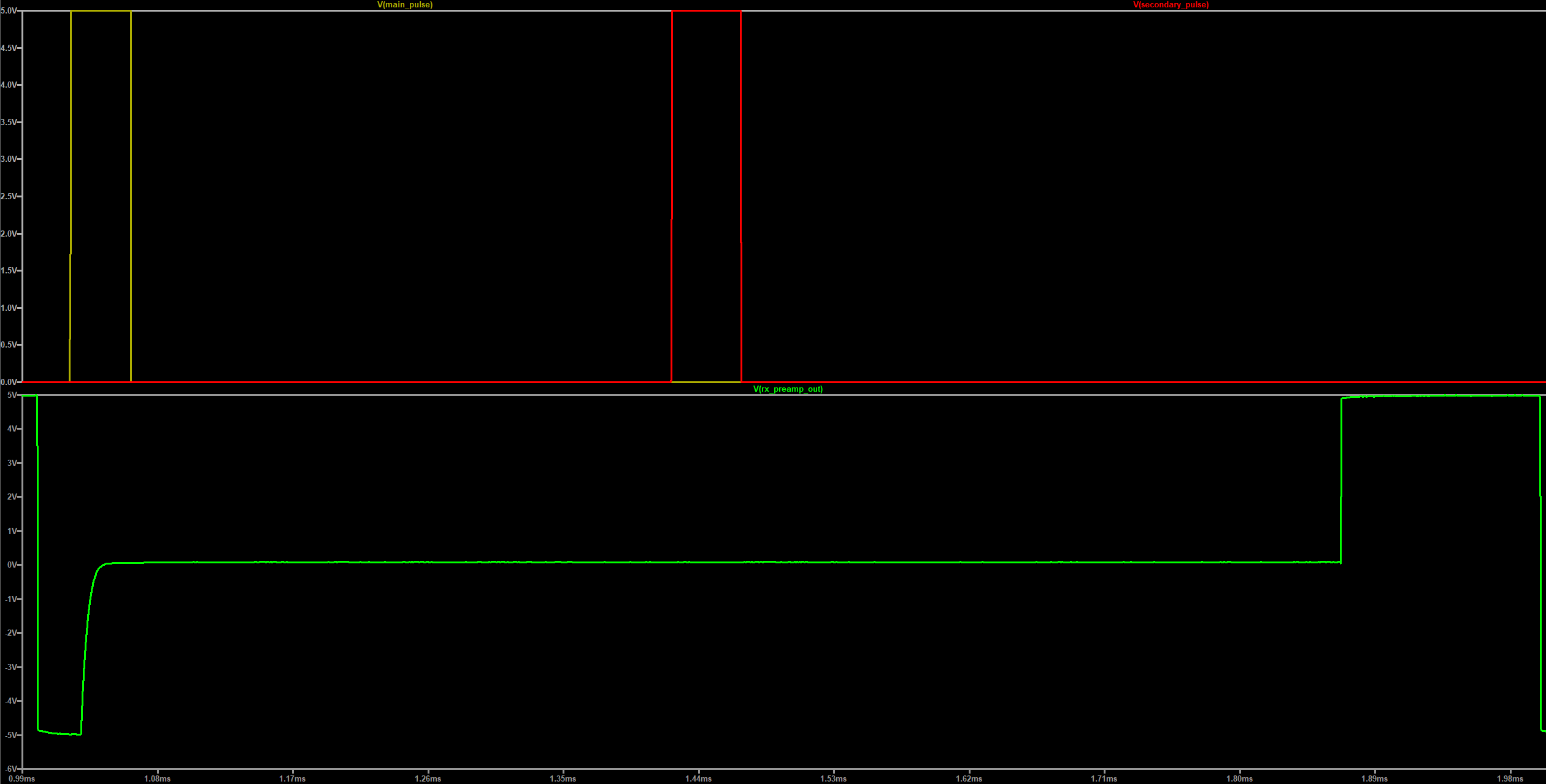

    The picture below shows a period of the RX amplifier output, and the timing relation of the Main and Secondary pulses.
    Single period RX Preamplifier signal

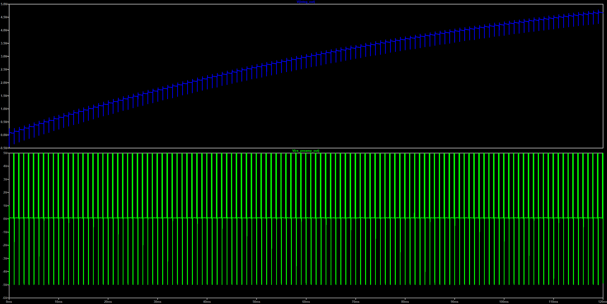

    I run the simulation by repeating this single period at the input of the integrator a number of times (1kHz repetition rate). The voltage at the output of the integrator gradually increases during each period, until it gets into saturation (see next image below).
    Multiple period RX Preamplifier signal and integrator output
    From the documentation, however, I understand I should obtain a DC signal at the output of the sampling integrator. Any idea on what I am doing wrong?

    Your target simulation looks like what I would expect for no target. Looks like you start sampling when the amplifier is still saturated, to soon.
        Yes, you're sampling too early. You can do that but will need to also apply an offset.
          Integrator time constant=about 125us. You need to sample over 5times longer to reach steady state.
          Integrator gain over 10. Average volts during the sample needs to be .4V or less.

              Yeah, as per the forum rules, I cannot amend the first post, so I am adding here the pictures and attachments mentioned in the post. In addition to these, I have also added the zip file with the actual LTSpice simulation, if you would be so kind to check it. BR, Cristian
                if a metal target is continuously kept under the sensor coil, the the integrator output will eventually saturate at the upper rail
                If it were a true integrator, no feedback resistor. Feedback resistor limits gain, gain=Rfdbk/Rin*sample rate*sample time.

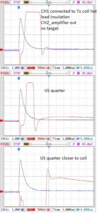

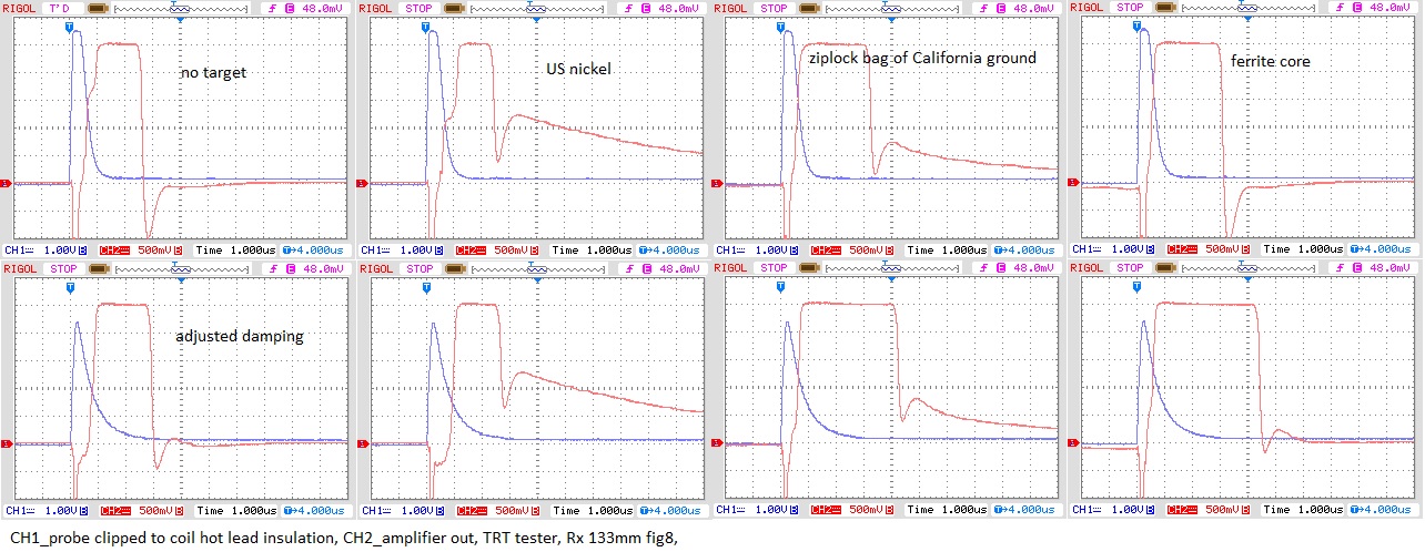

                          Some scope traces I posted in another thread. Think sample could start after 4usec delay in top row, maybe 5us delay bottom row. No target signal doesn't need to be zero when sample starts(maybe less than 1/2 full scale), just needs to repeat. Ground could cause a signal which doesn't matter if it doesn't change. Probably not true about ground signal since it is going to change, would need to take a second sample to ground balance.

                            You can sample into the static decay curve, but the more of the curve you sample the more offset you get at the integrator output. Usually this will reduce the dynamic range of target responses. One way to compensate is to slightly underdamp the coil. Another is to inject an offset current into the integrator. This could even be implemented with an autotune loop, which might have other interesting possibilities.

                              Some scope pictures with US quarter for target. If I started the sample while amplifier out was full scale positive the signal would go the wrong polarity in the beginning of the sample. Wondering if something similar happens with Baracuda circuit?
