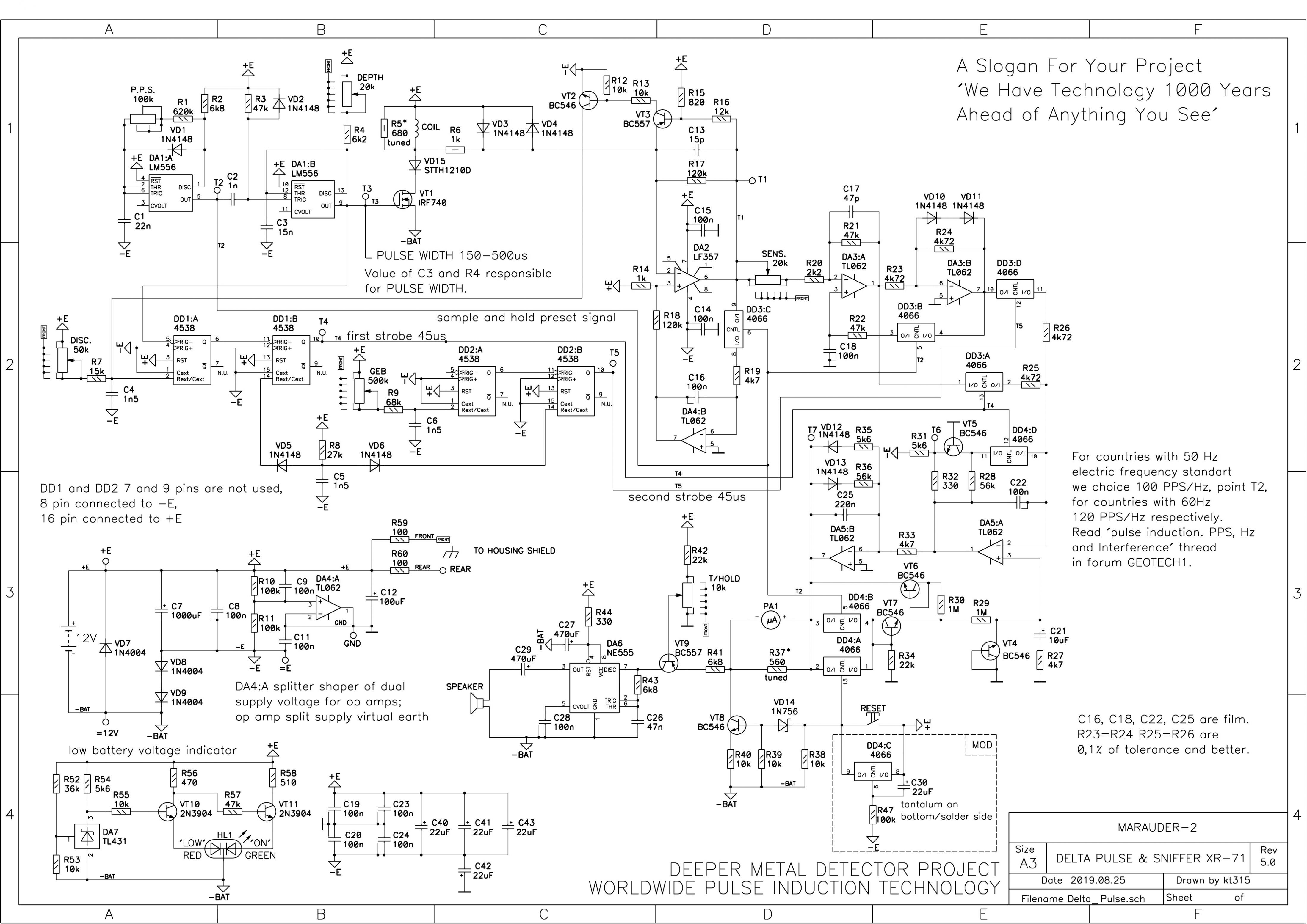

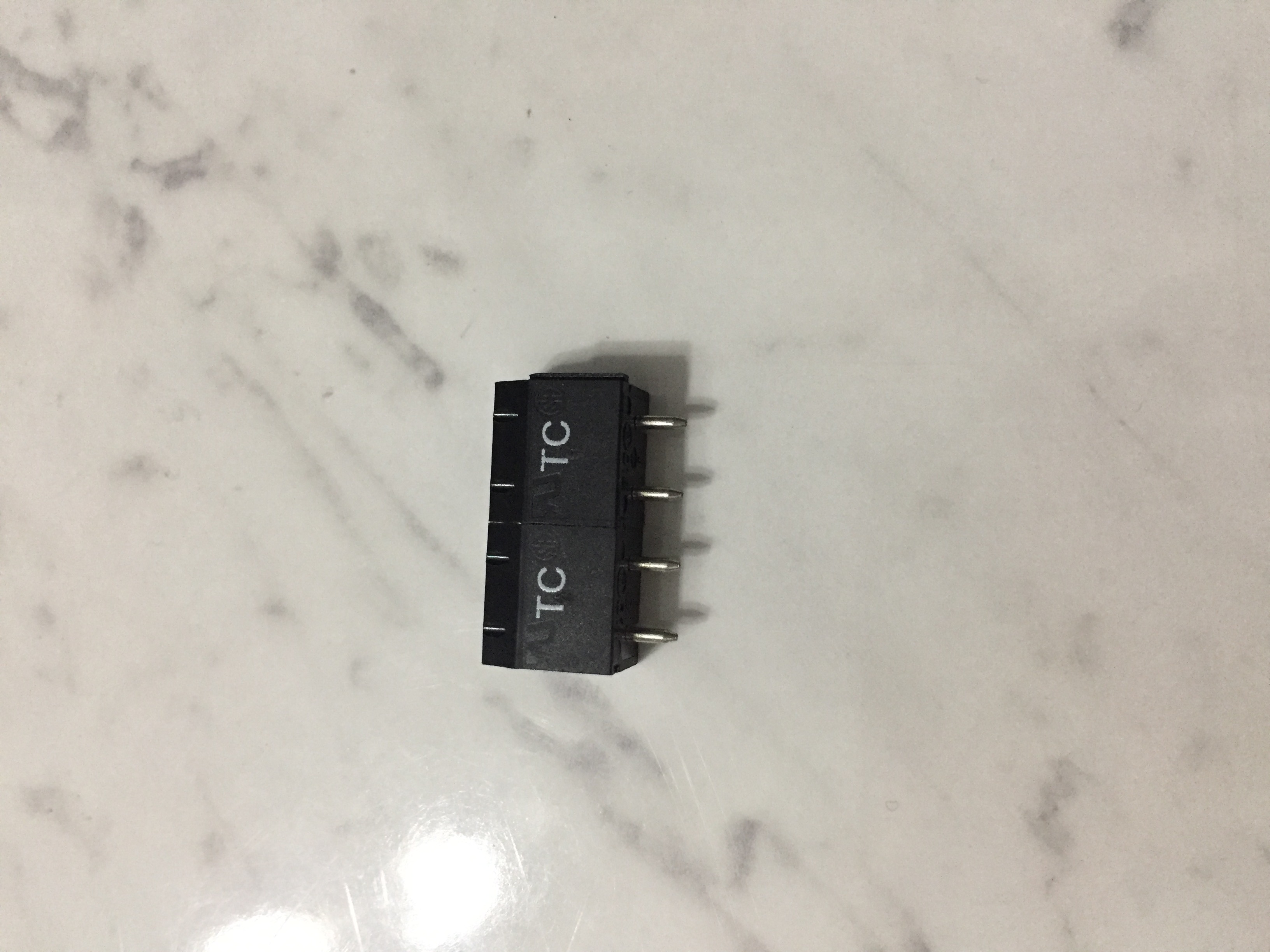

        now which pin with which must be connect??

          seems good. why on the board its are not good? resolder and do right. be accurately.
          anotherway your board will turn in garbage. First Rule. accurately soldered board is working
          right from power up connection. you did unaccuratelly.
            pin one ground
            pin 2 power
            pin 3 coil
            pin 4 coil
            is that ok?
              All the other pcb that I made the connection with the coil was seperate so I didn’t realize that must me that way
                I replace the terminals but still I don’t have sound can you please help??

                    every component has to be checked before soldering, by measuring. resistors, caps, transistors, etc, all.
                    if you do not do that (laziness) you get headache. what type vt10 vt11?
                      schematic
                        Every resistor capacitor is checked the only parts that I didn’t check is the 4066 the tl062 lf357 lm556 and the 4538
                          2n3904 is vt 10 and vt11 the lm556
                            Now I saw it the lm 556 is n556n can be a problem??
