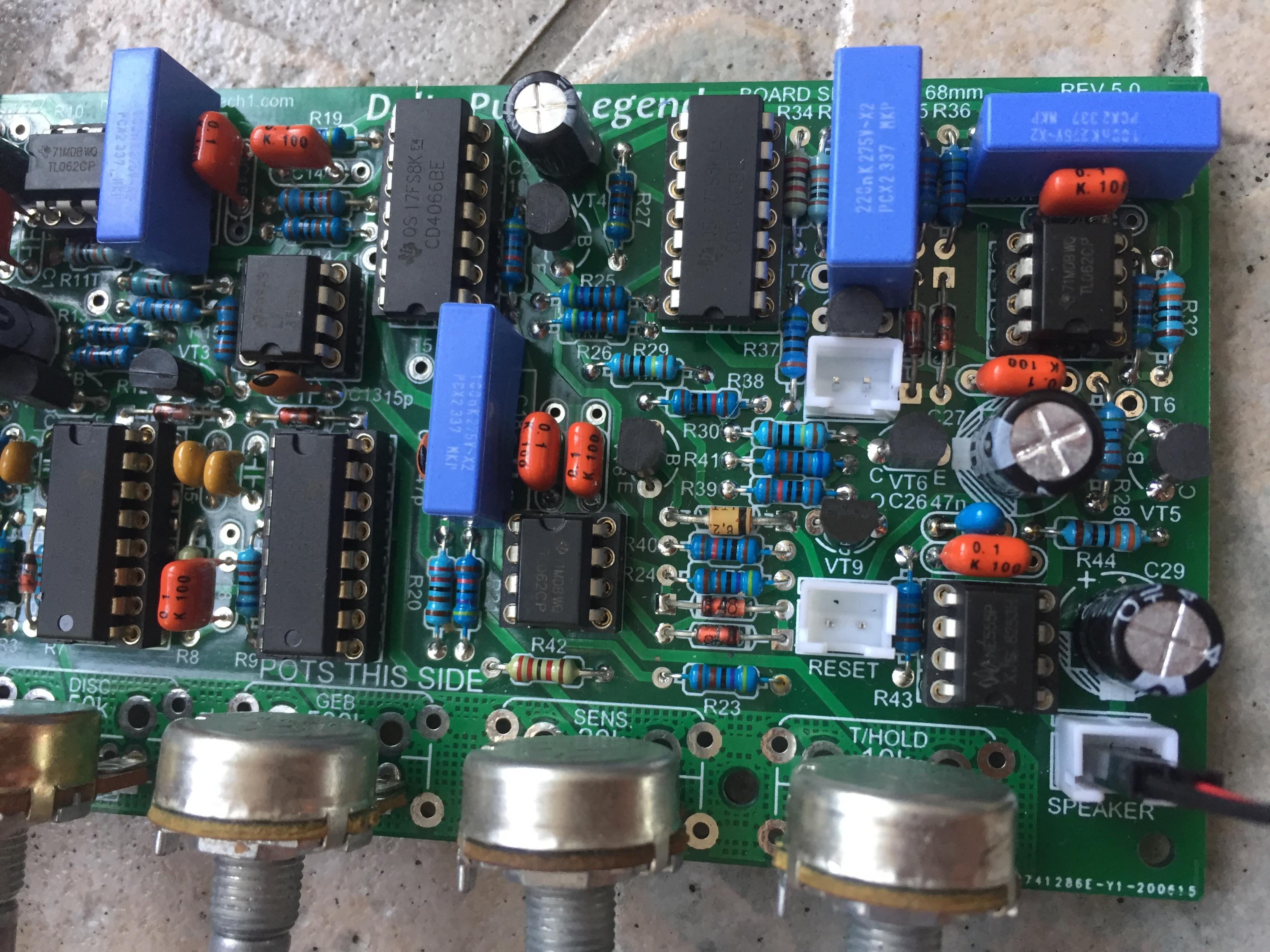

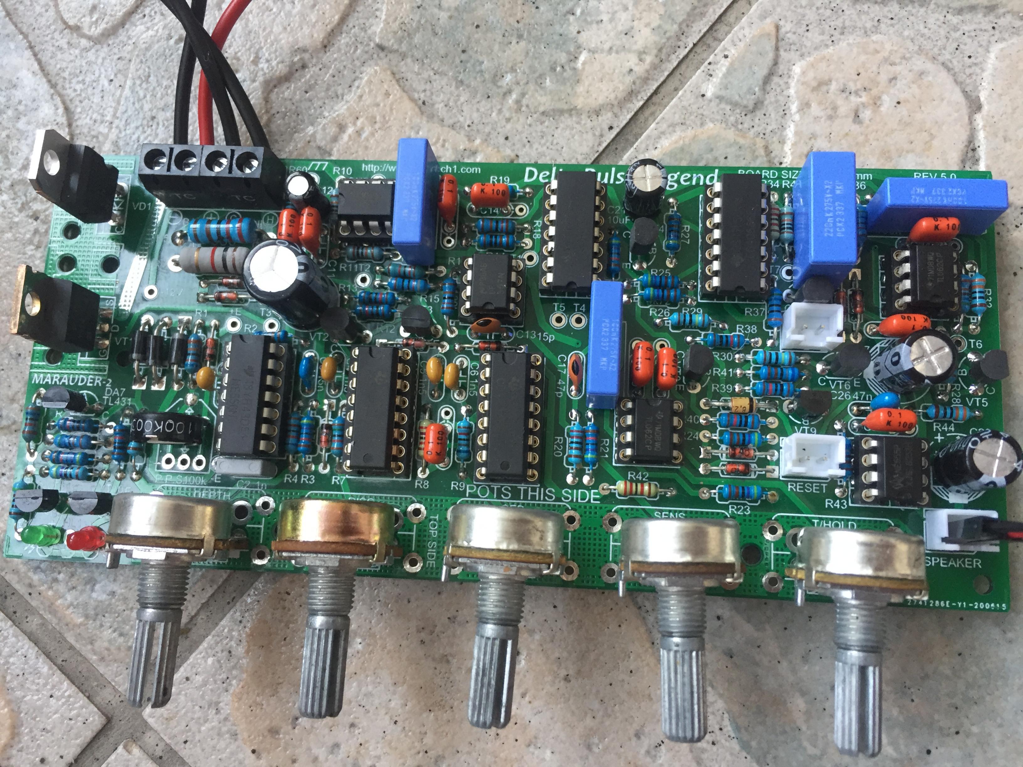

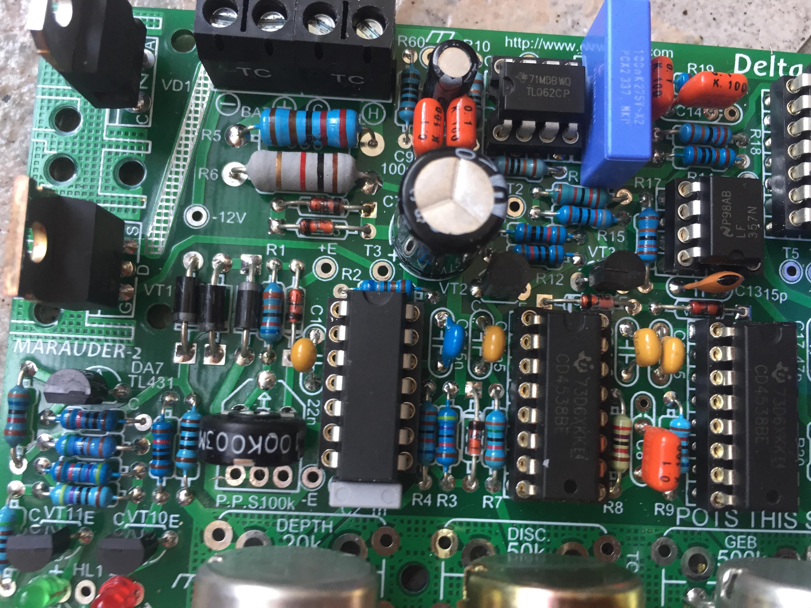

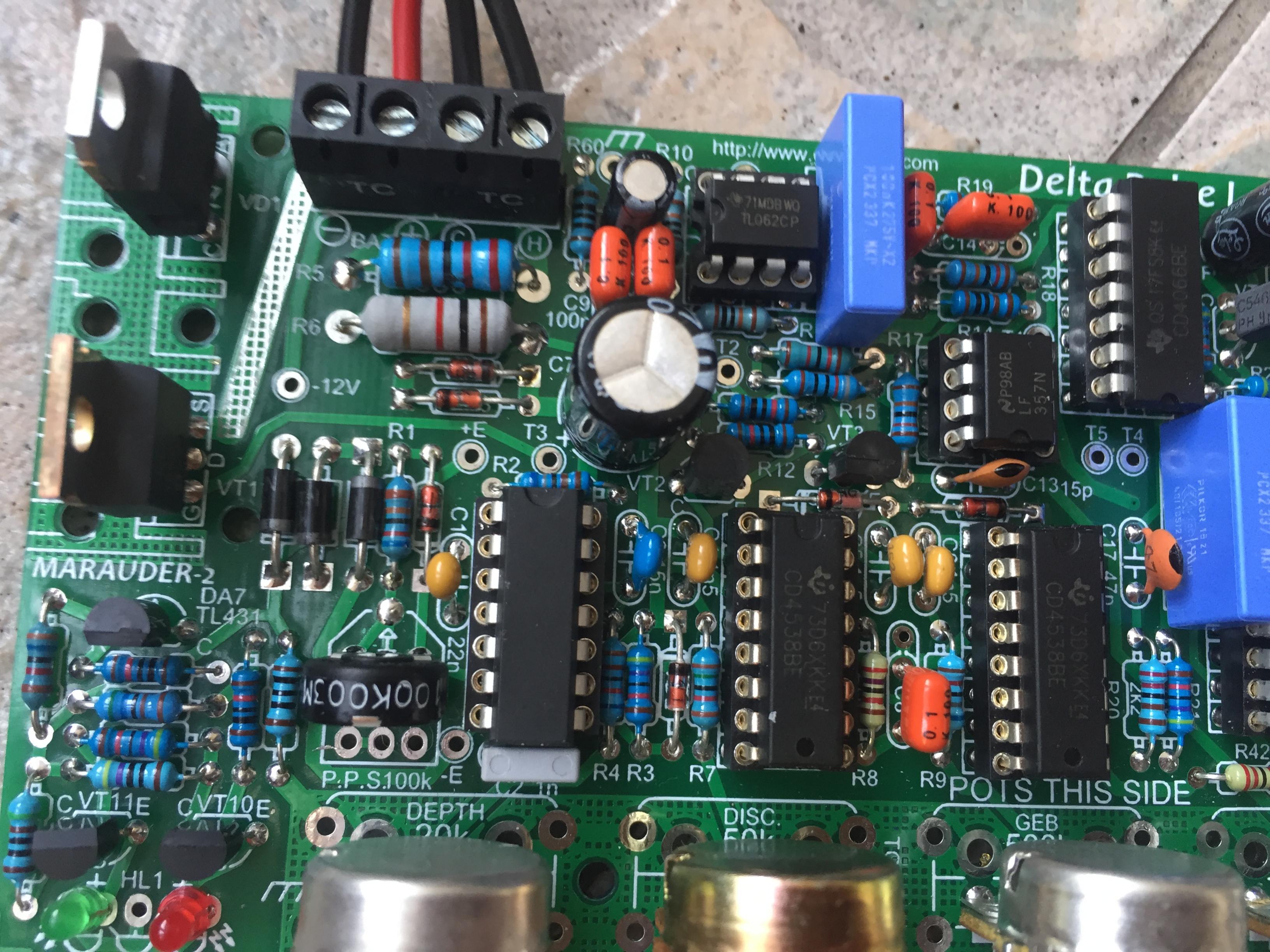

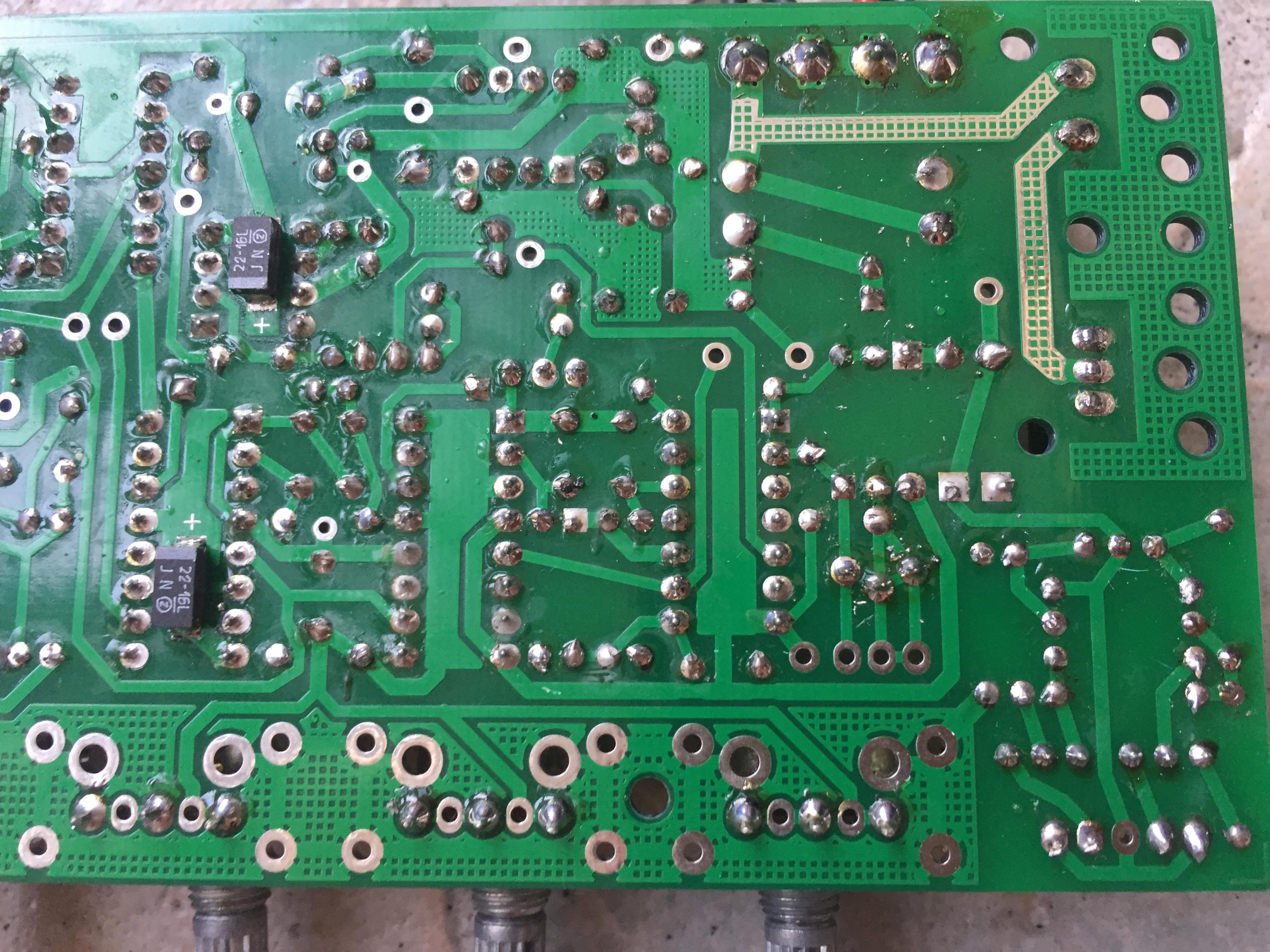

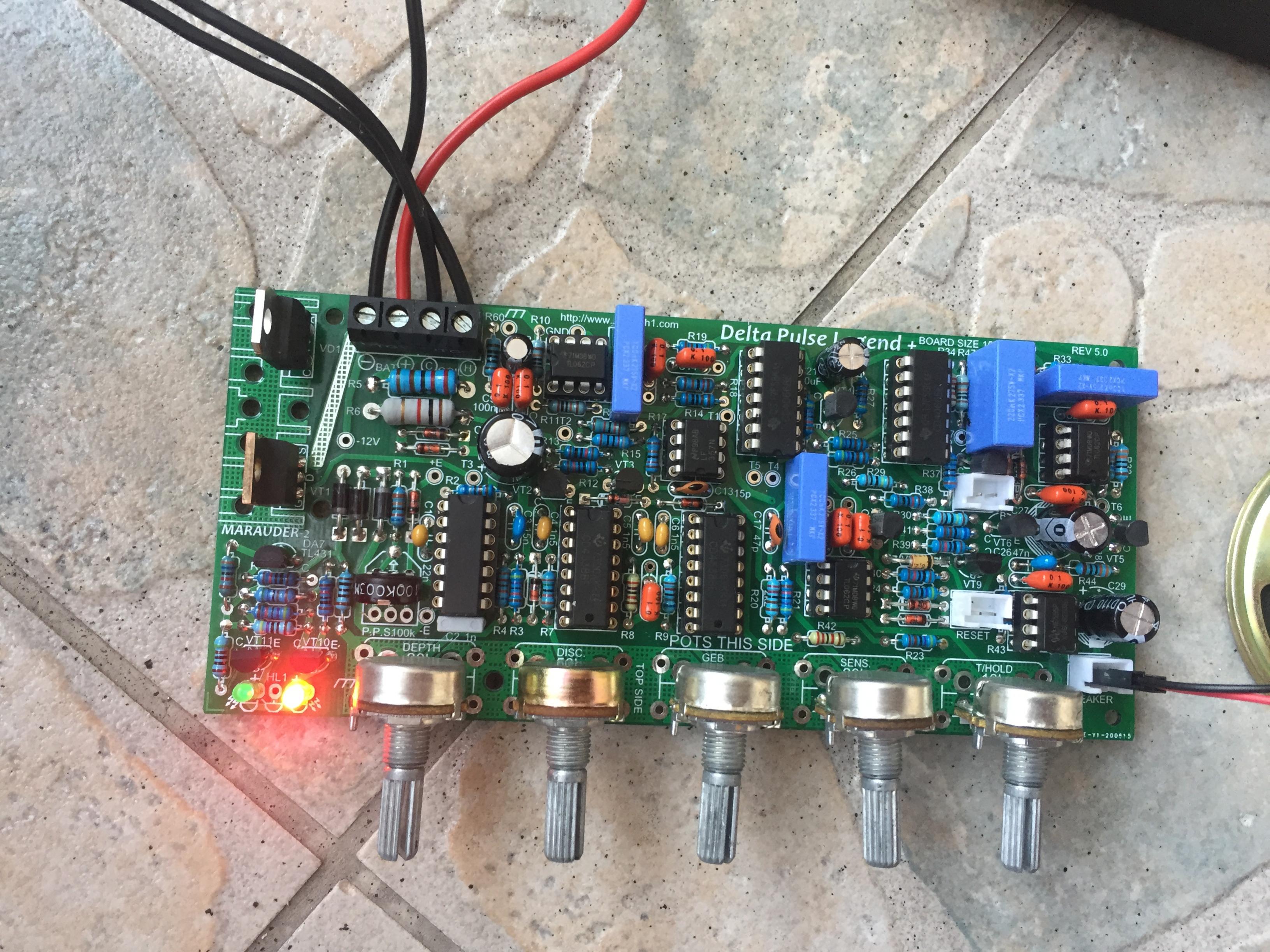

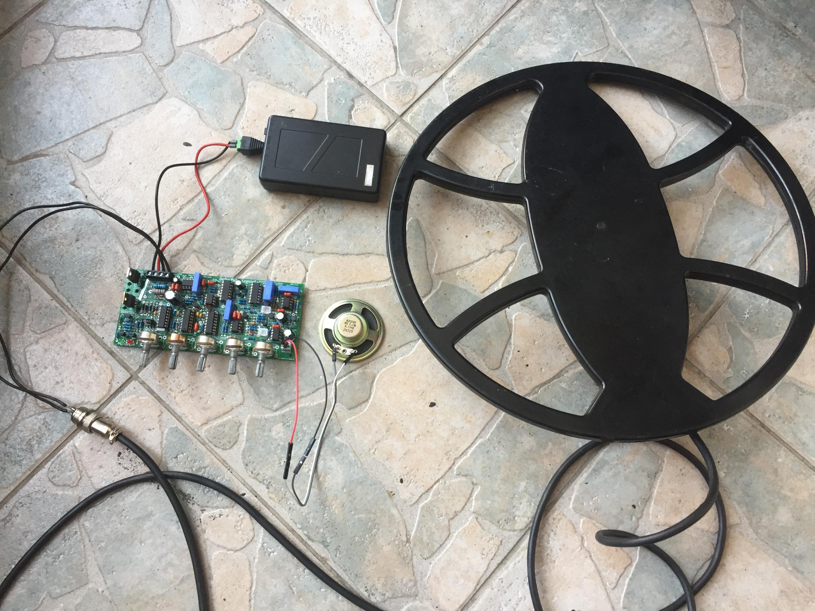

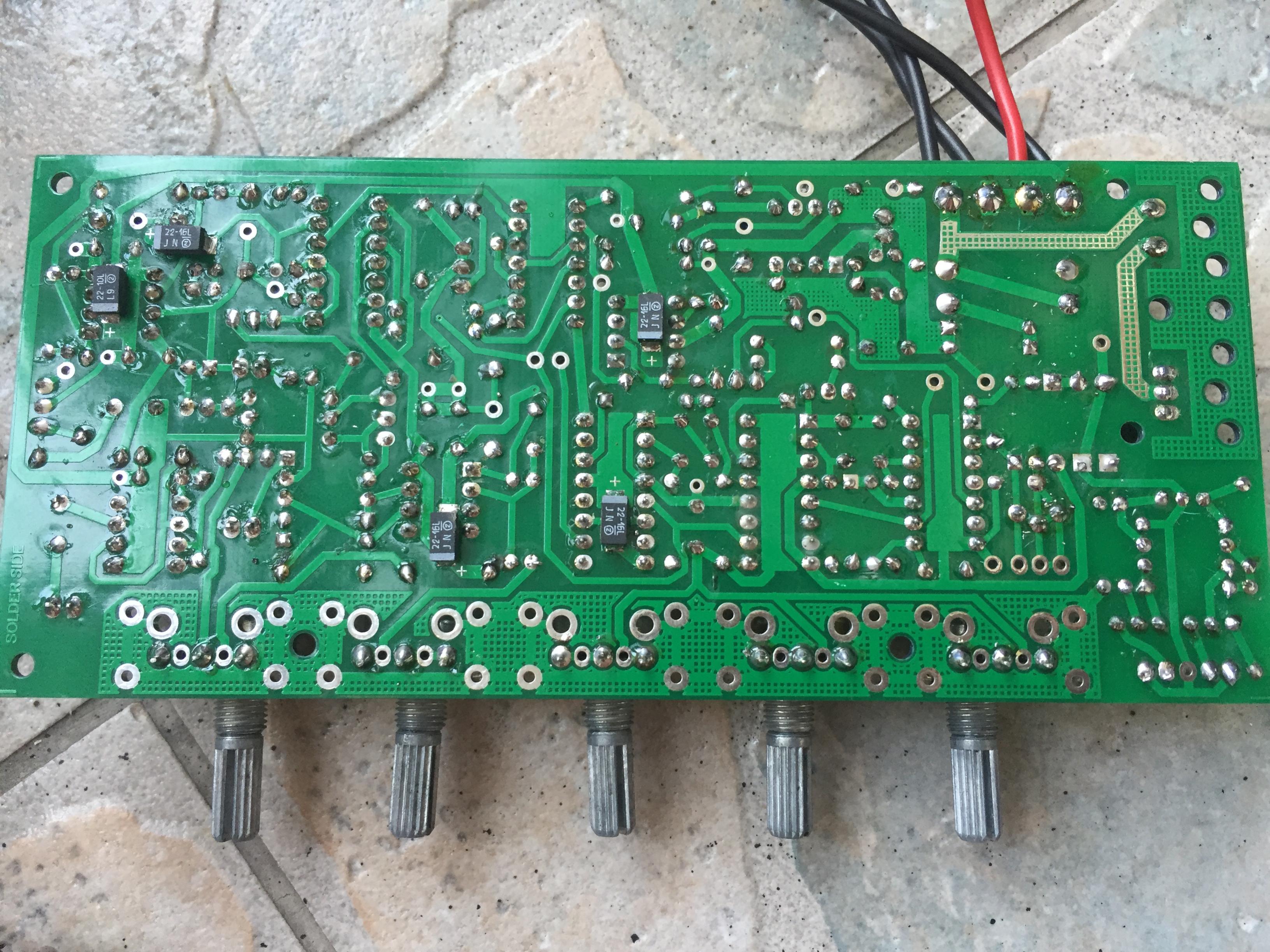

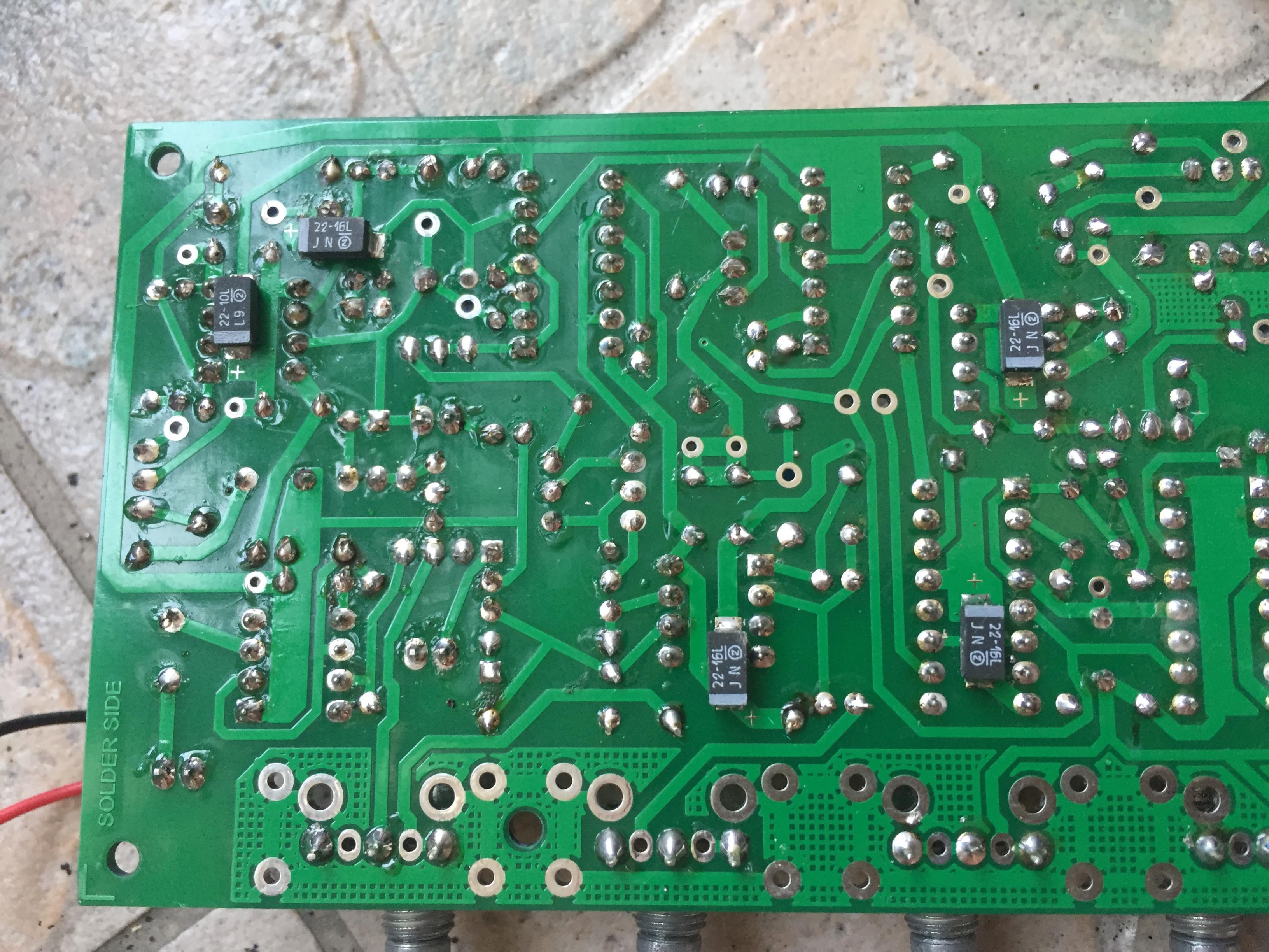

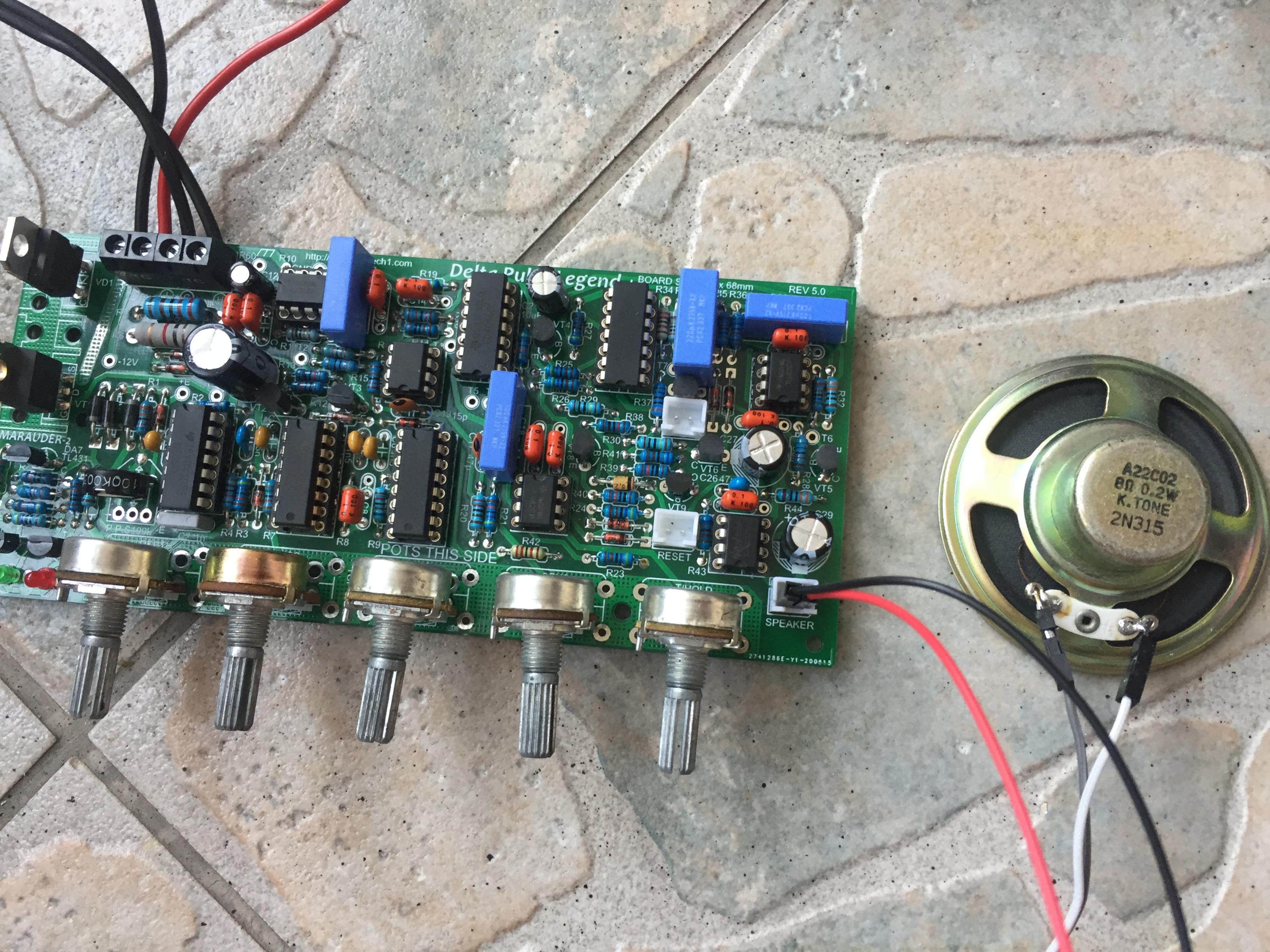

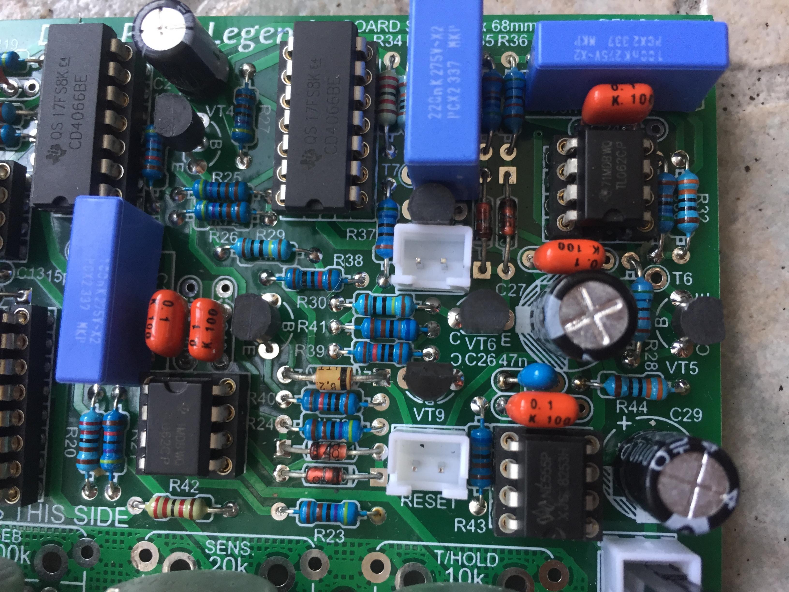

                            well what do you think???
                            • #44
                              measure voltage on input pins of power supply connector on board.
                              check NE555 in another device.
                              • #45
                                Now I checked the battery and it was 10,7 so I replace it with other battery and the lights are ok now I replace the 555 with new one and the device start working like a dream
