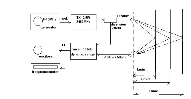

            So, now I show my experimentally diagram:
            When I change frequency of generator,I will found IF equally for all distances.This is the essence of experiment.
            Of course , this frequency can be calculate.
              Hi Seeker
              Ok, are you have practical experiment with
              This block diagram ?
                Yes, now I make experiments to find the best modulation frequency for all depths in working range.Because I have not SHF equipment , I can't choose the best carrier frequency, but I think it is not so big problem.
                  Hi Seeker
                  Please more explain about this diagram .
                  For example ,what if frequency produced when the material
                  Against antennas ?
                  What range of frequency read by frequency meter when distance
                  From the antennas make variable ? and …...

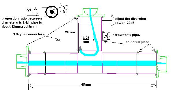

                    Second you mast find old satelite converter (LNB),inside have GaAs FET.Very carefully you mast to take out transistors. You need in 2 pieces.To make diversion module you need 3 connectors, cooper pipe, cooper rod(compact cable),T-form cooper element for freon lines(airconditioner).In fact another name of SHF is "water-conduit technics"
                    I send you picture of diversion module.

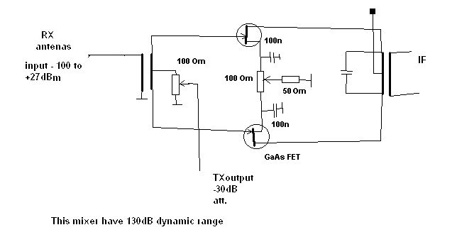

                      the most difficult module is mixer.There are a few parts , but mast make it very precision.After mixing the signal not exeed 10MHz .Find splitter from TVsat equipment for split of signal for two receivers, for 950-2150MHz . This will be box for insertion of mixer PCB.Some splitter parts will be in use.You can find splitter for cableTV, but parts inside are up to 900MHz.The PCB mast make on hand.When you have splitter i send you PCB right for your box.
                      This is the schematic of mixer:
