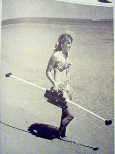

                Hello
                I would like to know if someone here as schematic of this coin locator.
                RegardsClick image for larger version

                • Interesting use of pvc. The ends are 2"x1" tees on about 3' of pipe leading to what looks to be threaded adapters on a 2" pipe mounted on top of a 3" pipe. The really funny part is that she is listening thru a stethoscope that seems to be coming out of the handle. Potential scam? Never have seen one like this. Could be a home made prototype.
                  • This is not coin locator, one coin is too small to be find with this unit.

                      Funky aparatus in the picture is most likley a gradiometer.A diferential proton precesion magnetometer.The black cilinders on the ends are the coils,since it has a big span betwen them,plus the waterproof housing and the girl is wearing a bikiney its for shipwrec hunting.

                        Hello
                        This photo is from old book "Buried & Sunken Treasure"1974.
                        This girl was hunting for coins along the tide line...And coins are not in iron.
                        Unfortunly i can see nobody have shematic of this device.Its a powerful two box for coin hunting,i think...
