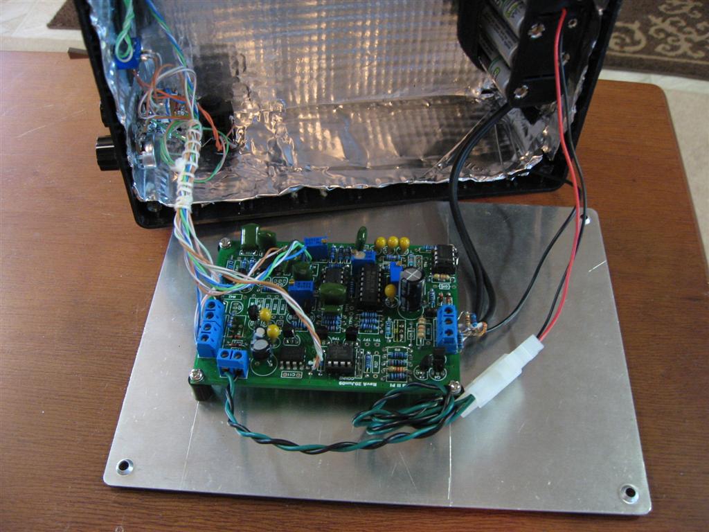

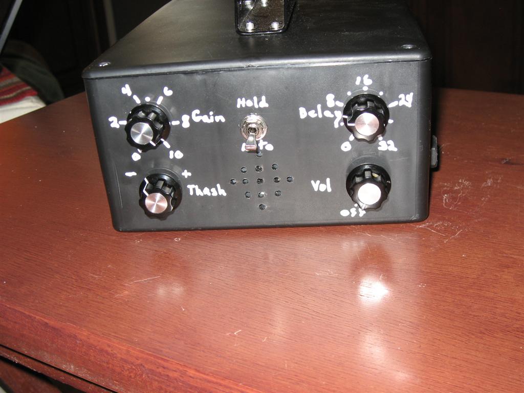

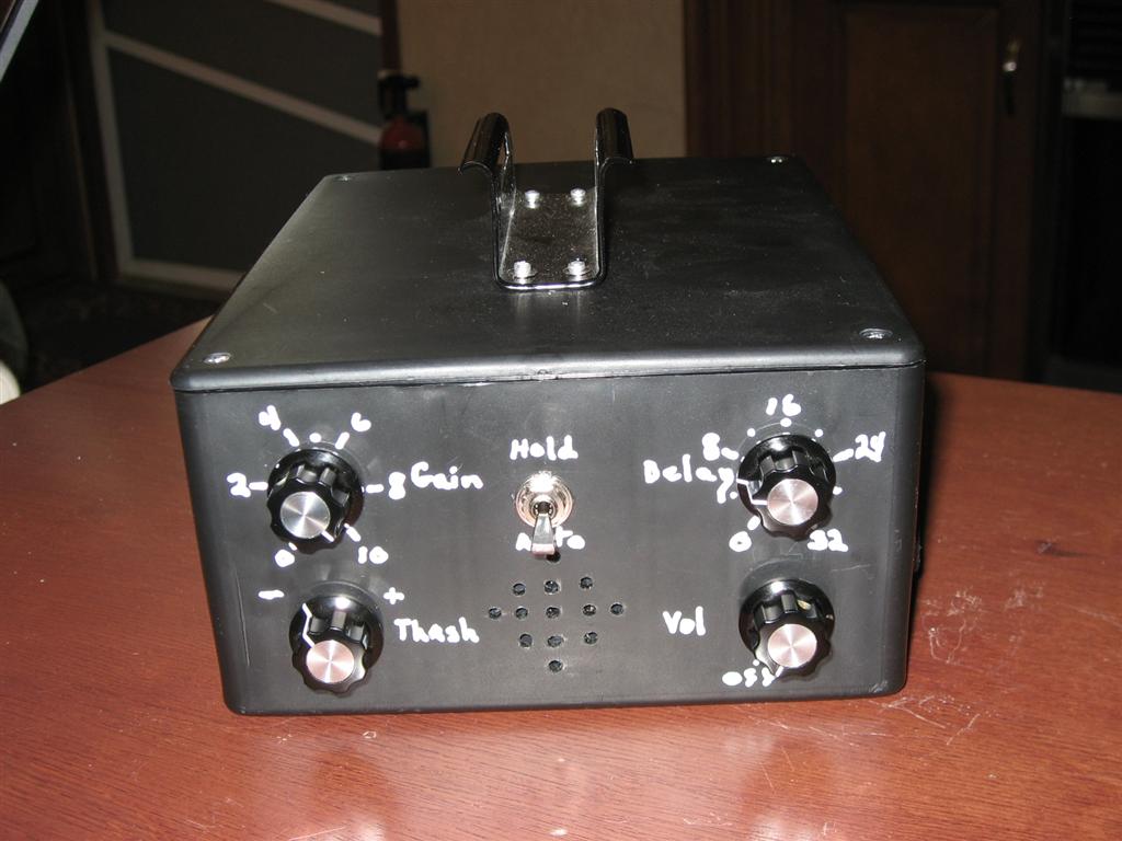

                    Finally got around to mounting the finished HH2 into it's housing! The only other change I made was to change out the FQPF2N60C MOSFET and replace it with a FQPF6N60C (higher current and lower Ron). Will post pictures when I get a reliable internet connection.
                      Finally got a reliable connection.
                        Very solid retro look. Congrat.
                        I cannot see front end discussed in other thread aplied here?
                        What purpose is inner shielding in first line against outer or against inner EMI?
