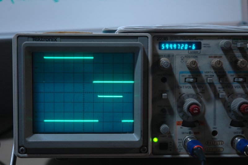

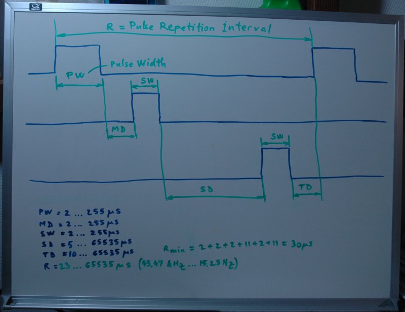

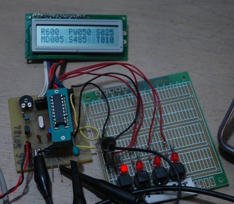

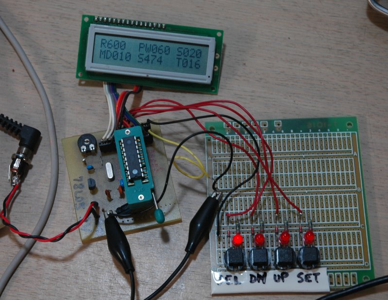

    I managed to write the code for a PIC16F628A running at 20MHz that can generate variable parameters for the pulses in Hammerhead circuits. I can adjust everything with a resolution of 1us. Pulse Width for coil is adjustable from 2us to 255us, the first sample can be taken after 2...255us, the two sample widths are adjustable from 2...255us. The Second Delay (SD) is adjustable between 5 to 65535 us and it is automatically adjusted when changing some parameters to keep Pulse Repetition Interval constant.
    The adjustments are made from four push-buttons and there is a self-repetition rate and variable incrementing in time (it increments in units, tens and hundreds). It also stores the set values to the EEPROM, so that they will automatically appear at startup.
    Here are some photos. I will build a board for it at some stage later, I am really curious how it will perform.

    Nice work
    good clean pulses,
    please keep us posted.

          Nice work. But i not see a schemat (circuit). If I am right in version hh2 all parameters is not adjustable. Which LCD You use? If is possible send for me full schemat and code (for C or assembler). 45 jears ago I was programmer in assembler, later in PLI, Delphi, Fortran etc. May be I can learn programming for PIC.

              I still need to implement some features in the code and test it on a real board. I don't have the schematics anymore, I will have to get it out from the actual circuit.
              Unfortunately, it will be some time until I will have the code ready. I had in mind to finish before Dec 2012, but until now I didn't even start the changes.
              My intention is not to release the code, but to sell the completed microcontroller for a small fee, perhaps even a PCB as well. But it's still too far from that stage.

                Here is PCB for my variant of LCD+pic16f88+3xpushbutton (for mode and adjusting).
                LCD 1602 or 20x02 with uart controller (ardujno, bought in eBay 12USD) for download click here PButton.zip
